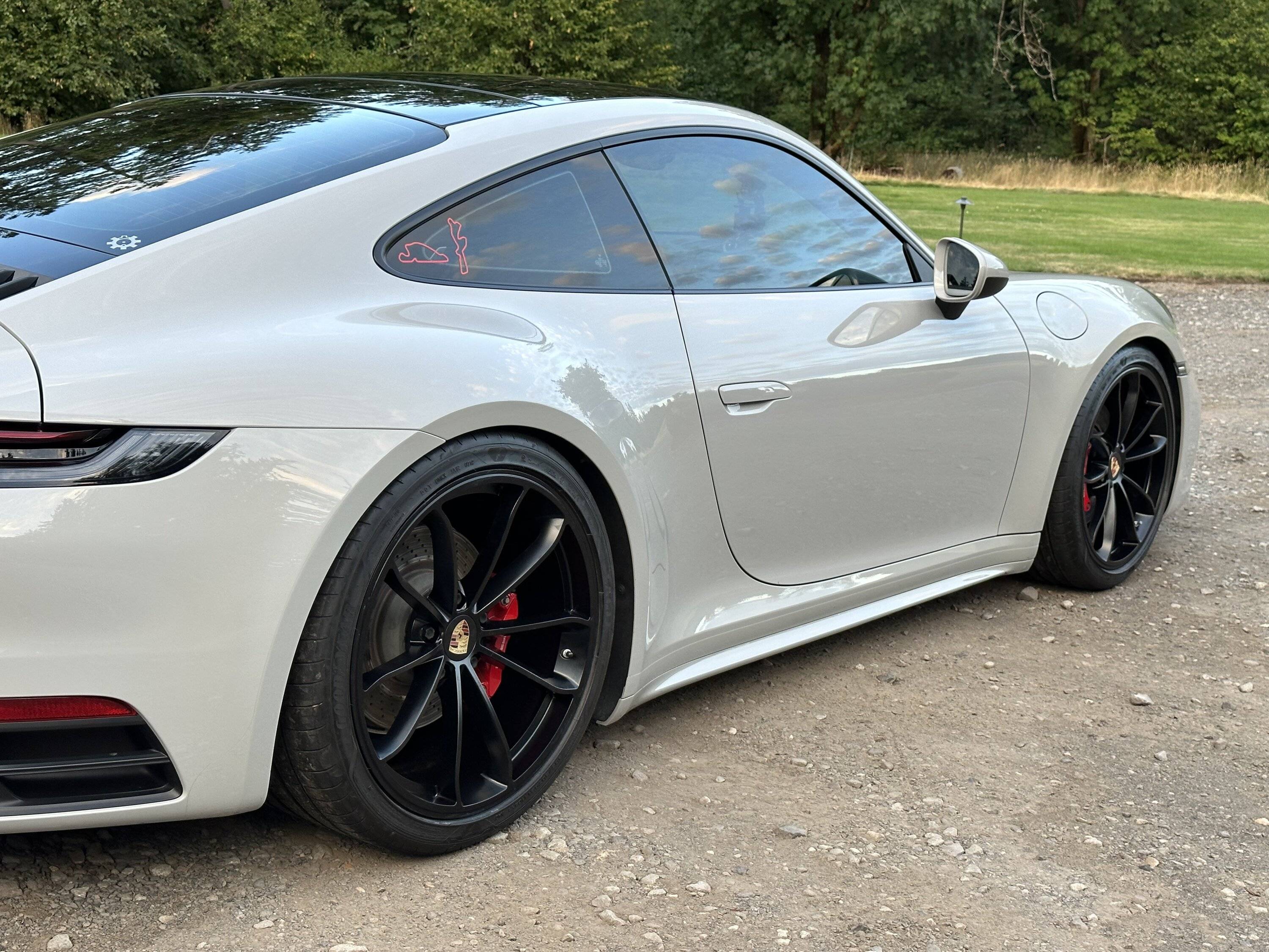

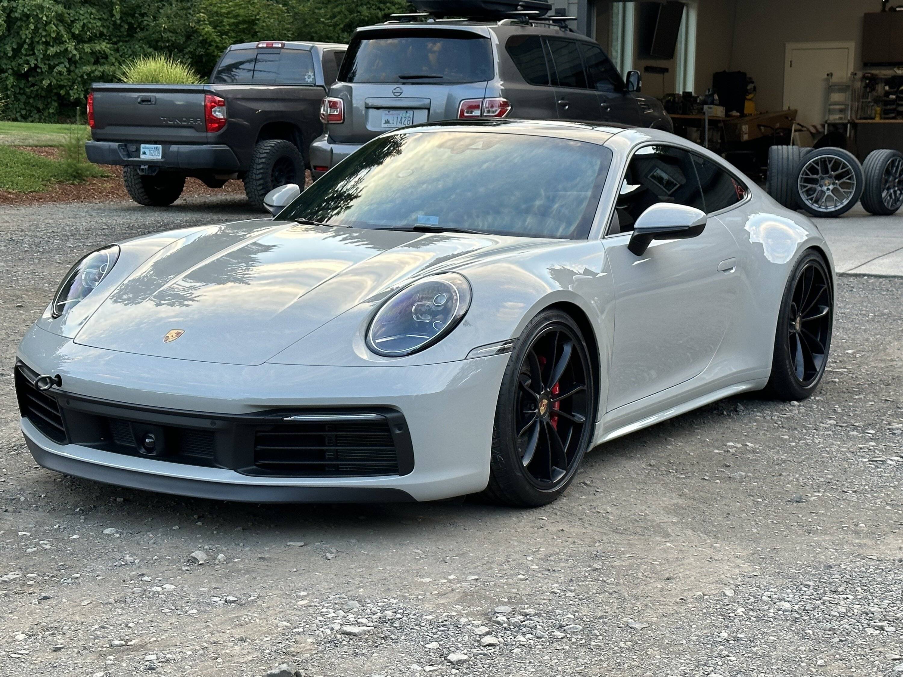

Lol, a few more - wheel swap. I had GT3 style wheels custom made (forged) for the 5 lug Carrera (normally they are center lock). They just delivered a few days ago and I slapped them on.

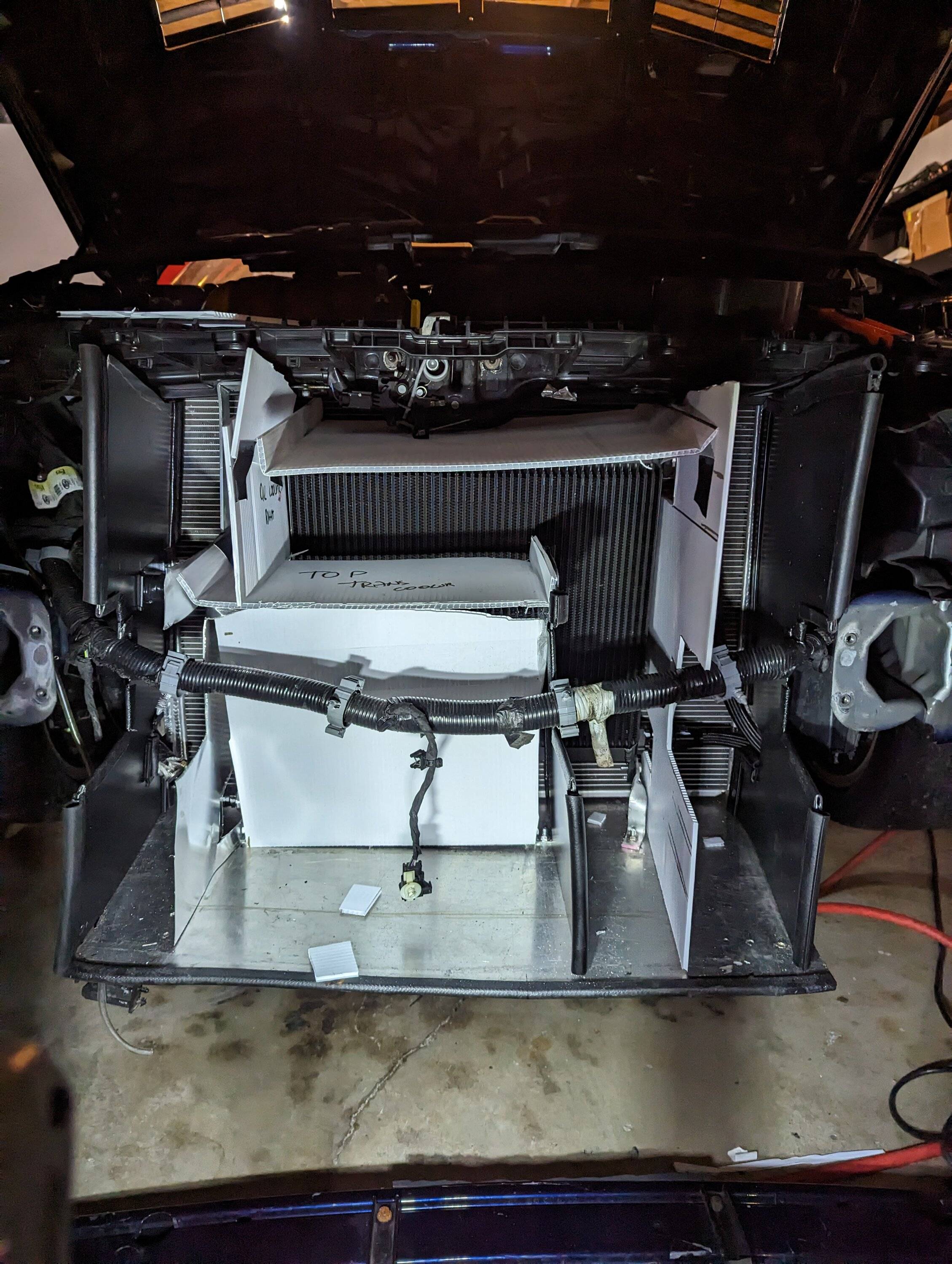

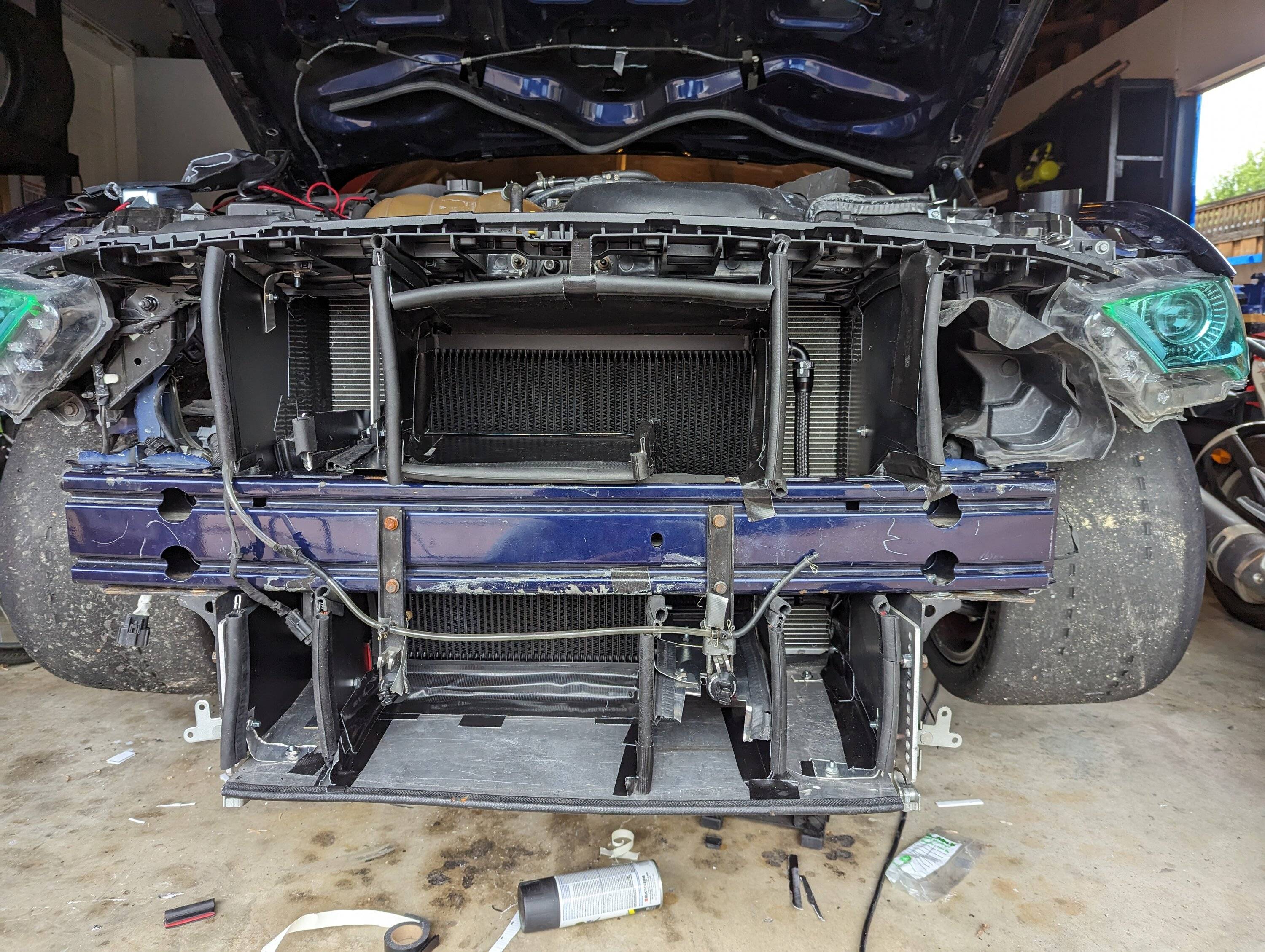

Okay this boxing, I've searched here but I don't see the "how to" info. I understand you're changing airflow to the radiator but by what means? I'm trying to enjoy track days and still drive the GT for fun on the street or trips. I don't want to modify the hood unless it's not noticeable. Do people change hoods for track season?

Boxing is by far the most effective cooling mod you can do.
And unfortunately there is not a easy solution. It is complicated. It is time consuming. The most important thing is boxing the main radiator. You want all the air passing through it. Otherwise air will exit around the radiator passing throught the gaps. Then you can box every cooler too. But i would start with 4 big alluminium sheet around.
To template..i use plastic corrugate
https://www.homedepot.com/p/Coropla...ted-Twinwall-Plastic-Sheet-COR-3672/202771364
But also cardboard can be use.
To put them together.. just bend the edges. Make L shape and rivet or bolt and nut together. And at the side towards radiator you put some trim.edges to avoid scratching the fins and also to seal it.
Is time consuming but absolutely doable.
(I never done this before and look for the pic)
Venting will help also a lot cause you create a lower pressure bhind radiator ..helping the airflow.
