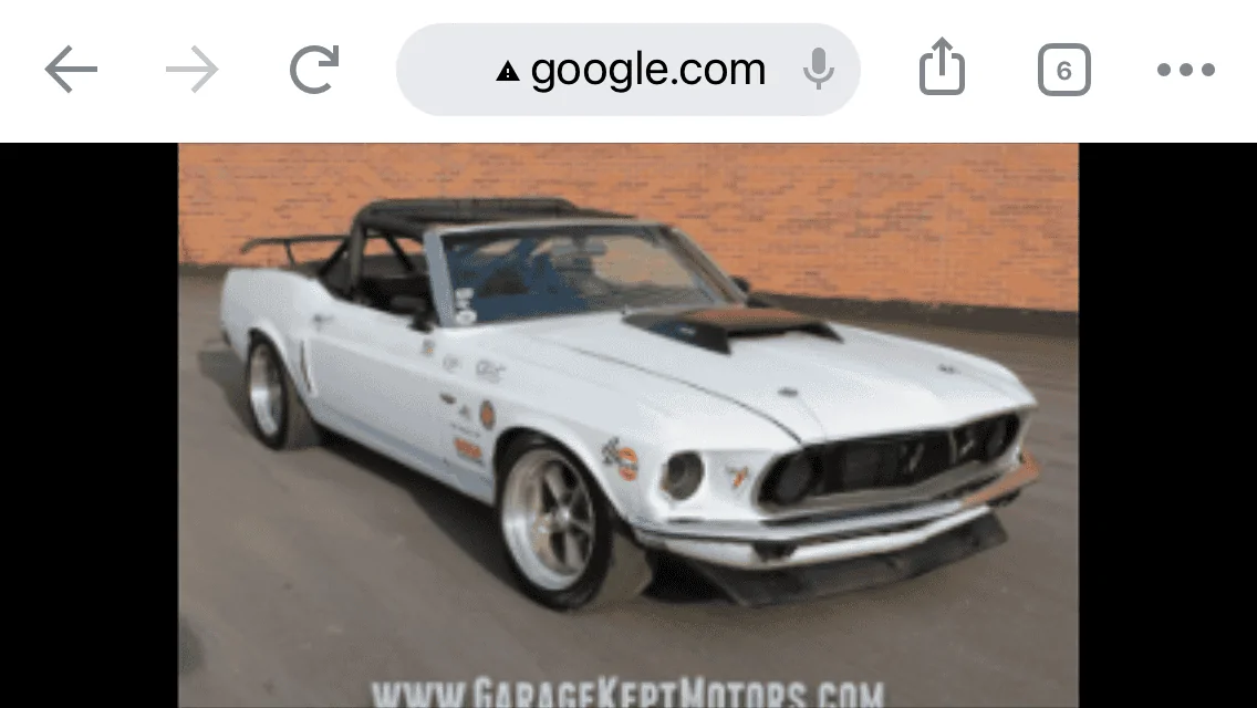

Don’t agree with that, I always had or have nice cars,jaguar, Porsche, Viper , etc, but I always had or have a Mustang. Love the style and the the “Americaness” of it
Both as street and track cars
The one below being my all time favorite. Started as a dd in the early 80 to a full out race car for many years

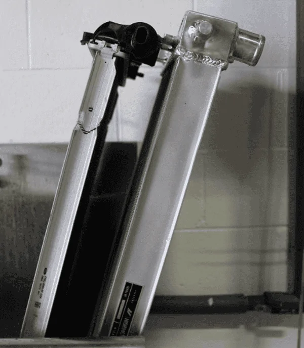

For those on this thread that track their cars 2-3 times a year, does the PP radiator make a big difference from the stock GT radiator? I am trying to decide between upgrading to the PP one or just sealing the current stock radiator.
The pp radiator (with procharger stage 2 kit) gave me 266F cylinder head temp warning on Sebring while outside was 93F.
So had to pull over and rest for 20 mins to cool down. then had to keep it on higher gear which made the car drive lame, slower.
I got a performance radiator from mishimoto.
they say this
  • 77-percent increase in coolant capacity over the stock performance package radiator
  • 26-percent increase in coolant surface area (tubes) over the stock performance package radiator
  • 55-percent increase in air surface area (fins) over the stock performance package radiator
So my steps
1- radiator upgrade
2- track and test
3- trackspec hood louvers install (engineers made sure the engine bay traps the heat lol)
4- track and test
5- oil cooler install
6- track and test

Forced induction cooling is a completely different game from a stock power motor cooling, ask me how I know 😁.
You need to add radiator area ducting to your list, without it you will not see any really significant change. I've done that plus steps 1-4 in your list with using even bigger radiator, and it's still not enough. Oil cooler goes in next. If you have AT transmission, your situation is even worse. 266F CHT is just crazy high, 235 is when cooldown lap should already be going.
