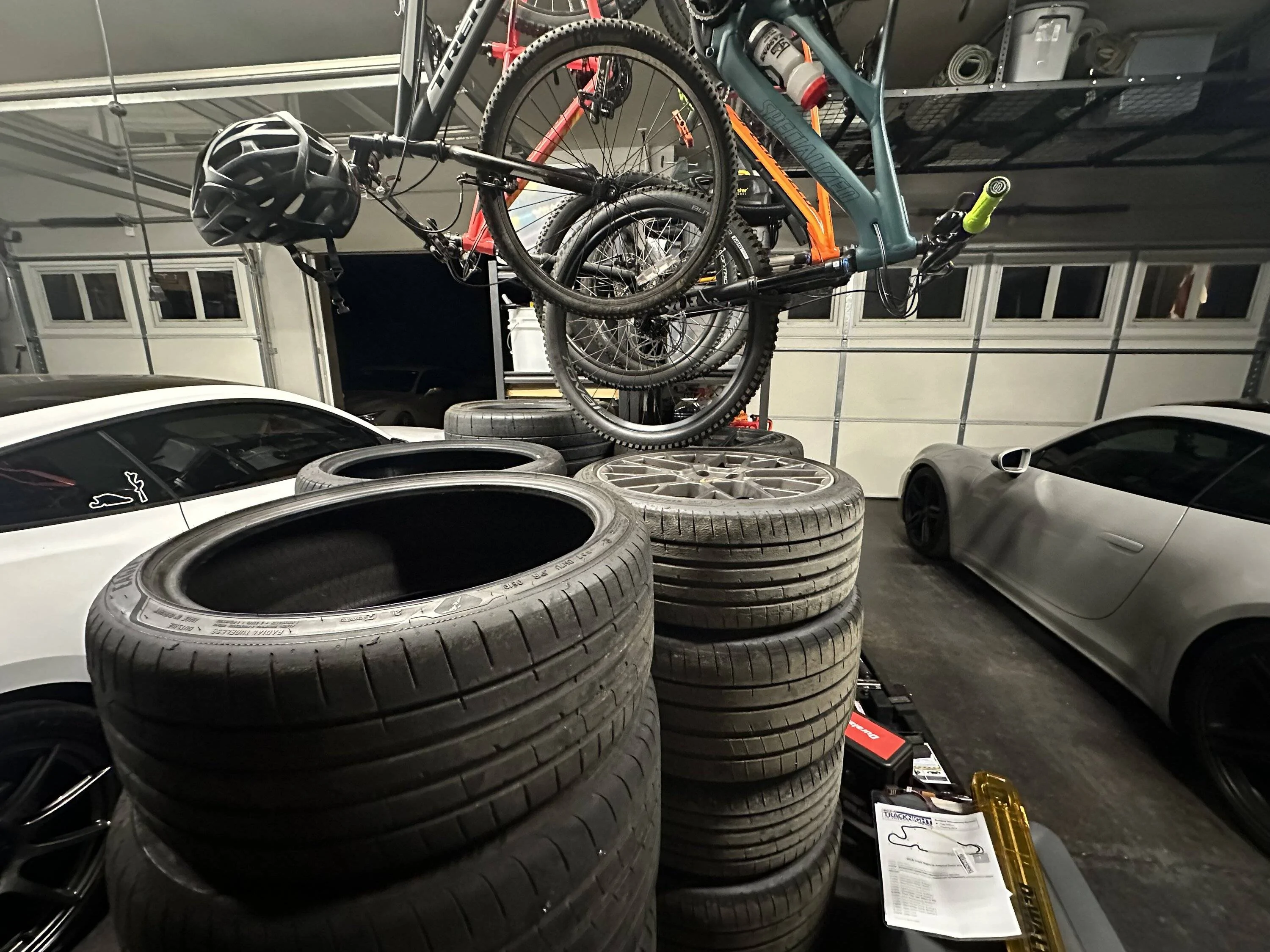

You are 100% correct, and I would highly recommend anyone tracking a Mustang to run as wide as possible. I ran 285 squared just to save cash on track tires. Which did help! Another reason for a Mach1 recommendation, you can go bigger! With the Mustang you can slap on MUCH wider front tires that really help, with the 911, you’re pretty constricted to a front 255/265MAX, and rear 315/325MAX….I can only go 255/315 with the 992 911S in stock form, so I’ll lose the battle to cars that can fit 265/325 (GT3RS).
My garage pic of tires.
The 285/35/19 GY SC3’s overtake my 911S GY Eagle F1’s by quite a bit, they’re in the back and about 3” taller than the other 4 sets of tires.
