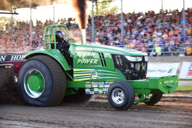

In a race Torque is worthless without horsepower. Tractors have hundreds of torque and about 5 horsepower. It don’t really matter how fast you can get to max speed if max speed is 10 miles per hour
Do you west coast guys even know what a tractor looks like ? LOL
Now this is my kinda tractor, it might not have a ground speed of over 20 mph but wheel speed is another thing. 3000+ HP @ 100++ psi boost. Torque what ?
Yep, torque is good! Audi won LeMans (more than once) with a diesel. JCB exceeded 350 MPH at Bonneville running two of their backhoe loader diesel engines.
