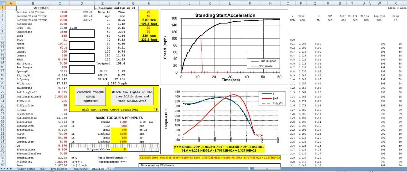

So what happened to all the "HP wins sales, Torque wins races" folks?
So Kawasaki ZX-14R 1.4L, Honda Integra Type R 1.8L VTEC, VW GTI 2.0L Turbo. I was astonished how close they came out with equivalent gearing. I expected the fat turbo torque band and bigger displacement to give a big win to the GTI.
Anyone notice the issue with the shift points?

Really shows how gearing can substitute for torque, and how well HP by itself can predict performance
Based on this I would predict that in the same vehicle -
In a drag race:
GTI motor wins, followed closely by the ZX-14R motor
On a road course or open road:
The ZX-14R motor wins, with a very close race between the GTI & Integra motor (Integra looks mostly faster in 4th & 5th gears, with GTI faster in the lower gears).
But a surprisingly close race all around (based on wildly different torque ratings, and engine sizes, and configurations). Of course on the street, cruising at 2000 rpm the engine with more power & torque at 2000 rpm (the GTI) wins (of course at 10,000 rpm, every engine but the ZX-14 has already blown up).

Did you specifically choose gearing for each vehicle to make them shift at the same road speeds, or was that just coincidental?
It's funny that on the GTI, you actually lose performance by shifting at redline. I have one, but haven't gone through this excercise (although I did do a similar comparison between the GT350, Z/28, and 350Z).

Equivalent gearing.
I started out with the stock gearing, but it's very hard for a motorcycle to get almost 200hp to the ground. So the ZX-14R gearing was drasticly different than the Integra Type R. Like 1st gear was taller than 2nd gear for the ITR. Even then they converged in the upper gears (3rd +), but wanted to remove the extra variable.
Or if you need 180hp to overcome the aero & rolling drag for a given speed, you gear the car to reach that speed no matter what the associated rpm is.
I am not sure what the redlines are, can only guess for the power curves. And most power curvers (like the ZX-14 & ITR) don't run the car to redline. But good job on picking up that the GTI curves should have used an earlier shift point (and vice versa for the ITR & ZX14).
