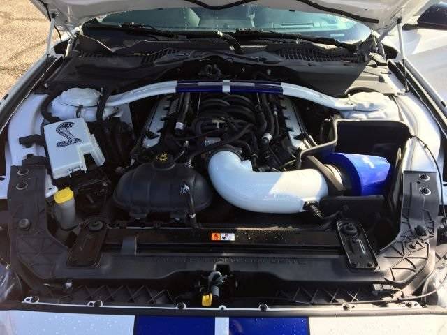

I am looking to purchase a GT350 and I will want to purchase a Ford extended warranty for peace of mind, especially if I purchase a car with a Gen 1 engine. I have already looked at a few cars, but they ended up having tunes which, based on my research, would preclude me from buying an extended warranty.
I called a Ford dealership about a car today and was told by the salesperson that no after-market parts had been put on the car when clearly the picture of the engine bay showed that not to be the case. I didn't even bother asking about a tune...

I think the CAI screams of a tune.
If it is being sold by a dealership, have them certify that the car has not been tuned and have them throw in a long term, high mileage bumper to bumper warranty.
and if applicable have them Certify and Guarantee it will pass all State Inspection and Emissions laws too.

I appreciate everyone's feedback. None of my "fun" cars over the years were modern enough where a tune was even possible. Also, I am not trying to sneak a tuned car past the warranty inspection, I just don't want to end up purchasing a car that would not qualify for a warranty because it has been tuned. I am going to have to be very careful...
It has been tuned if it has the JLT intake on it.

That’s a huge aftermarket CAI, which would probably require a tune. JLT does. Go look again and see what brand it is.
