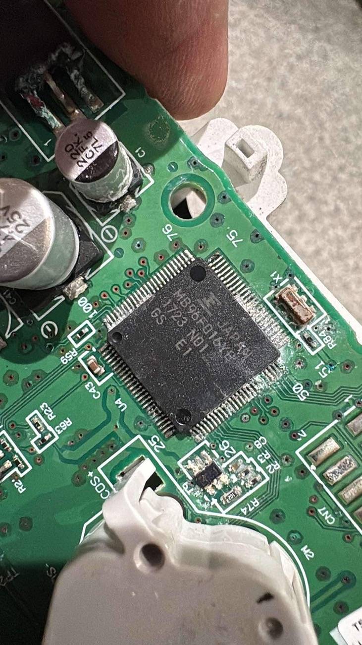

I did this conversion on my 2018 EcoBoost premium non-performance pack. Gauges are in. my color is working. the boost gauge is working. But the oil pressure gauge is not working. I enabled the oil pressure in forscan per the guide, but it's still not working. I also enabled the oil pressure gauge in my digital dash but that doesn't work either. Is there anything else I need to do to get the oil pressure gauge working?

These steps require cutting the middle vent hole to fit the gauge.
This method will only be applicable if you have the plug, no wire cutting or splicing.
How to find the plug?
1- The wire will be sitting/tucked behind the plastic that is behind the screen.
2- You will need to remove the bezel, and the screen to reach to the wire, check the videos below on how to reach to it. Just watch the removal part of the video to reach to the wire:
A) For base model (Small screen), first 10 minutes: CLICK HERE
B) For premium model (Big screen), first 10 minutes: CLICK HERE
Notes: (BASED ON MY RESEARCH, PLEASE CONFIRM):
1- Model (2015-2017):
A) Base model (Base cluster with no mycolor):
- i. Mycolor will not work, you can’t enable it using FORSCAN.
- ii. Oil pressure will need tune to let it work look at the picture below for tuning.
- iii. V6 mustang: Will need a tune and forscan IPC As-built programming (720-02-01: XXXX XXXX X7).
B) Premium model (Premium cluster with my color / Digital cluster / If you swapped your cluster):
- i. My color will work fine, enable it using FORSCAN if not enabled.
- ii. Oil pressure will need tune to let it work, look at the picture below for tuning.
2- Model (2018-2023):
- ii. Make sure oil pressure is enabled in FORSCAN.
You will need to buy:
- Performance pack gauge and bezel
Steps:
1- Reach the harness, watch the removal part only from these videos:
A) Model:
- i. Base model (Small screen), first 10 minutes: CLICK HERE
- ii. Premium model (Big screen), first 10 minutes: CLICK HERE
B) Pull the plug to the middle vent.
2- Cutting (The most annoying part):
A) Cut the areas in the image (Cutter will be useful).
*You will need to make a room for the gauge, the clips should go inside the two as shown in the picture. Also, you will need to make a room for the 2 vents.
*This is what it looks like inside of a performance pack dashboard:
B) Optional: Cover the middle vent.
3- Installing the dash:
A) Install the wire and install the dash.
Note:
MyColor will not work on daylight, only at night or in shaded area.
Good luck!
