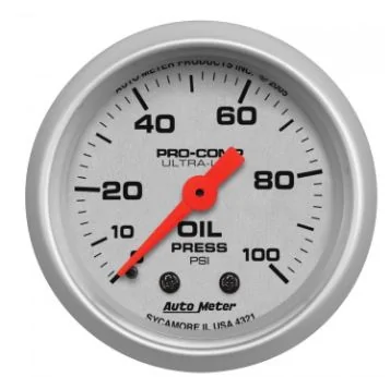

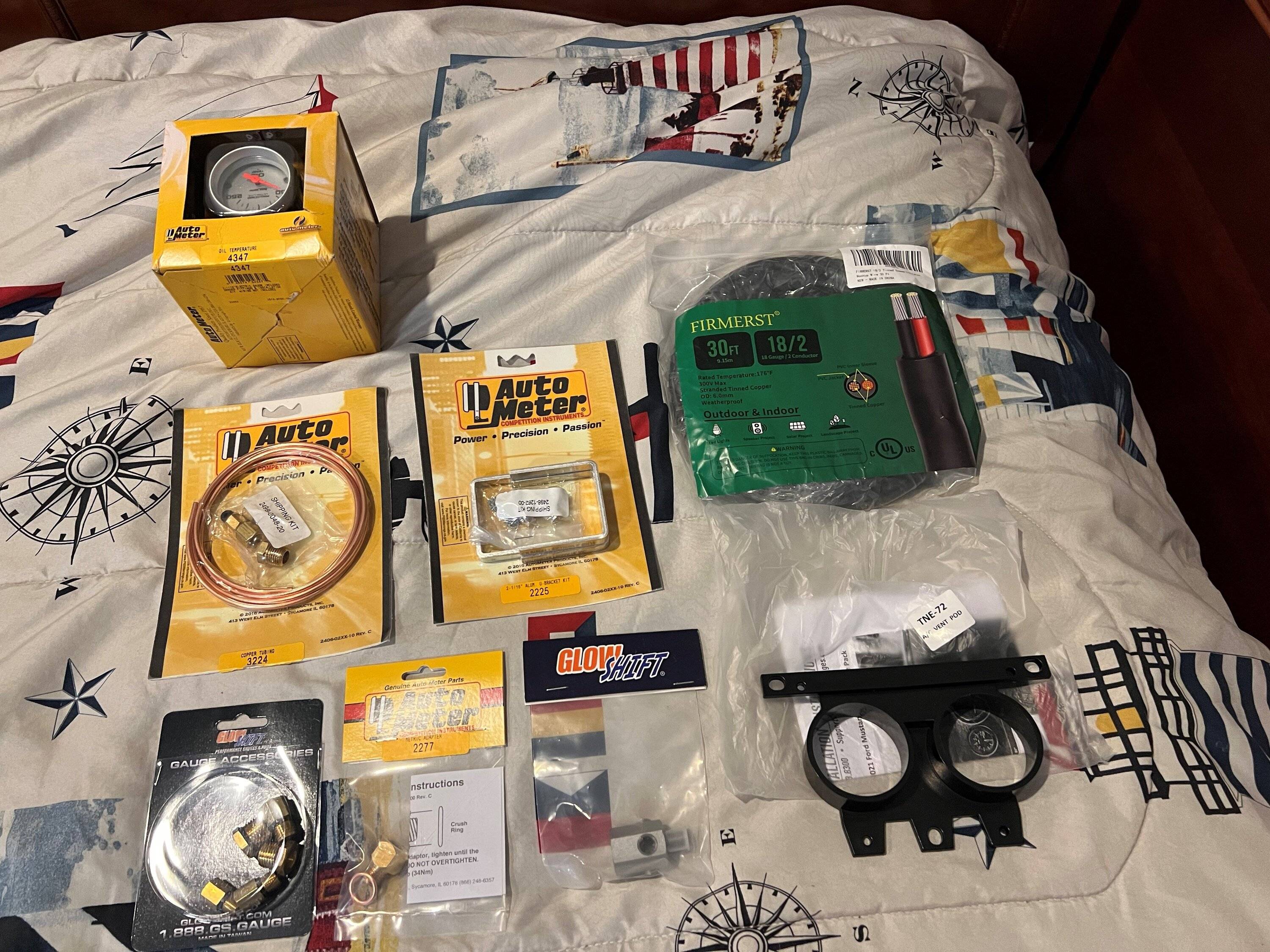

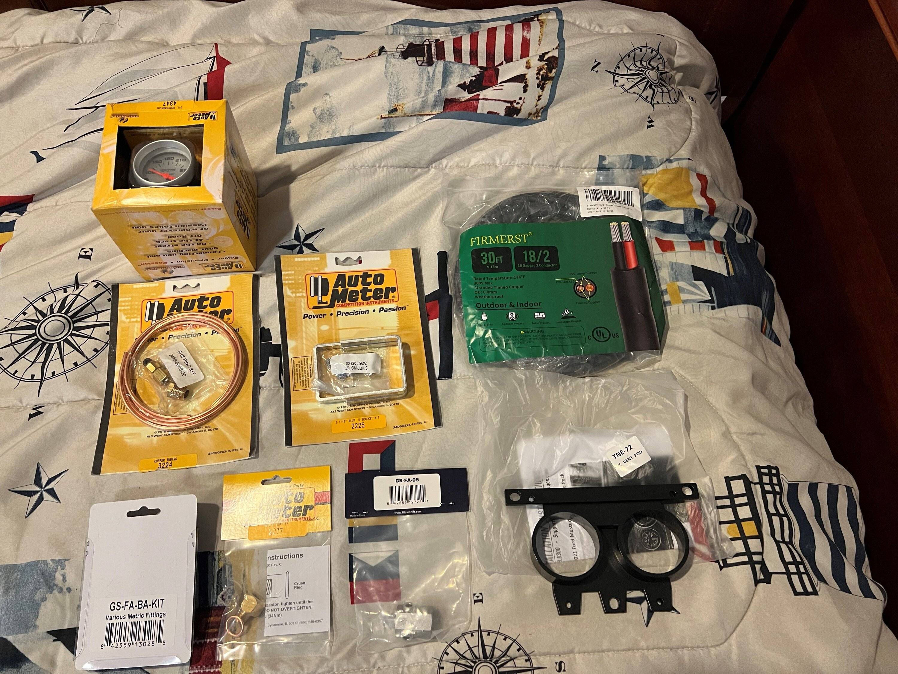

Here is my list of parts for the installation of aftermarket gauges:
  • Autometer 4321 oil pressure gauge
  • Autometer 4347 oil temperature gauge
  • Autometer 3224 oil line kit
  • Autometer 2225 gauge clamp kit
  • Autometer 2277 metric adapter
  • Glowshift GS-FA-OS multi-port adapter
  • Glowshift TNE-72 gauge pod for center dash
  • Glowshift GS-FA-BA-Kit misc. fittings
  • Insulated 18/2 wire for the oil temperature sender (Amazon)
