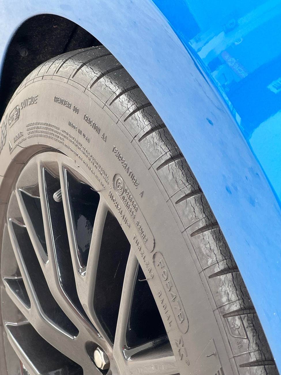

True, and I guess it's particularly exacerbated on soft summer/high performance tires. My Jeep sits outside perpetually and I had some Cooper tires go 6 years on that and still look healthy (other than patch jobs, sidewall gash from trails, etc.)
Florida.
Heat and humidity can be very punishing on tires. Several storage articles I've read, from Michelin and others, highlight how conditions seen in FL and similar climates can be some of the most challenging to maintain the integrity of the compounds over time, especially if at rest.
I understand the car is garage kept, but the intensity of the UV exposure in FL and states in the same latitude is an additional factor.
And at six years, it's time to replace the tires anyway. Tire compounds naturally degrade no matter how kept. Maybe not to the physical extent yours have, but the performance of those materials becomes less and less effective over time.
Given the physical crackling of the tread, age and location, seems like a good time for a new set.

My 19GT has ~17.8kmi and I have the original Pilot Sport 4S, the tread still looks fine but they all look like this...
Garage kept too.
Mine on my 2019 GT PP are starting to look like that too. 5000 miles on them. Contis are in my future lol.

I was going to keep quiet and just see what responses you got, but mine are the same ...
Treat the sidewalls with something, let it really soak in, wipe it off, then go for a spirited drive.
You will probably find (like mine) that the sidewalls are covered in very small cracks (like crazy paving), and the first indication I got that it had started, was the dark wet spots where the dressing leached back out.
Similar age, similar mileage, and yes, Conti's are in my (very) near future ... :like: I even bought new wheels to go with them ... :giggle: (I had always wanted rid of the PP1 wheels, but didn't want to swap out the tyres unnecessarily).

Yeah they are definitely done. I am planning to get SVE DHP1 forged wheels and tires from LMR, just wanted to pay my car off first (1 payment left!) but I'd be joking if I said seeing the price of Indy 500 tires being almost double what they were when I bought them in 2018 for my old CF5Vs on my 2018GT (RIP) isn't a little insane. I refuse to waste money on new tires for the PP wheels, I absolutely despise them.

Goodyear Engineering guys that came to national events told us years ago, that small hair checking on the side wall of their drag race tires
(fronts primarily, cuz the rears never even stay on car long enough to do it)
is just to hold the lettering on the tires, & is irrelevant to its integrity. Even the NHRA & IHRA tech guys wouldn't bounce you for that look on a sidewall.
Nobody pushed it to far though, & usually had new Front Runners put on at the Goodyear semi, (but were angling for a free replacement set, as many felt they were defective - & yeah.... professional race teams are often some of the cheapest phvcks around)
This would come up quite often because those tires would often 'check' (hair line cracks) in less than 2/3s of a racing season, & guys felt they were not getting their money's worth, & complained.
I don't have a dog in this one... just repeating what the GY guys who design these tires told us... they clearly didn't want to warranty them, either.
