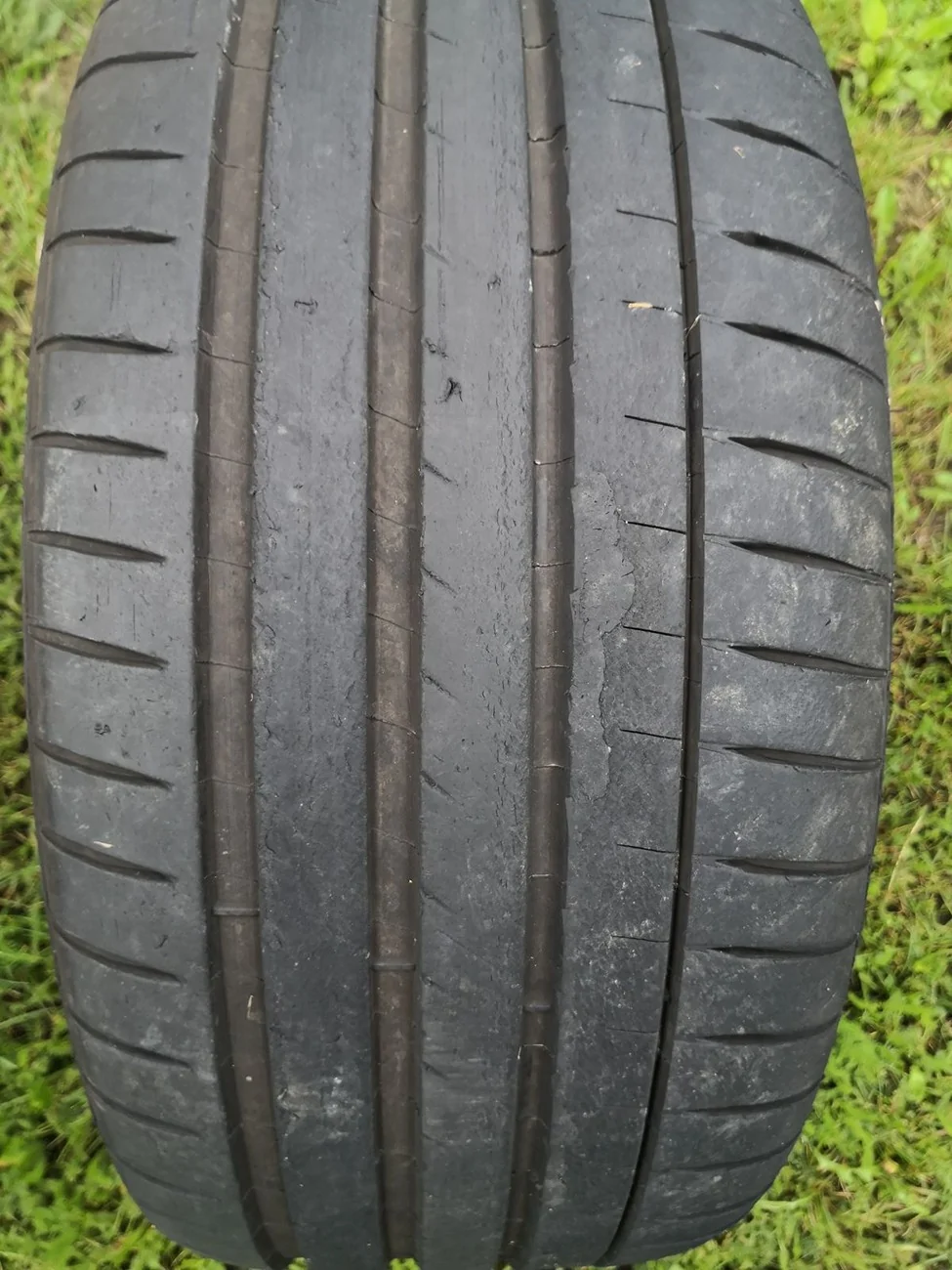

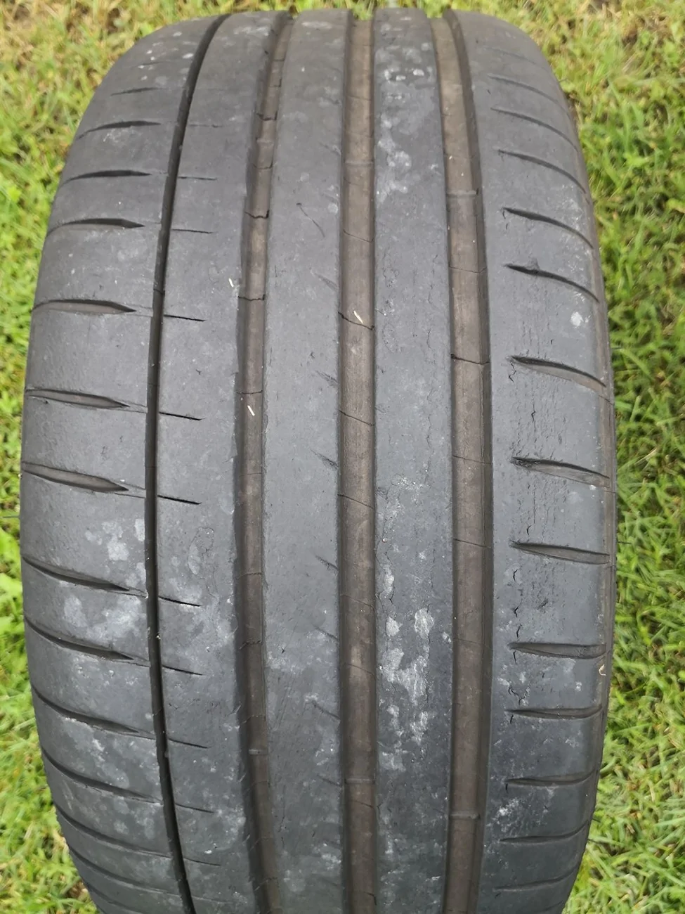

Is it possible to tell the wear from the way the grooves are visible (or not) on the tyre? This is the front MPS4S (255/40) after cca 10k mi (and few track sessions).
I am not the worried about the tread depth, but the one part of the profile - the section which is not in the middle not on the side and is separated by the bigger grooves (and has no visible grooves) has a delicate texture to the touch. I am not sure if it is the just the material, or some lower layer starting to protrude. Nothing is visible though, only felt.
I am not the worried about the thread height, but the one part of the profile - the section which is not in the middle not on the side and is separated by the bigger grooves (and has no visible grooves) has a delicate texture to the touch. I am not sure if it is the just the material, or some lower layer starting to protrude. Nothing is visible though, only felt.
A Tire tread depth gauge is dirt cheap and eliminates guessing. Can be found a reputable automotive stores for a buck or two. Maybe on Amazon. Also the age of the tire can be deduced by a date code on the side of the tire. Those two pieces of info are all you need to determine whether or not to replace from a tire condition point of view. Ride quality, handling, road noise those are all based on experience or information from known trusted sources. Like here. Those tires look new compared to what I replaced. Mine were 3 summer seasons old.

How's the alignment and tire pressure on the front Muric? Could that be an issue? I don't have any experience with those tires so not sure how they should wear.

What is the road surface? Black top, cobble stones, concreate, those tires look as though they have been running on cobble stones. While I was in Germany my tire had that same appearance and most of the road surfaces were cobble stones.
The tread depth is about 1/4" (measured by calipers). I agree that by the depth I am not worried. I was more interested in knowing if some "inherent" features of the rubber profile could be used to determine the wear. Plus the strange tactile feeling along the mid inner patch.
There are no signs of an uneven wear along the whole patch. The alignment was fine every time I checked (the last time was before this season).
Road surfaces here (Czech Rep.) are similar to those in Germany (or France) as far as I know albeit with worse maintenance or repair. But nothing exceptionally different.
I suspect that the strange feeling is probably due to a different composition of this particular patch and/or recent track session.
