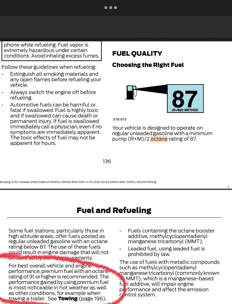

Read the Owner's Manual. Note that it recommends 87 octane for the 5.0. That's what it's designed to run on in stock tune under all weather conditions. It won't run better or make any additional power on gas with more knock resistance. It doesn't work that way. Don't throw away your money on a myth. (None of this applies to a modified and/or tuned engine, which may well require 91 or 83 octane. I am talking a stock 5.0.)
Sorry Dave, but we have addressed this numerous times on here and you are incorrect. 87 is not recommended, it is the minimum required. 92 is recommended and our horsepower ratings are based on it.
Regardless, use what you want and/or what works best in your car. But posting incorrect information doesn’t help anyone.
i feel like this should be a sticky or something at this point. bottom line. stock car with stock tune will be just fine on 87. ive run more 87 than anything else. did not notice a difference with 93. only difference i notice is when i run E85.
