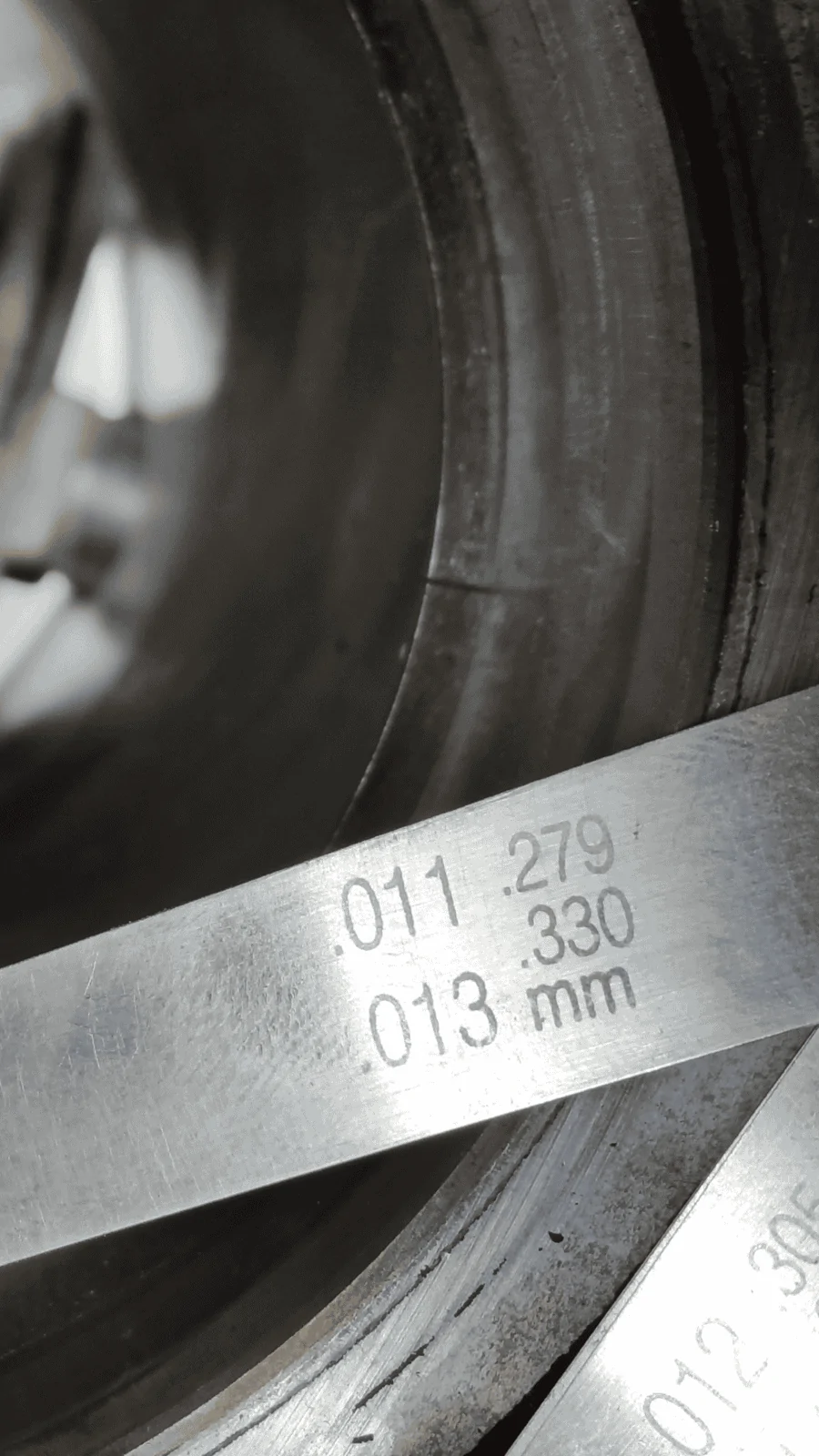

Thought I'd add this to the thread... I pulled the rings off piston #8 tonight and pushed them into the cyl. (This is from my failed short block, which broke the ring lands on cyl 7 & 8)
top ring = 0.011 (factory specs .015-.025)
2nd ring = 0.031 (factory specs .030-.055)

The last engine I built was 36 years ago. I hand filed the ring gaps. I clearly remember having fairly visible ring gaps when the pistons were installed. I cannot imagine any ring gaps that tight. Maybe this is an issue from the factory?
Here is a great article explaining the engine failure from improper ring gap:
http://blog.wiseco.com/everything-you-need-to-know-about-ring-gap

Crackerjack, thanks for checking and posting that. I’m confused about the spec though.
https://performanceparts.ford.com/download/instructionsheets/FordInstShtM-6007-A50SC.pdf
This shows the top ring gap spec to be .15-.25 mm which is .006-.010. This seem erroneously small. I would expect more like your numbers. Where did you get your spec from?
Hmmm. Same sheet as you. When I get home, I'll measure the feeler gauge with my micrometer. But that feeler gauge is the one that fits perfect in the top ring gap. I'll check cyl 7 too.

Can you check all of them?
I could but, maybe over the weekend. I only have cylinder 7&8 out. the shortblock is sitting on a moving dolly on the floor. I never removed the other pistons because when I compression checked them they were ok.
