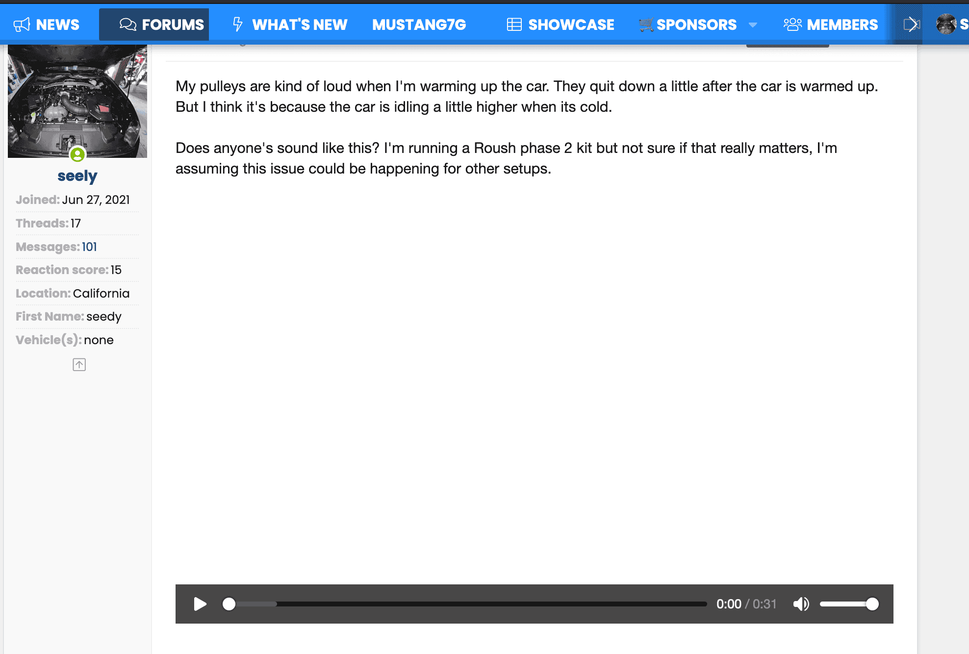

My pulleys have a loud high pitched ringing sound when I'm warming up the car.
They quit down a little after the car is warmed up. But I think it's just because the car is idling a little higher when its cold.
Does anyone else have this sound? I'm running a Roush phase 2 kit but probably shouldnt matters, I'm assuming this issue could be happening for other setups.

The video is broken for me, not sure if others seem the same. The audio seems to work which is all that matters.
