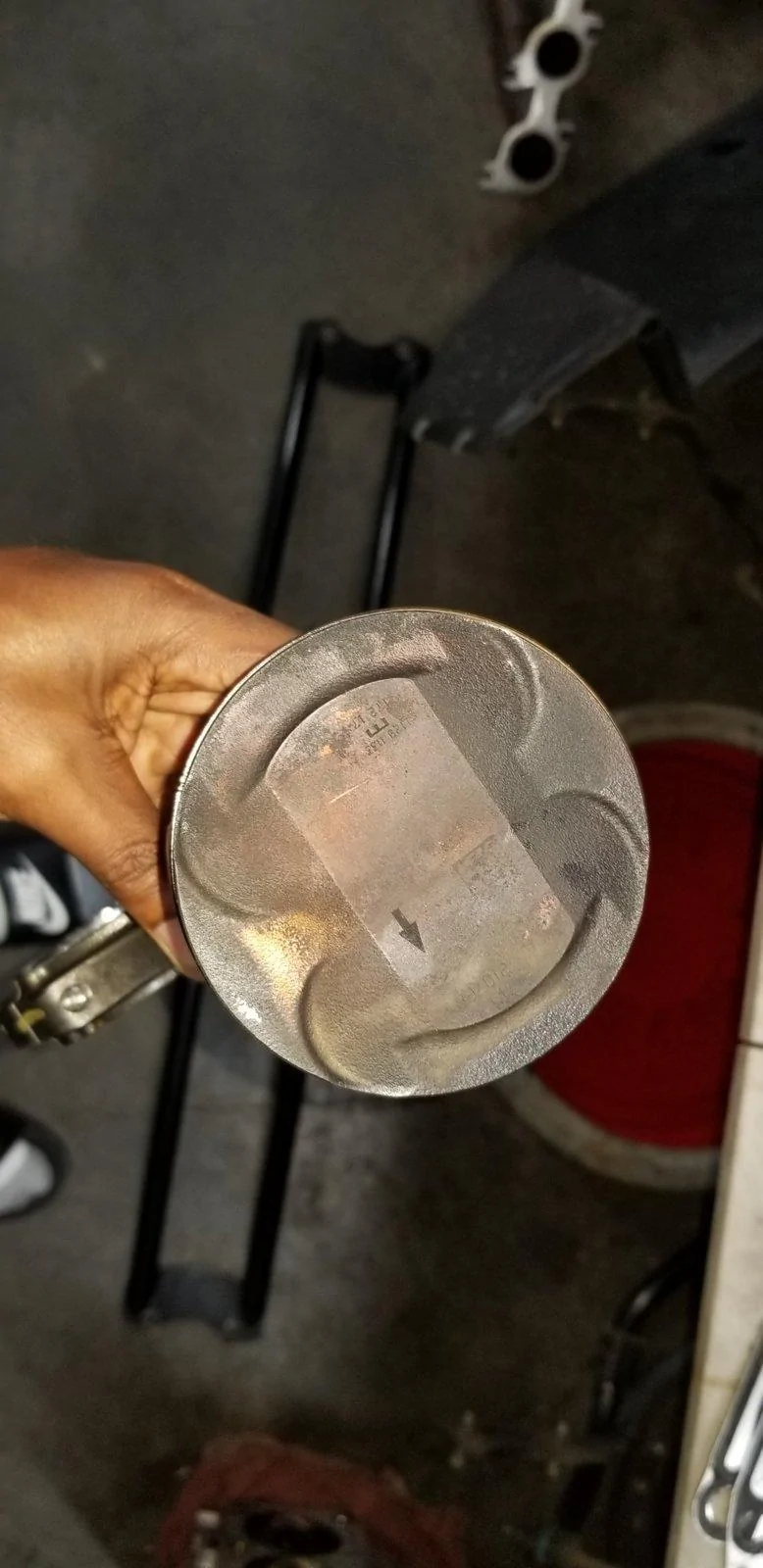

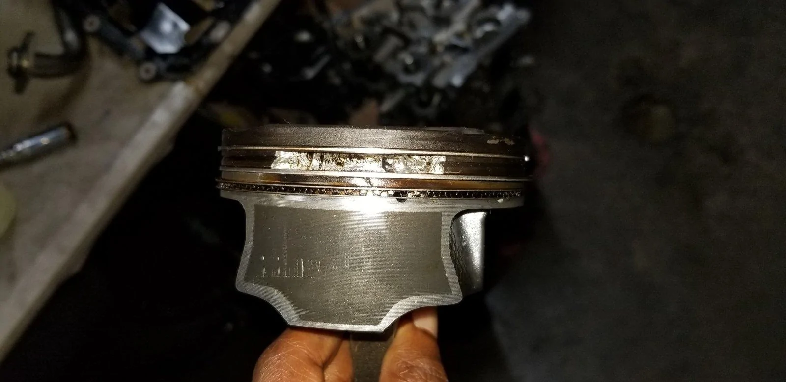

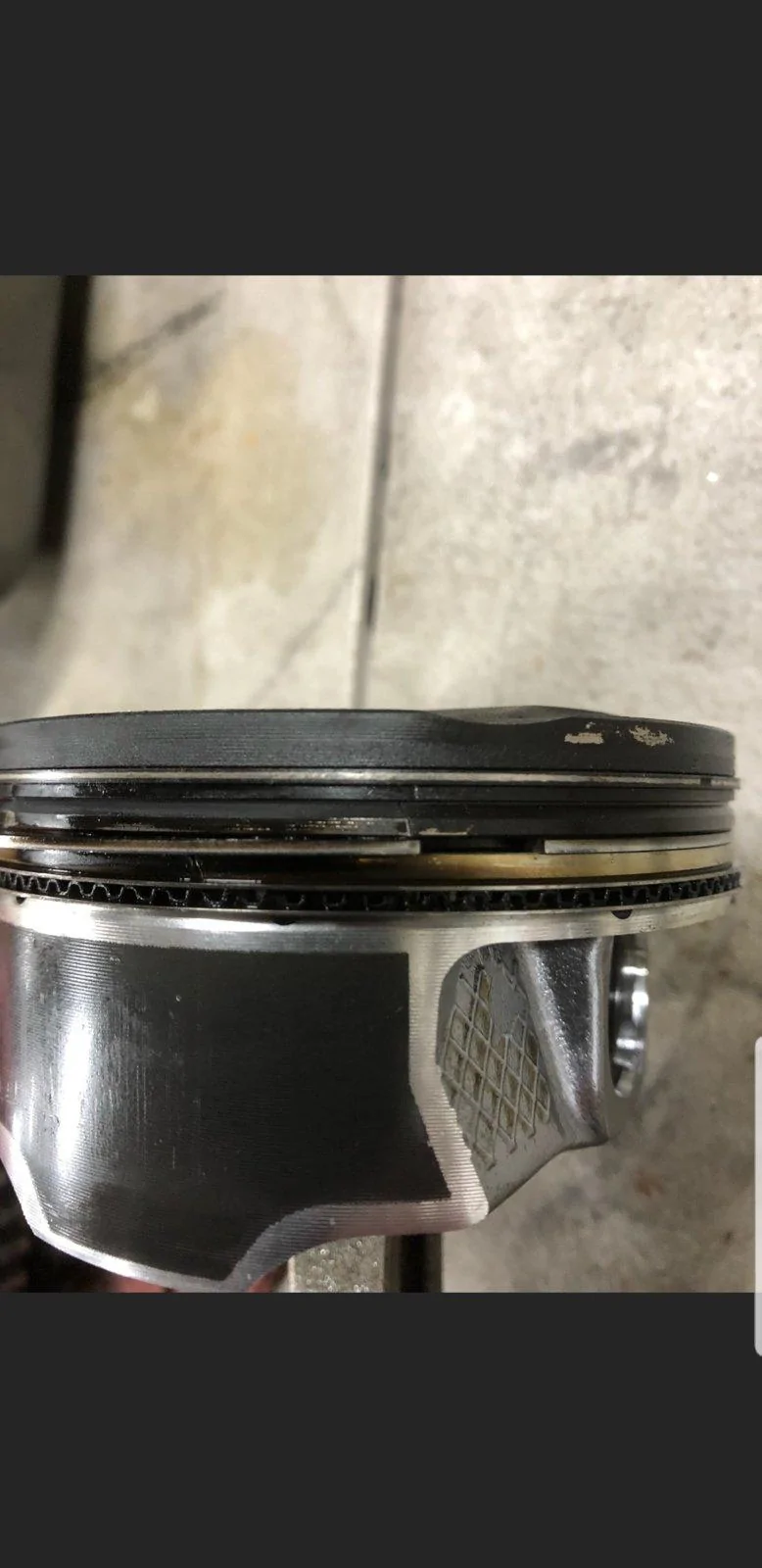

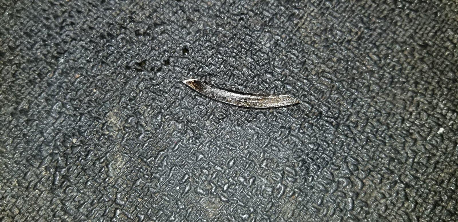

Misfire code cylinder 8 code again low compression. They pulled the pistion out this time and found a crack in the pistion ring. After picking at the ring it came apart. How does this keep happening? Last time I had cats on the car and I had a misfire code but we never took the pistion out to see the damage. We noticed the cat was clogged and came to the conclusion that the cat got clogged and damaged the pistion so I bought a brand new shortblock, but now I have no cats, brand new short block in for two months and I ran into the same issue. Car still runs good no smoke, no hiccup, no misfire symptoms besides a check engine light. What do you guys think is the problem? Is it tune related.

I'd say it's from detonation, Did you clean the piston or was it that clean when you took it out? What does the plug look like, any oil in the intake around #8 runner?

Likely, a tune issue. To much timing. To lean.
A rungland issue is almost always heat from something. Being cyl 8 points to that even more.

Only running 10.5 lbs of boost. Yeah he cleaned off the pistion. He said there was no sign of detonation.

A) your failed engine killed your cats
B) not much kills ringlands besides detonation

was the new short block a standard short block ? a previous posting said that the standard N/A ring gap can be too tight.
