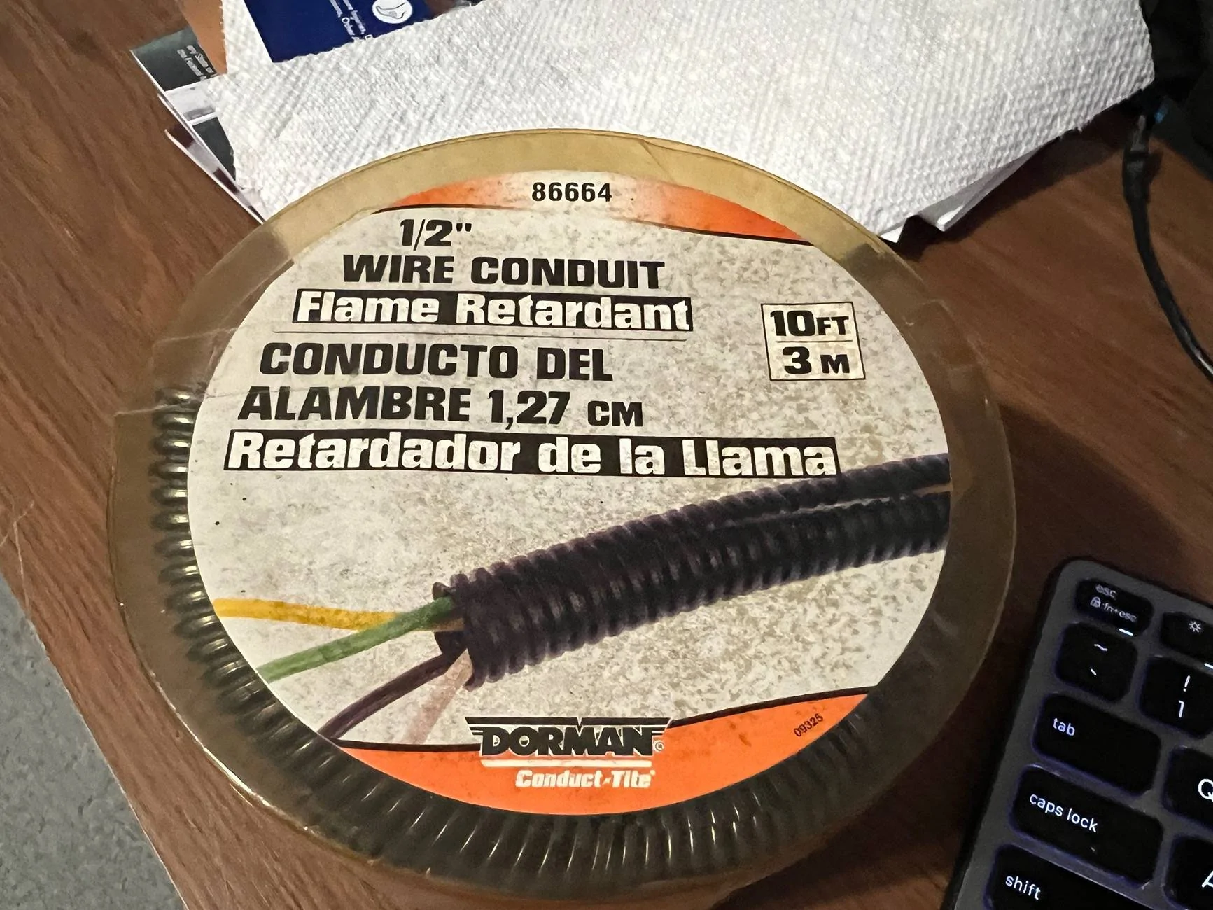

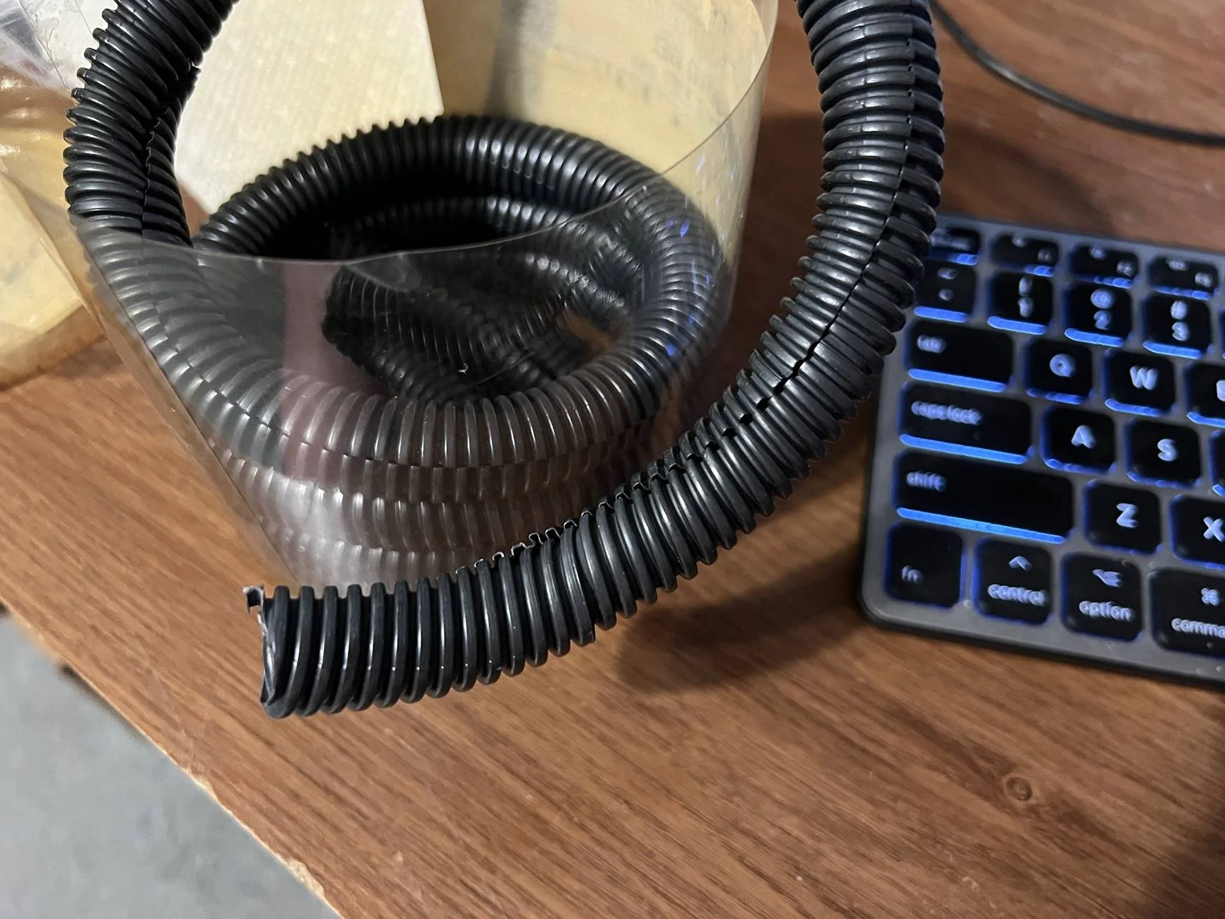

As the other post said check the wiring at the actuators on both sides, they will rub the frame and short out causing the active exhaust not to work. Repair any damaged wires and go to the auto parts store and purchase some plastic high temperature wire conduit, it looks like corrugated pipe but has a slit down the center to insert the wires, that way the plastic conduit will protect the wires from rubbing through again and shorting out.
