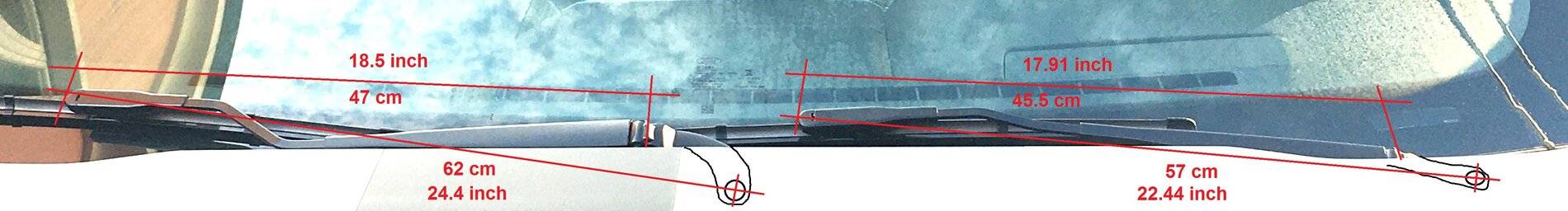

I’m wondering - and this is totally off the wall but, just wondering if perhaps the wiper arms are either swapped OR your driver side wiper arm is not for an S550 and was a wrong part pulled during assembly.
Maybe someone will check this my measurements on his car and compare.
This could show if arms are the same size or not.

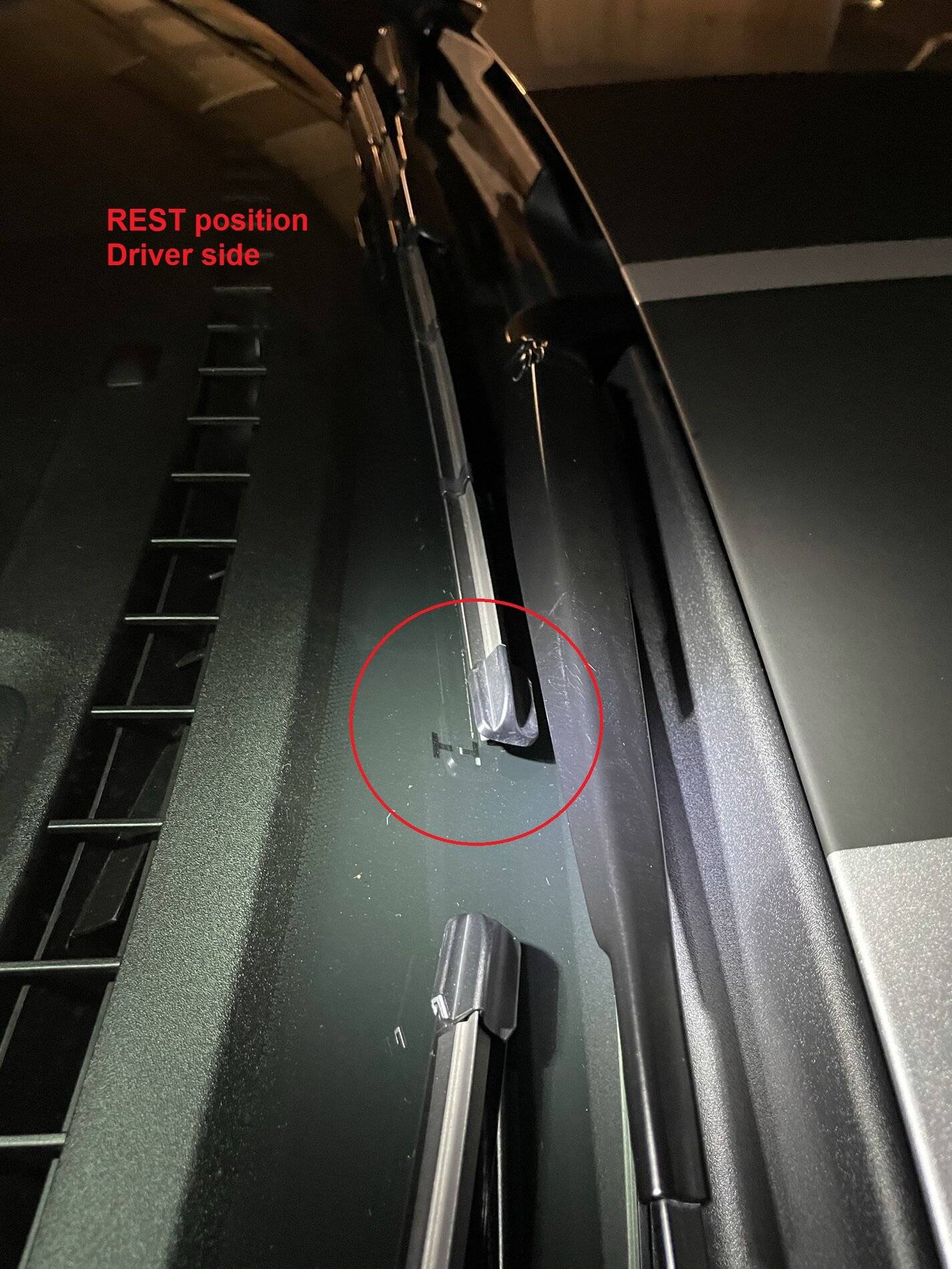

Here are the additional pictures.
Wiper REST positions diver side:
Does anyone of you guys see something wrong, misaligned or displaced here?
Wiper looks one notch too low based on the "parked" ("rest") blade position mark on the windshield.

The picture was made
Yea, good observation, GT Pony.
The picture was made after I have move the end of the blade with my hand to test the "play" (air) in the linkage.
On the picture, the blade is on its bottom position (mechanical limit).
You can see also the dust line of upper position where blade stopped during last powered movement.
The average of both positions is somewhere in the middle of "H" mark.
But - as I already wrote here - I intend to correct its alignment with moving one notch up for test.

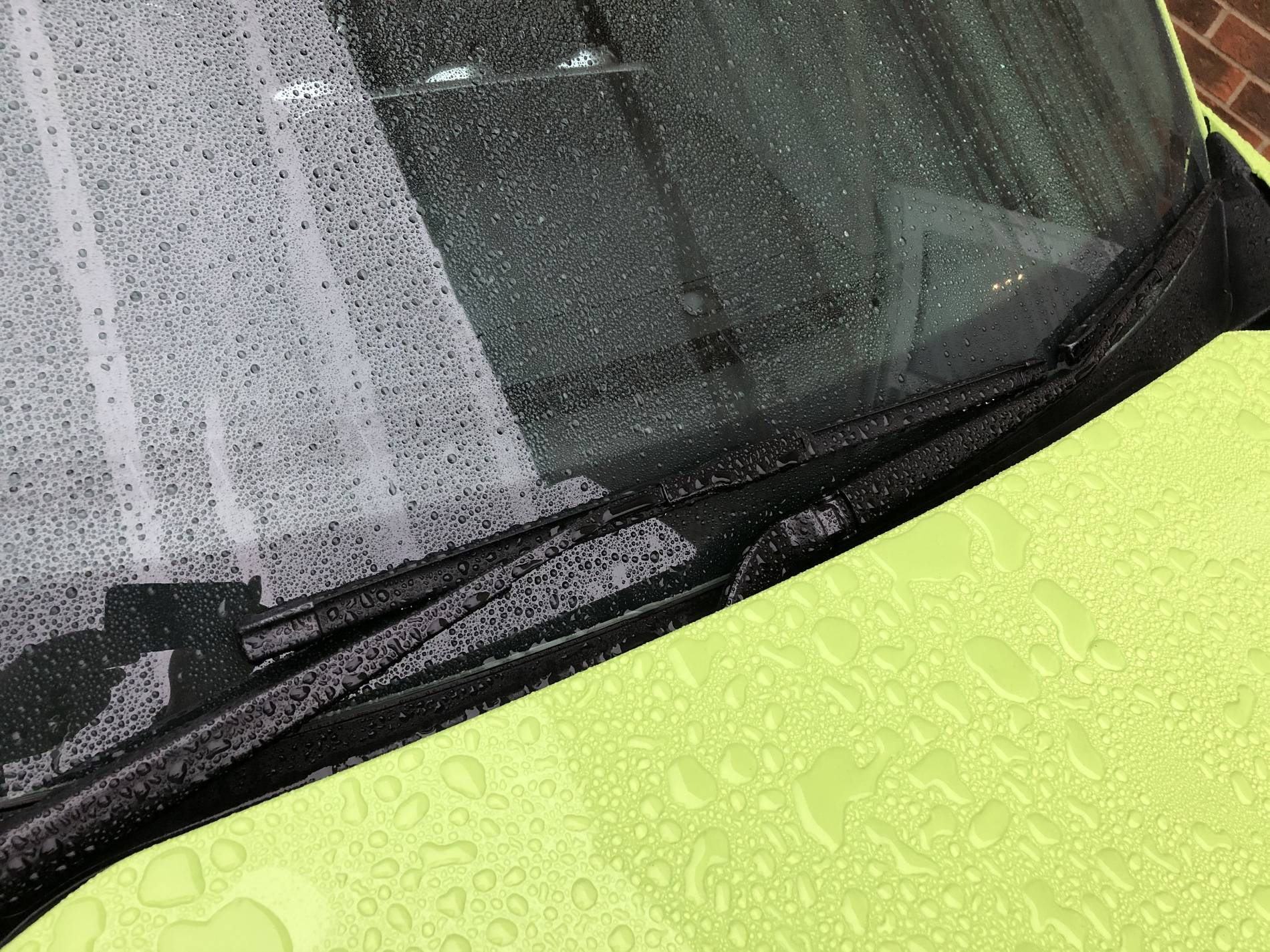

OK, after you all stop telling me my wipers are on the wrong side :cwl: Here’s my RHD :
Both wipers are lower than most I see on this thread, but both are perfectly centred on the windshield marks.
The left side seems acceptable, I can lift that without it contacting the hood - only just, with about 3mm / 1/8” clearance.
The right side needs to be rotated a little to clear the hood and then once lifted, it relaxes back and rests on the edge. I trap a folded microfibre in there before it relaxes but I can see that someone being rough / quick checking the blades at a MOT / service would remove or chip paint.
Im going to rotate the right side one spline and see if that helps :like:
