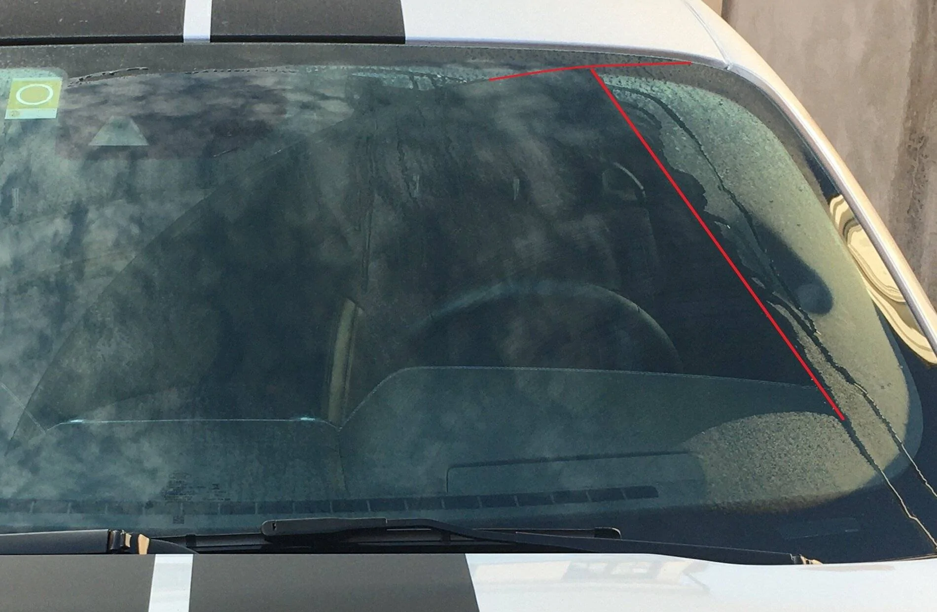

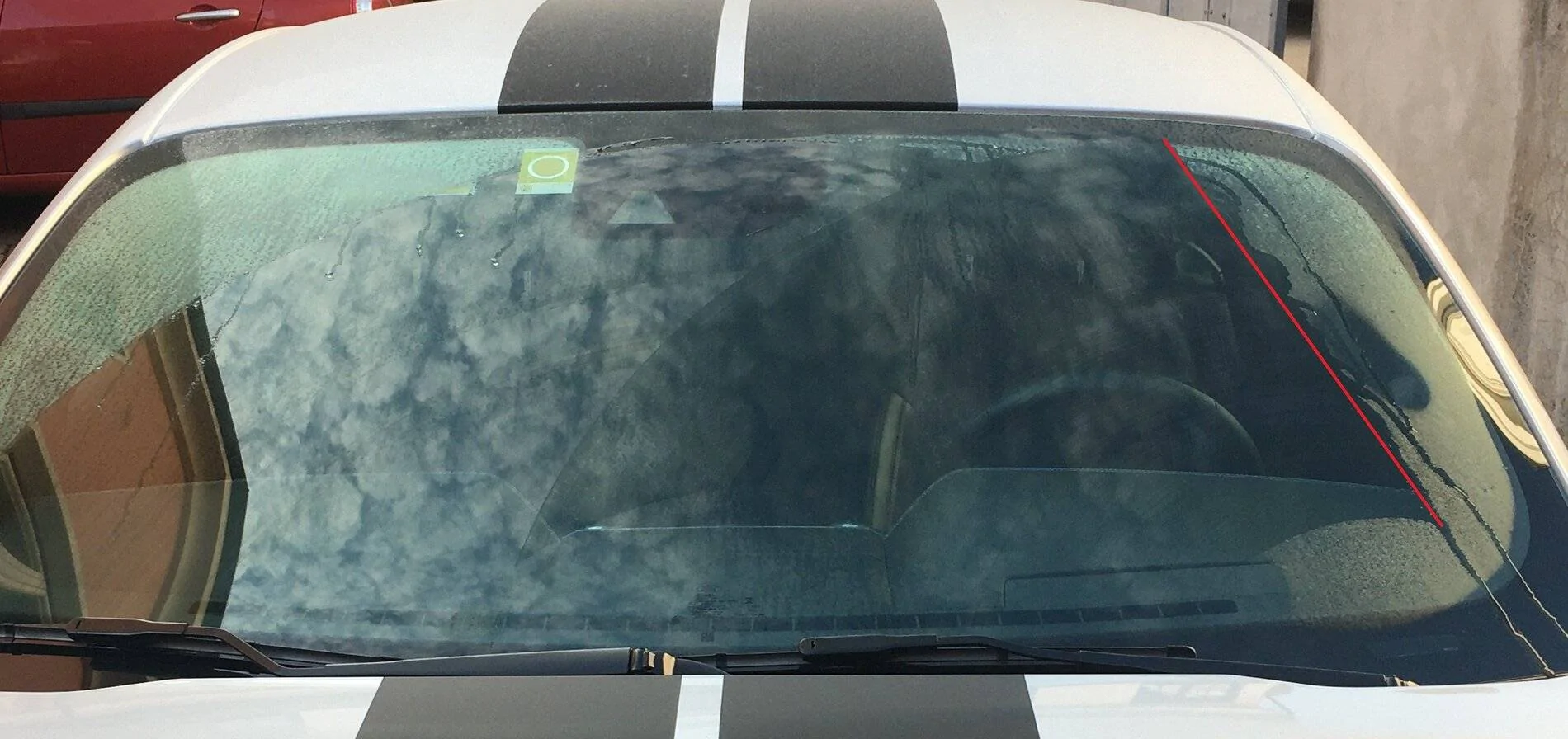

How do you deal with this remarkably obtrusive unwiped area on your windshield?
This is the most unsuccessful driver side wiper blade application I have ever seen.
Just imagine this is the mud or snow!
Edit: Does anybody have the same problem?

Something is __broke__. My driver's side goes much further over to the A-pillar.
It doesn't look or feel broken.
There is no "air" in mechanism, nothing is loos and is working smoothly.
It just don't go all the way to the A-pillar.
Is there something mechanically to adjust on left blade lever?
