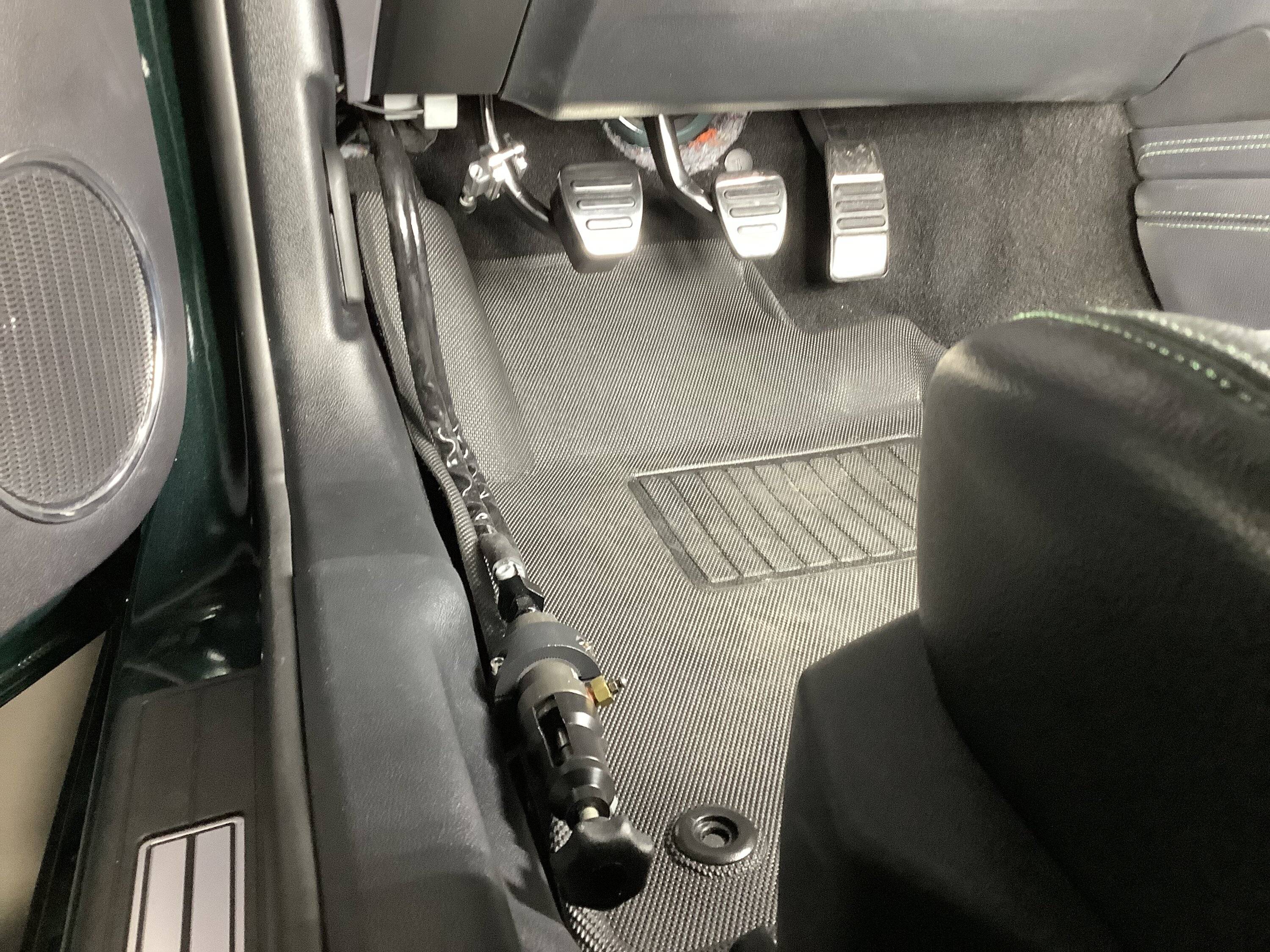

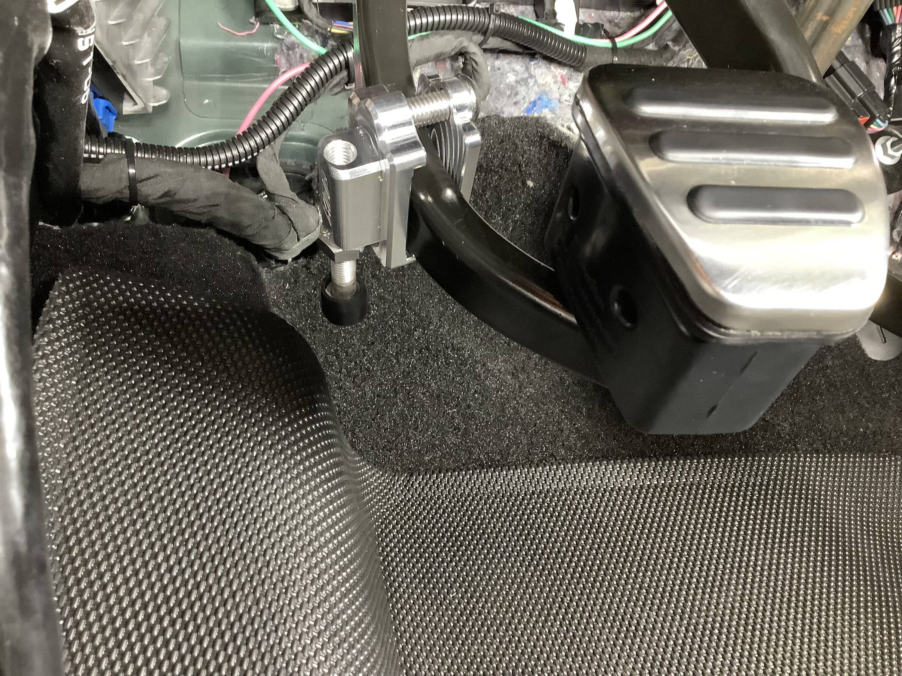

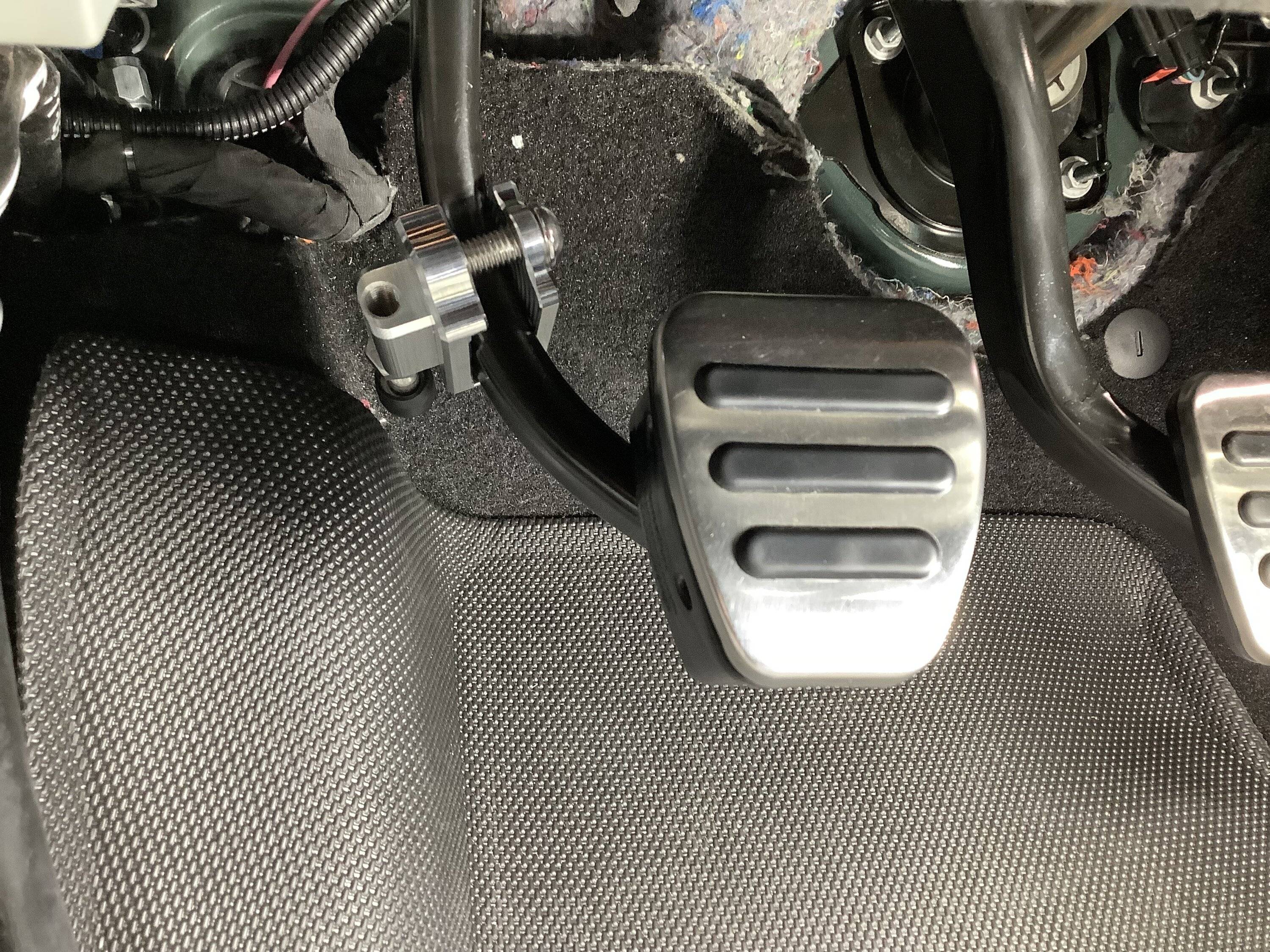

I just put the pedal stop in my car today. I still have to get it adjusted and road tested to see if it will allow for faster shifting. The Hitmaster actually called for one, but I hadn’t bothered to install one until now.

Has anyone considered installing a clutch pedal stop to help facilitate quicker shifts? I just purchased one a couple of days ago and will be installing it soon. It’s not a direct bolt on, as it’s for a 2005-2009 Mustang, so it will require a little creativity. The end goal is to reduce excess pedal travel and hopefully create quicker shifts.
Never saw this before, not sure you want to limit the travel in the Mustang. Page 147 in my owners manual...
"5. Release the parking brake, then slowly release the clutch pedal while slowly pressing on the accelerator.
During each shift, the clutch pedal must be fully pressed to the floor. Make sure the floor mat is properly positioned so it doesn't interfere with the full extension of the clutch pedal."
Works for me.

I get what you’re saying and I’ll definitely use care when adjusting the pedal stop. Here’s what Clutch Tamer says regarding pedal stops for use in conjunction with their clutch systems.
ALWAYS RELEASE THE CLUTCH PEDAL FROM THE STOP WHEN CLUTCH TUNING or LAUNCHING !!! Before you install or test your ClutchTamer, it's very important that you install a clutch pedal stop and verify it's proper adjustment. By proper adjustment, we mean a setting that allows enough clutch dis-engagement to achieve clean hi-rpm shifts, also enough dis-engagement to be able to put the transmission into gear without grinding when the clutch is warm. Using a pedal stop helps ensure a consistent release point, which in turn helps ensure that you get repeatable results. If for some reason you have to change your pedal stop height after you begin the setup process (maybe you find the clutch isn't releasing cleanly which causes a shifting problem), you will need to go back to Step 1 and do the setup process all over again.
