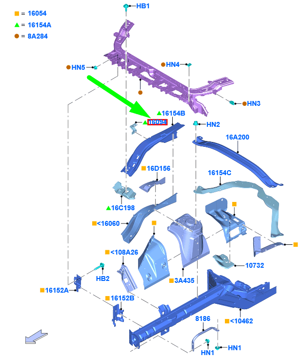

The reason being is the frame rails are a structural part of the unibody - and in some cases they would need to be replaced as opposed to trying to pull them back into order on a frame machine.

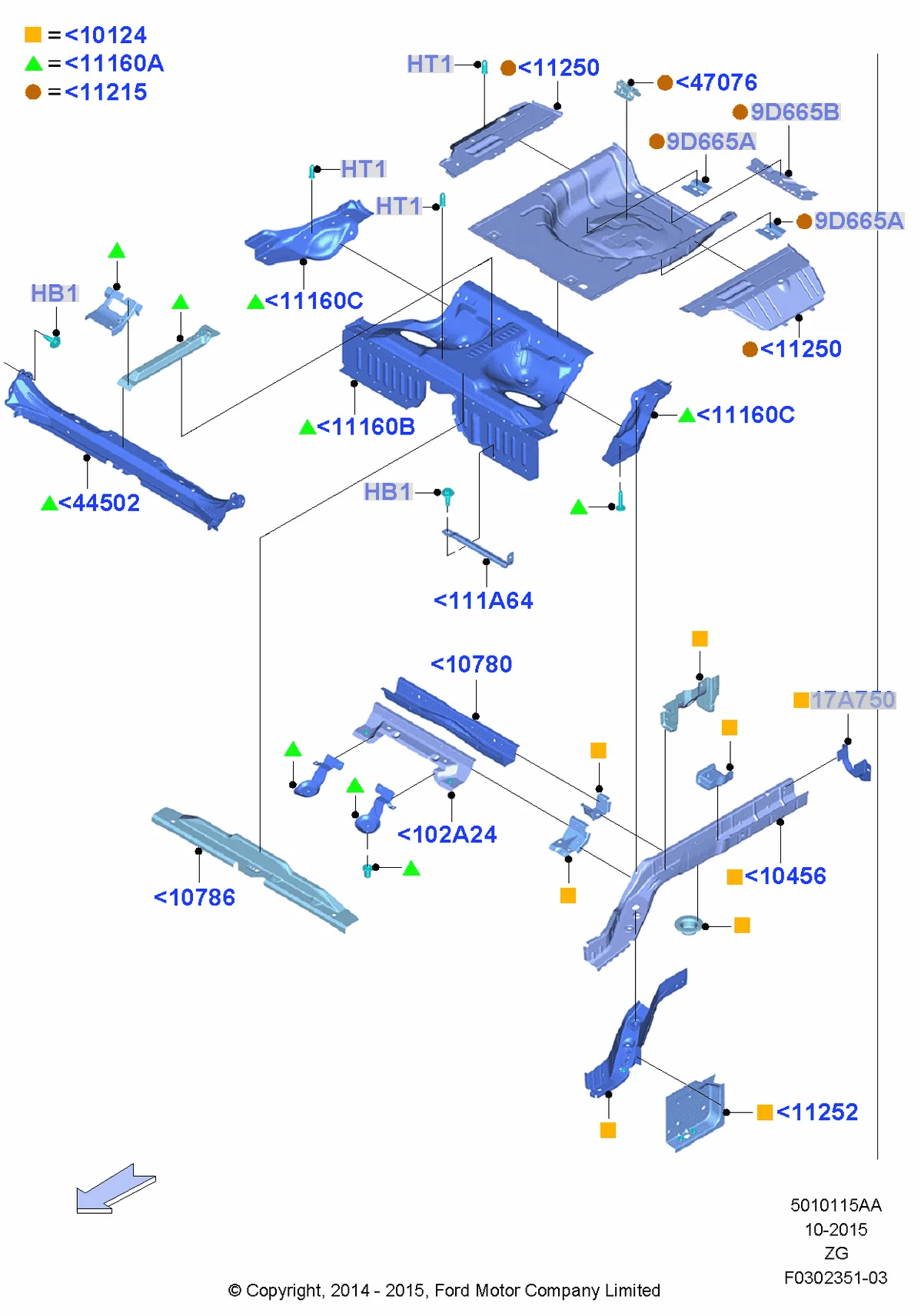

Seems like, that there a OEM repair part for just the end of the frame rail (10462) does not exist for the S550?
At least, the pan is a single part:
