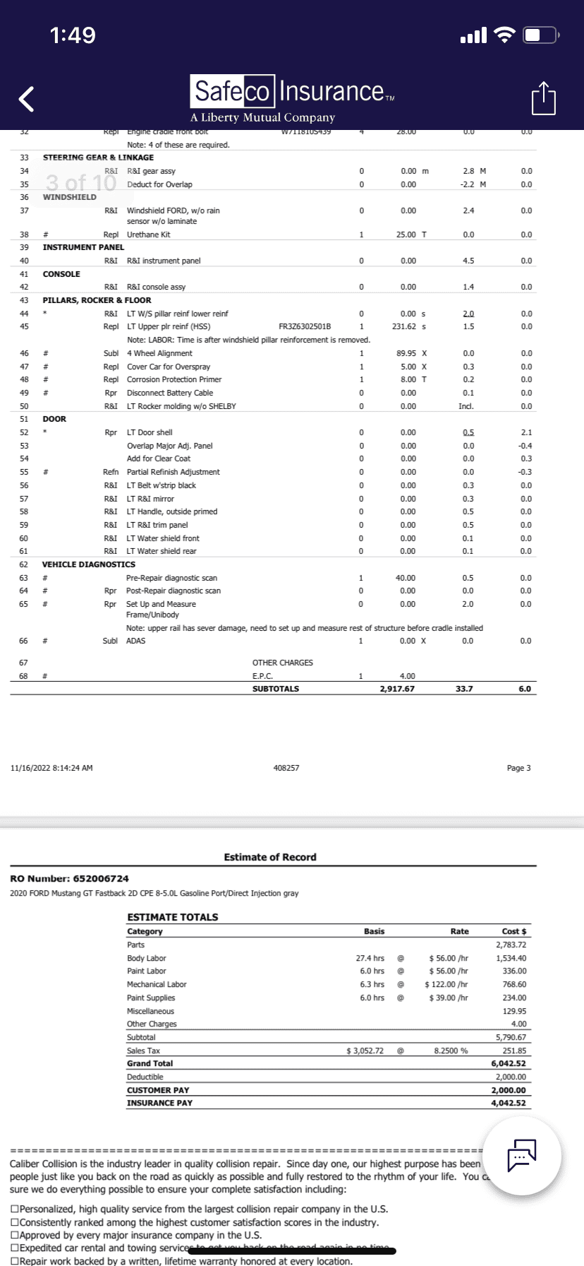

Took a nose dive into some mud last week… very confused because there is little to no damage to the grille and lip. However there is some frame damage under there hood, how bad is this? Honestly the car drivers and runs completely fine… might need a realignment.
Insurance claim has been filed. Full inspection on Monday, really hoping this isn’t my last weekend with her.

This is my first time going through this but from my understanding it will only be totaled if the cost of fixing it is close to the value of the car. I’ve had the damage quoted at around 10 grand by caliber and another reputable body shop.
In order for a vehicle to be totaled, the damages have to be at least 72%~75% of ACV (actual cash value). The % varies by the Insurance Company, but usually the % is within that range.
So hate to bring this part up, but if the vehicle has modifications, sometimes the Ins. Co. will not payout additional $ for mods, unless the mods were covered under a separate rider on the policy OR you had an Agreed Value policy and the mods were lumped into the Agreed Value, instead of breaking them out as separate line items.
If you do have mods and IF the results come back as it being totaled, you could see if your Agent will accept current market values for those mods - doesn't hurt to ask, but just putting the above out there so you're not whammied.

No pictures but I actually just got an update regarding the upper rail damage and minor structure damage. They’re getting ready to have a mechanic remove everything so they can begin structure realignment and upper rail replacement.
