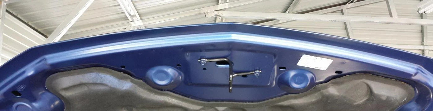

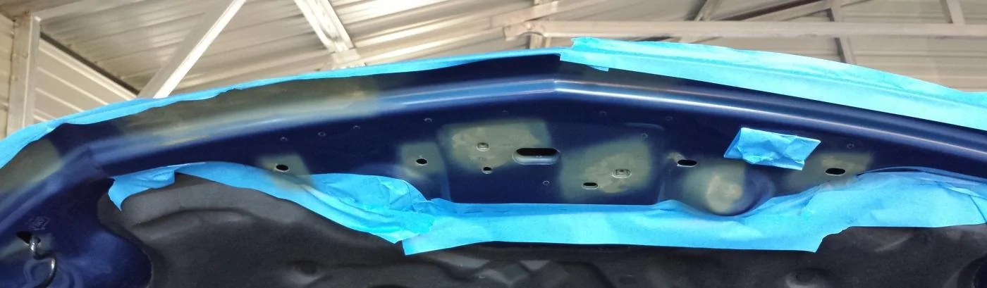

Another possibility besides the other suspects is poor paint coverage. When you make a stamping you have very sharp edges and those sharp edges do not allow paint film buildup. Paint tends to roll off of sharp edges. So if the paint layer is very thin this could allow moisture to reach the aluminum and corrosion can start. Anybody ever see clear coated wheels corrode under the clear, this almost always seems to start at a sharp edge and then creeps under the clear coat. This is just a quess as to the cause but it seems possible in my mind. The pic of my hood shows all the areas that had corrosion, all of them at locations of a punch through or stamping of the aluminum which leaves sharp edges. In my case I don't believe it was galvanic corrosion because I think Ford would have engineered a solution to that. The knocking down of sharp edges is something that no mass produced vehicle would have. I have seen seams coated with seam sealer before they are painted though, that would prevent the problem. I bet the corrosion started at the stamped edge of these 2015+ hoods. I really had hoped not to see this problem again with the S550, pisses me off and I don't even own one yet. If you monitor the hood you can catch it before it creeps to the topside. It should a warranty item for sure but I know how they like to wiggle out of covering certain problems. I suggest everyone staying on good terms with their dealers as to enhance the possibility of a good will repair. There were plenty of S197 guys who did not receive any help. Good Luck OP
Probably wouldn't hurt to give all the seams a good coat of wax once a year. Coat of wax might help keep water out of small cracks, etc along the seam.

RobD: you haven't said that the hood aluminum is corroding away...you did say that the paint is blistering along the 'sharp' edges? If oxidation/corrosion is occurring along the sharp edges, I would expect that water may be working under the paint and the resulting oxidation is lifting the paint. (Your example of the coated wheels).
The F150 has inert pads that separate aluminum from steel parts to prevent galvanic corrosion and weakening of the aluminum. I don't see how Ford can prevent oxidation at sharp edges where anti-corrosion protection would be the thinnest, if at all.

tsunami: Yes my hood had the white powdery corrosion under the paint. I wire wheeled down to shiny aluminum, then self etching primer, followed by top coat. The galvanic corrosion issue could be part of it but I don't think that is the entire story. I got to thinking about the dissimilar metals and I wonder if these aluminum panels are being contaminated by the machine that punches out the part. I'm thinking microscopic iron particles clinging to the edges of the stamped aluminum part could lead to galvanic corrosion. I know it's a stretch to think that way but crazier things have happened. Back to my other thought of thin paint coverage. Years ago I bought a new white F 150 and I noticed a flaw in the door jam at a spot weld. Spot welds sometimes have sharp edges after the electrode melts the panels together and at this sharp point there was rust. Further evidence of paint not adhering well to a sharp point or edge.
I absolutely hate that this problem has reared it's ugly head once again. I haven't looked at the F 150 forums...sure hope they are not having issues. If we could be sure Ford would step up and fix these problems it wouldn't be as upsetting but I know they tend to wiggle out of these cosmetic issues. They blame acid rain or other environmental BS. I worked with a guy that had a 08 Taurus X and after about a year and a half his hood had the dreaded corrosion. No warranty for him...they did split the cost of the repair with him though...a good will effort by the dealer.
