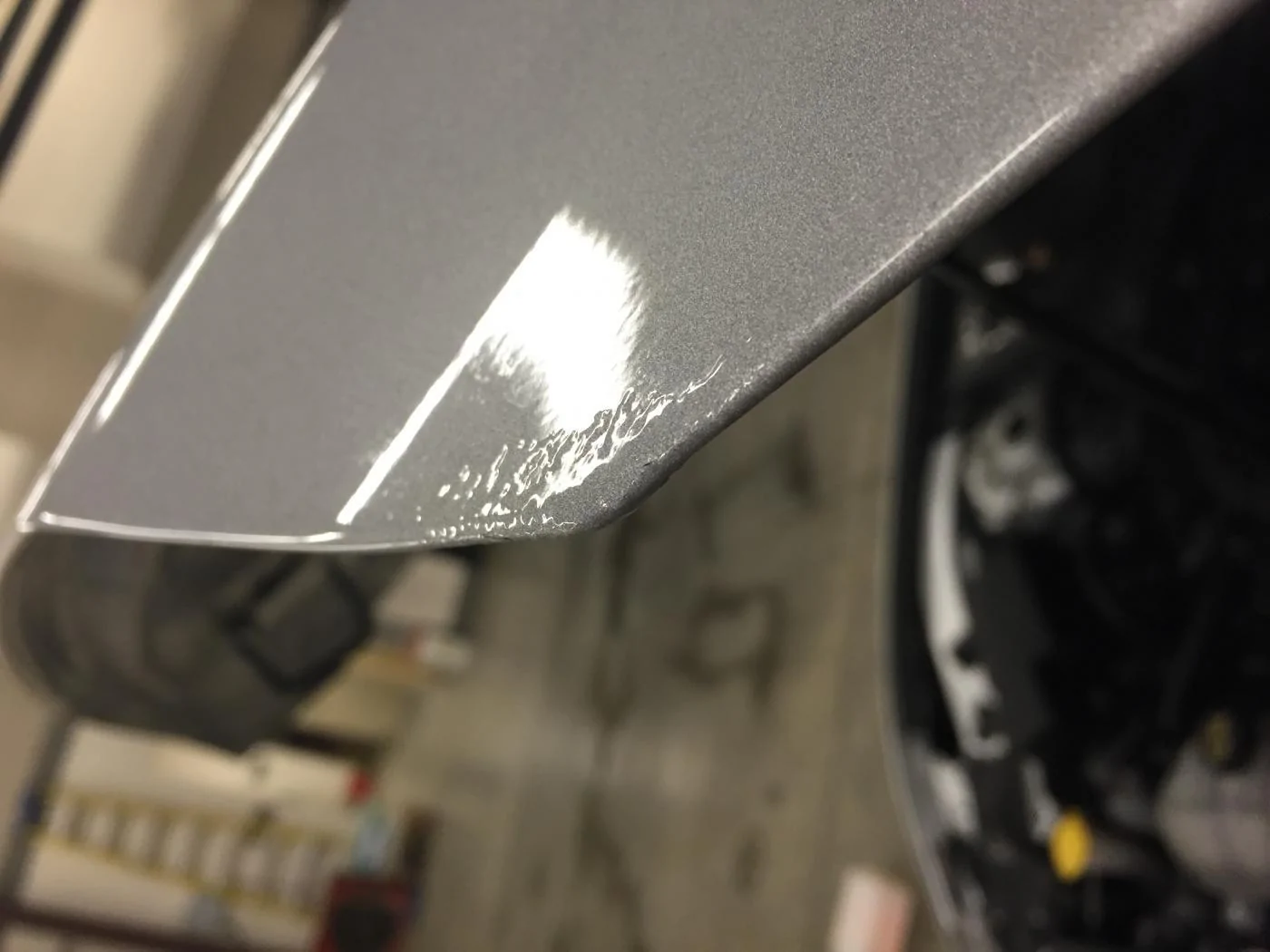

Here's mine the worse of the 2 spots

^^^ So it looks like if this problem raised it's ugly head that it will be along the edge of the hood where the lower steel sheet and upper aluminum sheet make contact.
I take it there is supposed to be some kind of sealant between the two metal layers to help prevent the galvanic corrosion from occurring?

So I'm wondering why Ford just doesn't make both sides of the hood out of aluminum. That would cure the galvanic action between two dissimilar metals and also make the hood lighter.
I take it there isn't any corrosion issues between the aluminum fenders and the rest of the car ... or do the front fenders also corrode in certain areas?

BOTH sides of the hood are stamped Aluminum. I just put a magnet on mine. However at the corners on the front of it where it meets the bumper fascia, there is appears to be riveted inside the sandwiched sections what must be a steel reinforcing plate since the magnet was attracted to the areas between the rivets.
Most likely the corrosion in the photo above was due to oxidation of the Aluminum before it was primed as I read happens quickly with bare raw aluminum.
Ah, good info. I never tried the magnet test on the inside sheet of metal. If they are still mixing metal in the hood, why not make everything aluminum, including reinforcement plates and rivets?
I wonder if the cars that suffer from this were ones made during the time of year when it's very humid there in Flat Rock, MI? Might make sense if you think it's caused by oxidation setting in before painting.
I tend to agree with this assumption for the paint bubling (lack of adhesion, due to oxidation on the aluminum) more than the possibility of a gavanic reaction from dissimilar metals.

I noticed something very similar to the picture on the first page of this thread on my car when I was doing the inspection of my Mustang before I purchased it. It's on the under side of the hood on a seam. To me, it looks like a sloppy job with the sealant. It never crossed my mind it could have been corrosion as the car was built 3 weeks prior to me picking it up and noticing this (I order the car the way I wanted it). The area is on the underside of the hood, on the seam, on the right side/front leading edge, but underneath on the seam. It's also in the same spot on the hood on the left side, but not as noticeable which re-enforeced my thought that is was a sloppy sealant job.

It is caused from the seam and the seam sealer.

Paint corrosion has different warranty terms beyond the 3/36.
RUST & CORROSION
Your vehicle´s body sheet metal panels are covered for an extended Corrosion Coverage Period, which lasts for five years, regardless of miles driven. The extended warranty coverage only applies if a body sheet metal panel becomes perforated due to corrosion during normal use due to a manufacturing defect in factory-supplied materials or factory Workmanship. If aluminum body panels have corrosion or rust damage, and the damage is not the result of abnormal usage, vehicle accident, customer actions and/or extreme environmental conditions, the corrosion or rust damage repairs are covered for 5 years, unlimited miles. For damage caused by airborne material (environmental fallout) where there is no factory-related defect involved and therefore no warranty - our policy is to provide free repair of paint damage due to the airborne material for 12 months or 12,000 miles, whichever occurs first.
