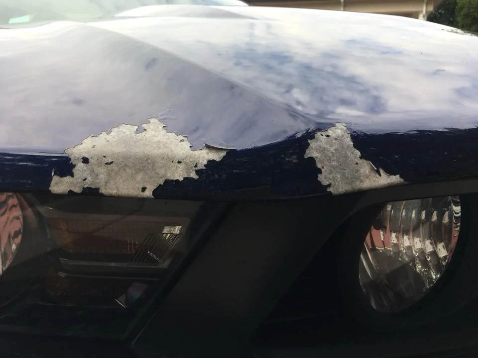

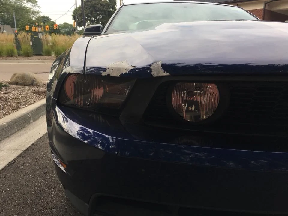

Round 3 for me... Third time it's happened on my original hood. This time I'm tempted to ask for a new hood. Or maybe even an aftermarket fiberglass hood if I can dream. :angel:
Just to show how bad it can get, below is an acquaintances 2011 GT with 106,000 miles and left unchecked...
