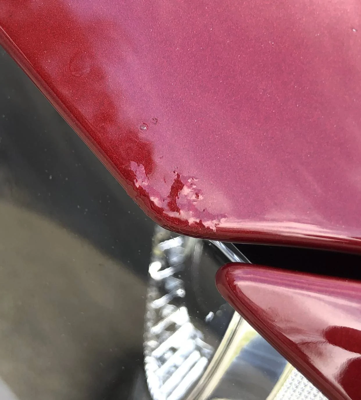

Post some pics. Bubbling is due to corrosion underneath.
Do you have the work order from when you brought the car in originally
for this?

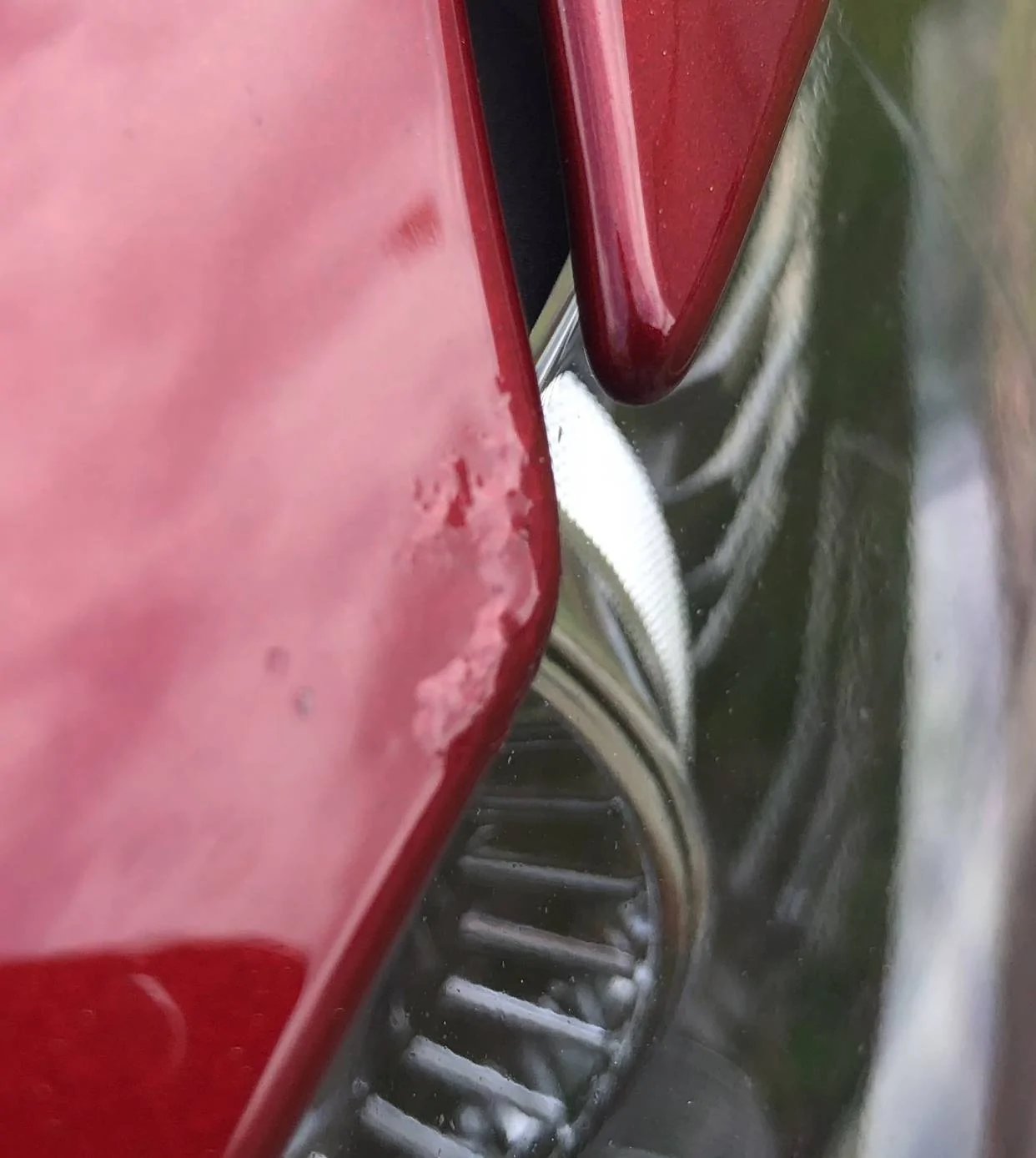

I have an appointment coming up for them to look at it and my 'bubbling' looks extremely similar to yours except a few inches to the left. I may show them your photos to help my case.

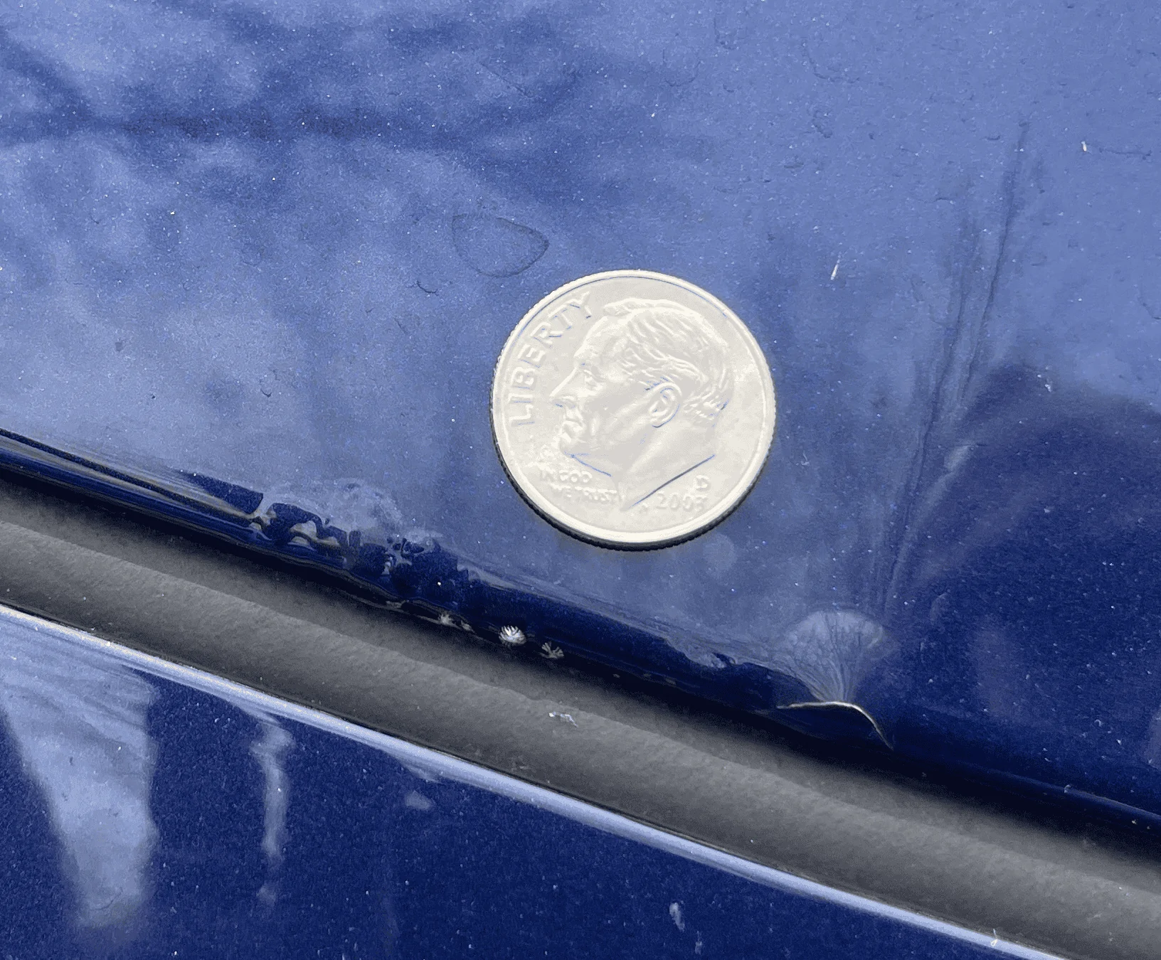

As a side note, I noticed two 1/4" bubbles on the leading edge of my hood last week while at the dealer for an oil change (Yes, I use the dealer for oil changes. Tell me where else I can get 10 quarts of oil for $16, let alone labor). It must have happened over the winter, as they were not there when I last hand-washed the car in the fall.
The service writer blew me off ("Needs to be perforated"), but I figured I had a year to go before running out the 5-year limit. Sitting with my wife last Saturday and realized my car was nearly 5 years old NOW.
Went back to the dealer today and stopped at the asst. service mgr, who said, "Oh, on a Mustang you don't need perforation", and kicked off the process.
The car is going in for the hood replacement on Wednesday. Just in time. The warranty runs out a week from tomorrow.

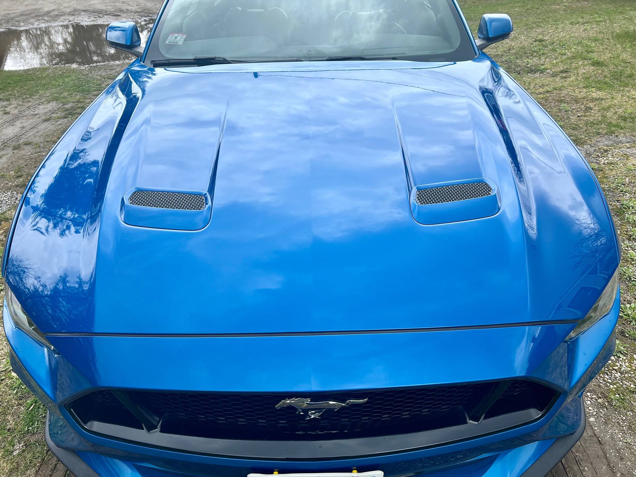

Forgot to post after pics. mine was done first week of Feb, car was gone for two days and shows no ill effect from being sent out in the middle of coldish weather (20-30*F).
