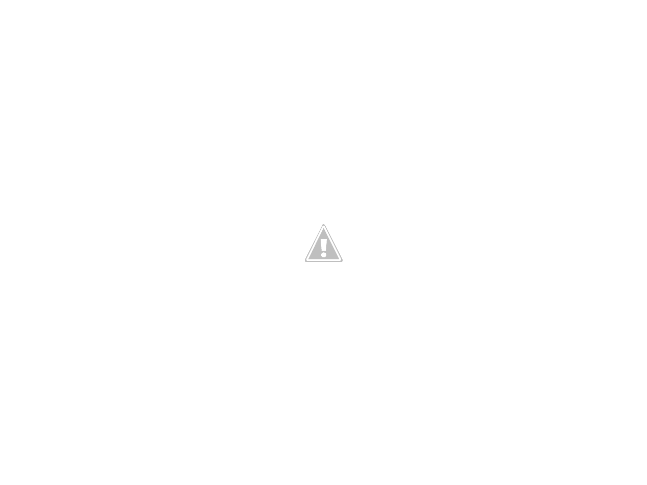

This is what mine looked like about a dime size bubble and they are redoing the whole hood. I pick the car up this evening not sure what kind of warranty they are going to give me yet on the new paint job but I hope it never bubbles up again because I plan on paying this car off and keeping it.

The problem is that the corrosion is galvanic. It's a production error in the aluminium. This means that repainting isn't solving the problem. A new hood is what you need. I had some on the very edge of my trunk close to the decklid.
Bringing it in today to get them to look at the trunk hitting tail lights, small part of the rear bumper, the corrosion, and clicking/ticking under moderate acceleration when the car isn't 100% warmed up.
This car is losing its charm real quick. Considering they recently replaced my intake manifold for the runner valves sticking.

Well after almost two weeks I finally picked up my car yesterday. The hood looks good and she wasn't sure but told me it's covered for one or two years and then basically said if it does it again just bring it back lol. They redone the whole hood at least.
