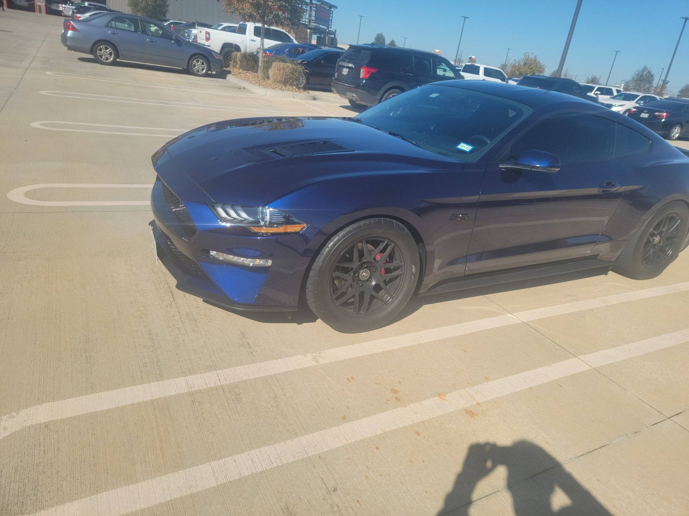

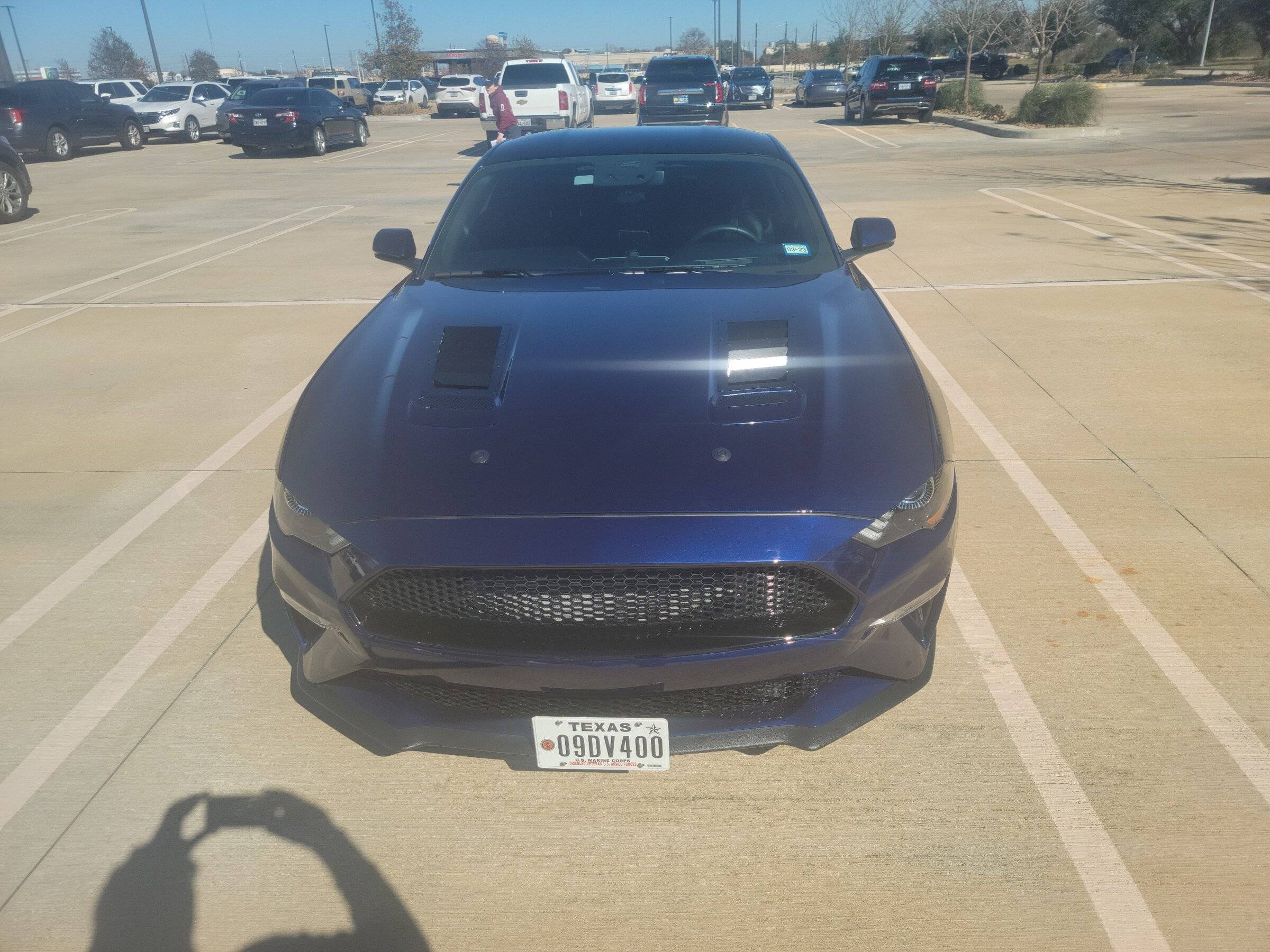

I found the racelouvers as well now, reached out to them. Looking at the side profile on their website, I think the two side hood vents would make less drag. They don't sit up as high and are already behind the factory vents. Though not sure if this will result in them not doing what I need. I doubt the drag difference matters to much, but I do know rule of thumb for airplanes is speed varies with the cube of hp. Either way I like the look of the two sides compared to one center; but I need it to work as missing part of bumper doesn't look good at all. I'll see what they say.

quick update, race louvers replied first thing Monday to my question, very detailed response. I ordered the RT side hood vents from them.

Installed, haven't got to 150 yet to see if the bumper rips off again. Also plan on getting a new intercooler with BOVs in front of the radiator. This should reduce the pressure/shock under the hood when I let off on the big end.
