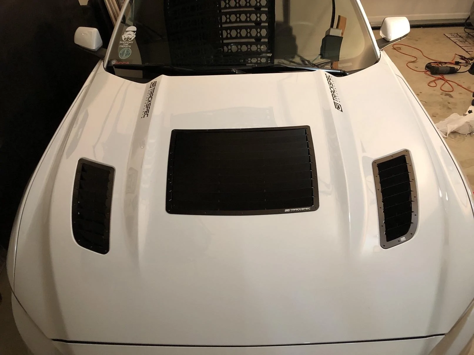

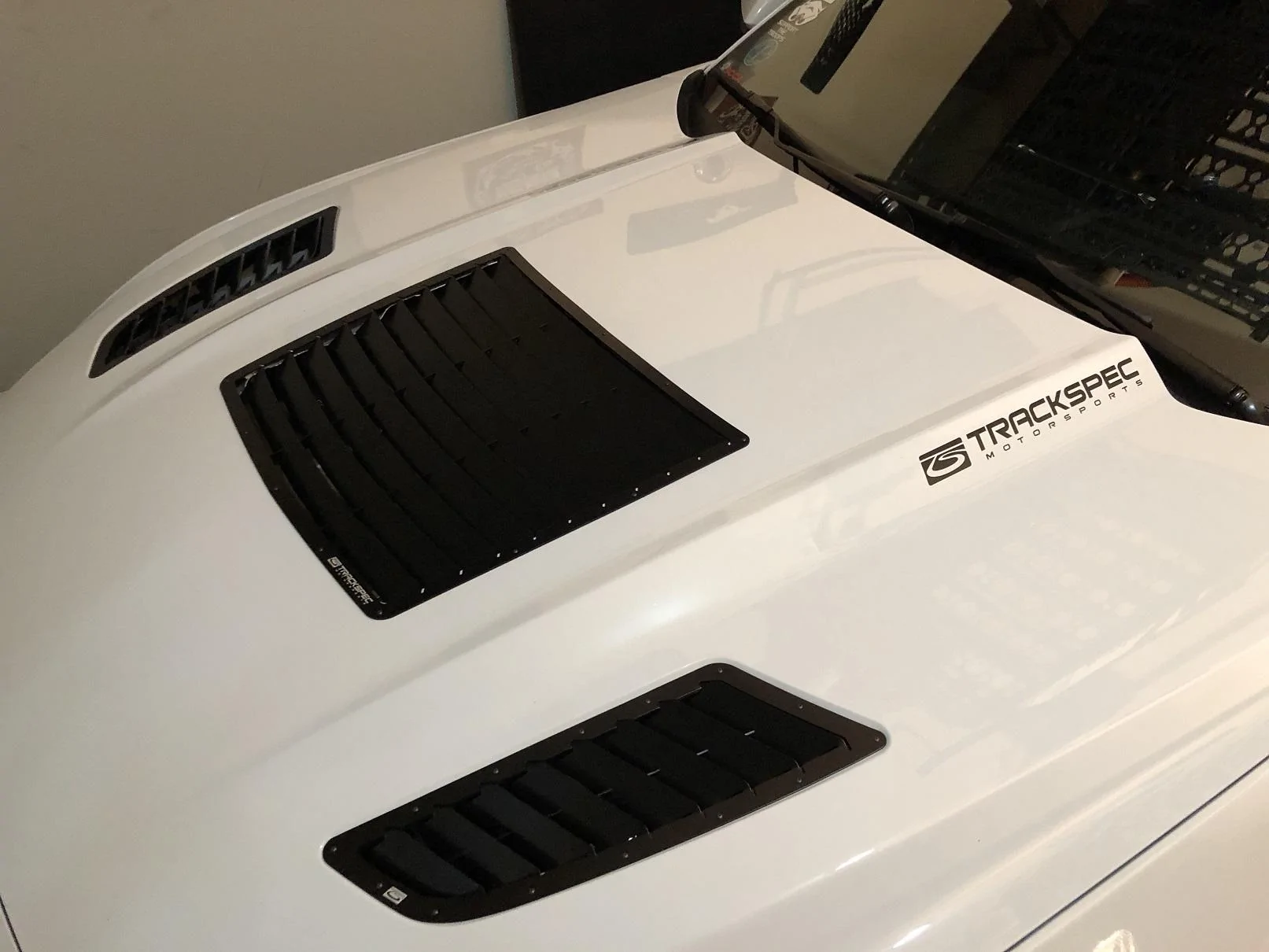

Trackspec GT4 center vent
Cardude99
Feb 14, 2016
69
2,472
1,058
Phoenix, AZ
Sam
2018 Ecoboost
Man this looks great on the 15-17 hoods. I wish their side vents replaced the 18 vents and didn't add to them

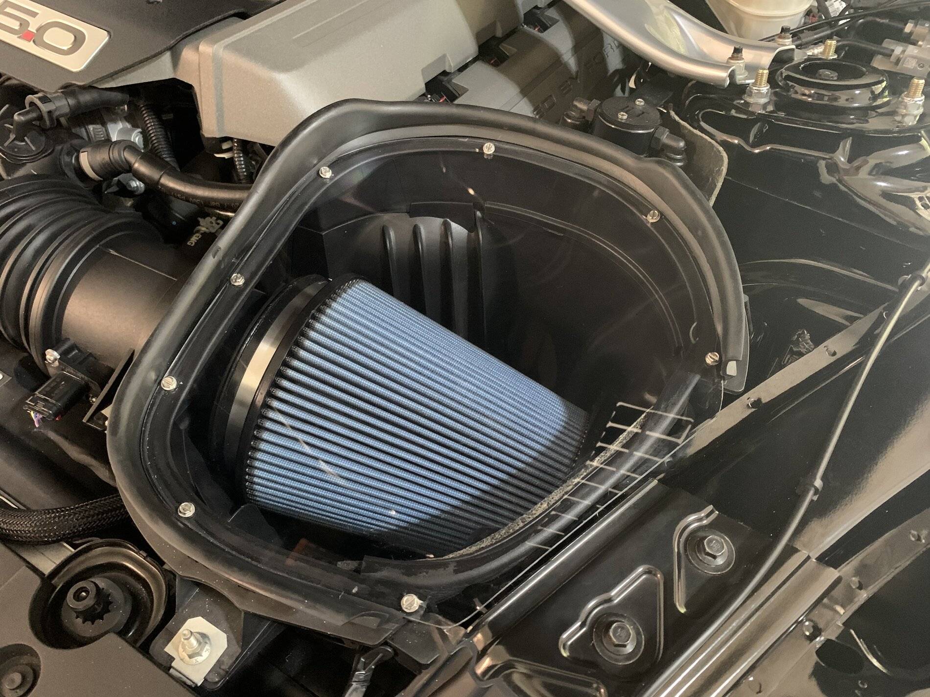

Do you have to have an inclosed CAI with these vents?
EFI
May 19, 2015
65
5,287
4,733
Masshole central
5.Br0
If you drive it on the street and/or track it in the rain yes.
Looking down the driver side vent, you see the entire airbox assembly. If it rains, it's all going to pool up on the bottom of the airbox.
You shouldn't really be driving this setup in the rain, while the engine is relatively waterproof I don't think it's good for rain to constantly pour all over your engine bay.
JohnD
Legend in his own mind
Sep 26, 2016
676
325
beyond the pale
2023 Mach 1 track day car
It is simple to put a plexiglass cover over it and that has the added benefit of preventing hot underhood air from getting into it. It does not seal well to the bottom of the hood, best to just abandon that whole idea and use a cover that will keep hot air out of it for sure. Plus no issues with rain with that cover.

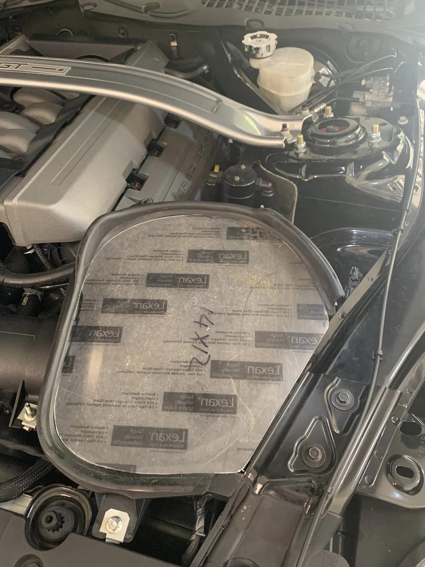

This worked for me...
Reaper5.0
Jan 3, 2019
79
67
Toronto, Ontario
Steve
2022 Mustang GT PP
That's great! Where did you get that plastic piece?
Bridgie
May 25, 2015
587
963
Raleigh, North Carolina
2015 GT fastback. PP, 50th trim, Black
Took a piece of 2mm Lexan and cut to rough shape, then edge sanded to fit snug.
Used some self tapping screws for securing to the GT350 intake. No water ingress, does the job great..!
After fitting the vents and removing the under hood felt, the air box didn’t seal... intake temps soared.. There is now no heat wash from the engine bay now.

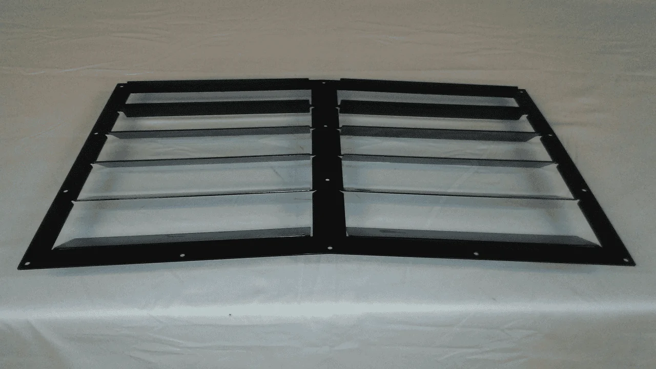

Does anyone know if there is much difference functionally between the Trackspec hood vents and the Race Louvers vents? The Trackspec is slightly larger overall, but the Race Louvers appears to be more open, with a more aggressive angle on the vents for extraction (see below).
NightmareMoon
Nov 22, 2015
7,178
6,470
Austin
2016 Mustang GT PP w/ Voodoo
Well, Race Louvers will tell you that theirs is better than their competitors. They have youtube videos and such.
Scootsmcgreggor
Oct 26, 2018
502
393
CA
2016 Ecoboost turned GT
Wind tunnel testing has shown that the wicker at the front of the racelouvers creates a bigger low pressure zone over the vent that allows more air to exit, making it more efficient.
SVO MkII
Mar 1, 2018
35
647
287
IL
2018 Ecoboost, 6sp, PP, 2017 GT Convertible
Yes, the Race Louvers design definitely looks like it would be more effective than the Trackspec. Arguably, the Trackspec looks a bit nicer, but I really want something functional that will bring temps down on track. Race Louvers is probably a bit better in that area.
