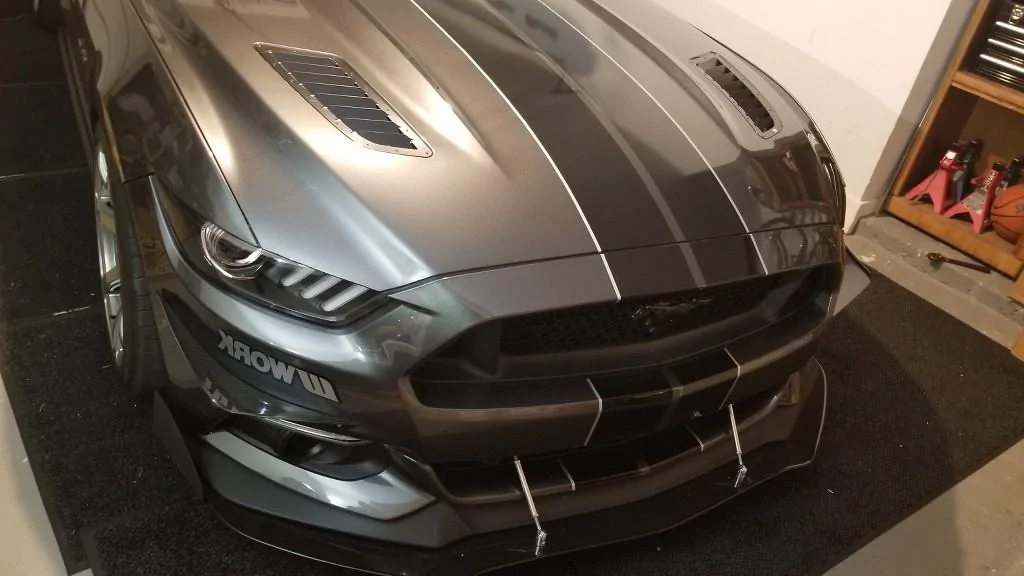

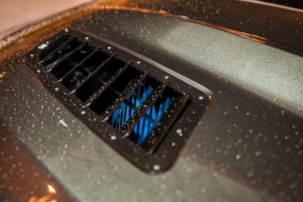

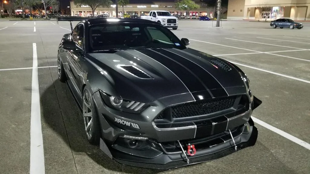

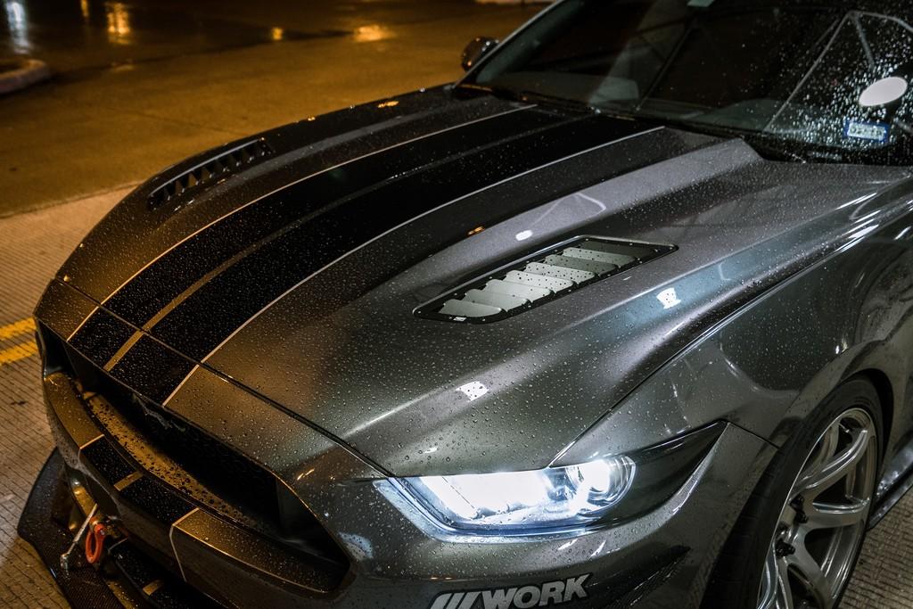

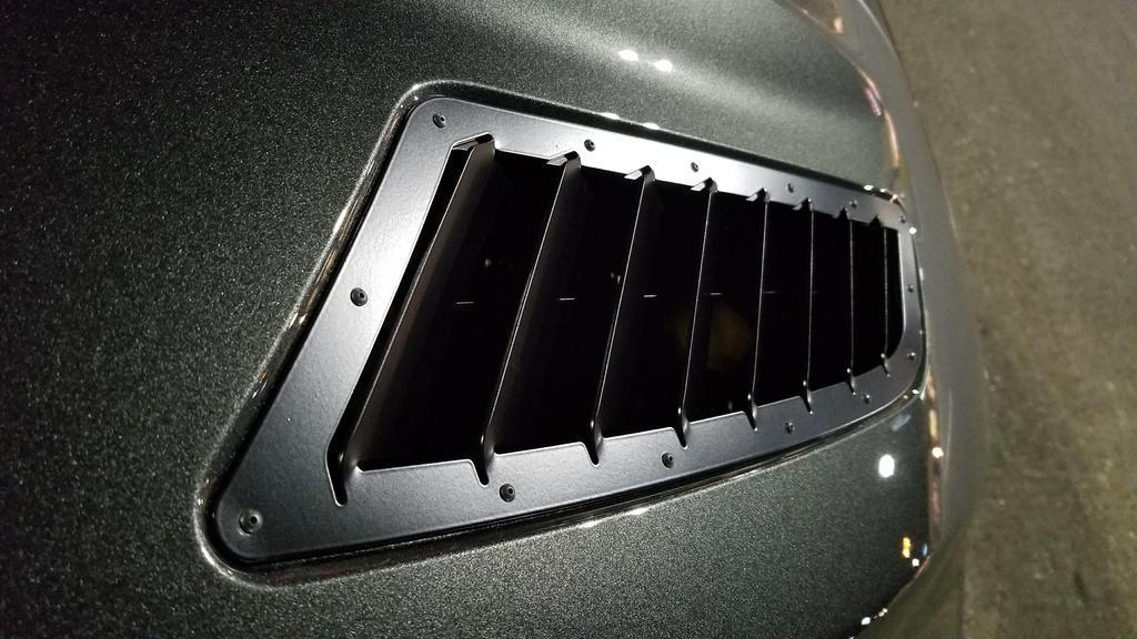

I ordered a set of these Track spec vents and installed them last week. Just wanted to share a few pics. Honestly they are kind of a pita to install haha. Had to cut a lot out underneath the hood and when i thought i was all done and cleaned up i had to make a mess and cut more so i could reach to attach the minuscule hardware that is very tedious to get in and all lined up. The main thing is trying not to cut into your hood too much and ruin it by scratching it all up. Despite all of that im in love with the end result because they add an aggressiveness to the car and also seem to be super functional.
Huge thanks to DB252 for answering some questions i had during the install process, i had left the bottom frames for the vents in the box and was very confused on how they attach at first until he pointed out that there are 2 pieces for each side.
Now i can hear the intake whoosh whenever i dip into the throttle which is cool and the first night driving after the install of course its starts raining to got to test out how they would handle that and everything seemed to stay nice and dry and blocked most of the water out while driving. Its not my daily so not to concerned about driving in the rain, but yeah would recommend just take your time installing and don't try to take your hood off by yourself, get an extra hand ; )
