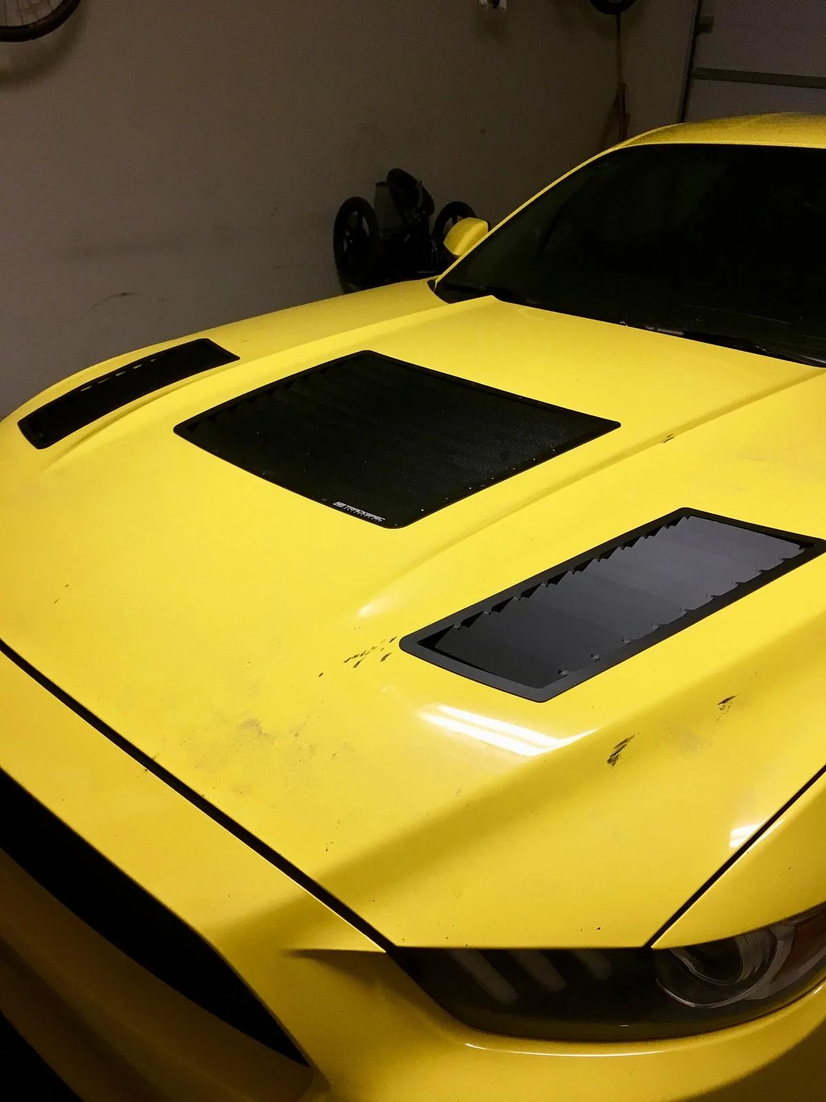

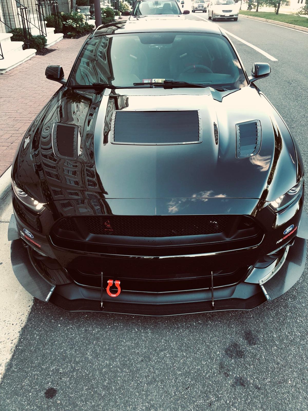

wondering if anyone has mixed and matched these two vents. ( verus side vents and trackspec center vent.) Looks like they would match better mixing the brands. post pics if you have done so!

I plan to add the verus side vents to my center trackspec within a month or two. I agree, they seem like a good pairing.
Our cars look pretty similar based on your profile picture. No complaints with the Tracspec pairing!

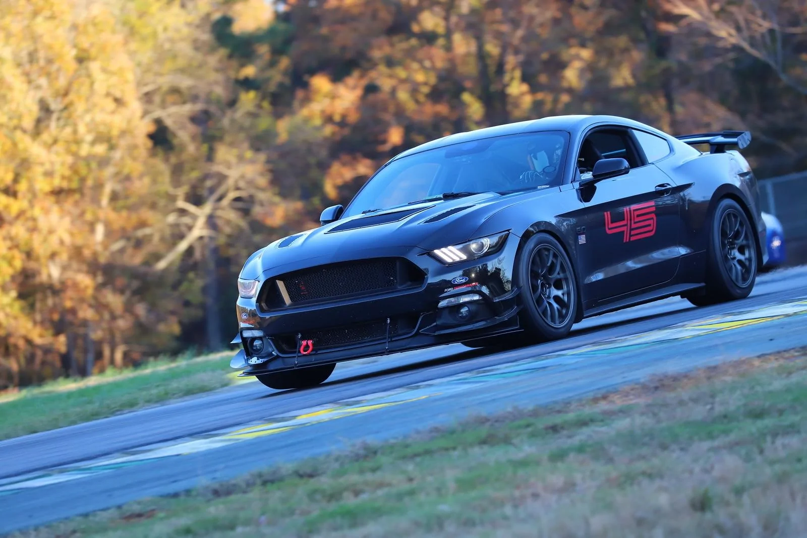

Just finished the install today. I am really happy with how it came out.
Car is still dirty from last track day so just a quick picture for now. Should hopefully have some time this week to clean it up and take some better pictures.
