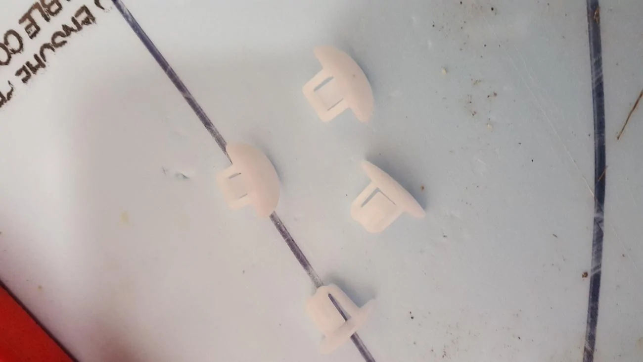

So, I did a really good job installing an R splitter on my car.... but now I can't get the "click tabs" to release so that I can remove it.
I've pulled all the screws and the four white 1/2 circle tabs (and accounted for all the hardware on the inventory list) and the only thing holding it on are the "click tabs" along the leading edge.
I can see the farthest outboard tab on each side, but none of the others.
Any tips or tricks to getting those to let go without ripping the whole front fascia off the car and/or breaking the slots?

Nope - got the moon clips out.
It's the tabs that you use the shop towel and rubber mallet to seat and "click" into place when installing that I now can't get to release.

My mechanical sympathy was kicking in before the splitter would come off by just using the "yank hard" method. So, using Tom's pic and the one I found on-line, I decided that by putting some form of wedge in where the locking tabs are located, I should be able to take a little pressure off of those and allow the splitter to pop loose with less effort.
I had a box of very soft plastic body filler spreaders laying around, so I cut a couple into strips thin enough to fit into the visible slot at the front of the splitter, then after turning up the heat in the shop to make sure the bumper cover and splitter were warm enough to withstand the force, I gave it a slight tug.
Sure enough, it popped loose with very little effort. Here's a pic of it with the wedges in place before I pulled it off.
