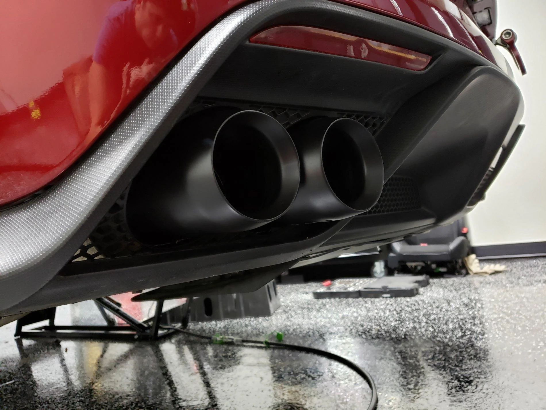

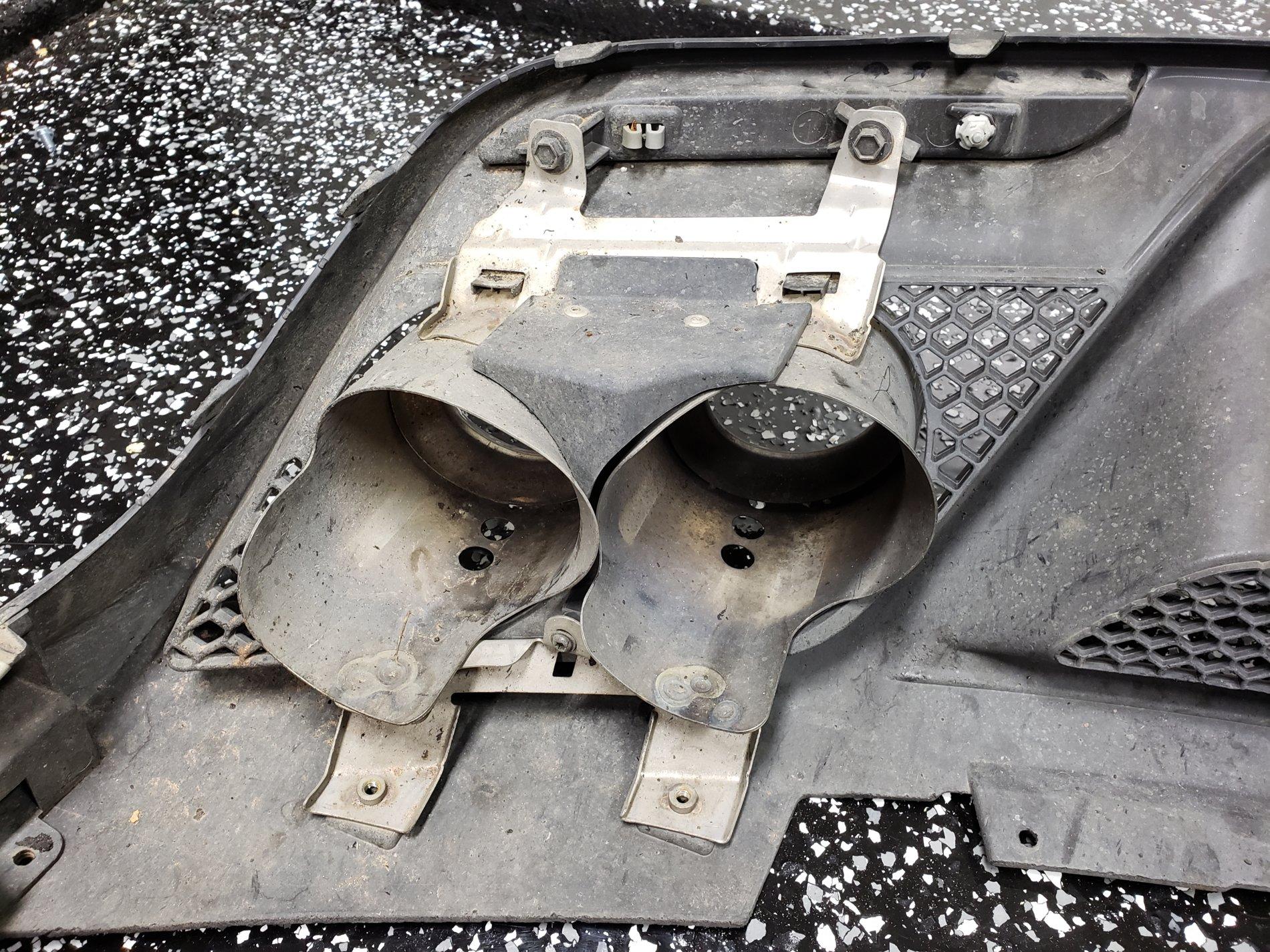

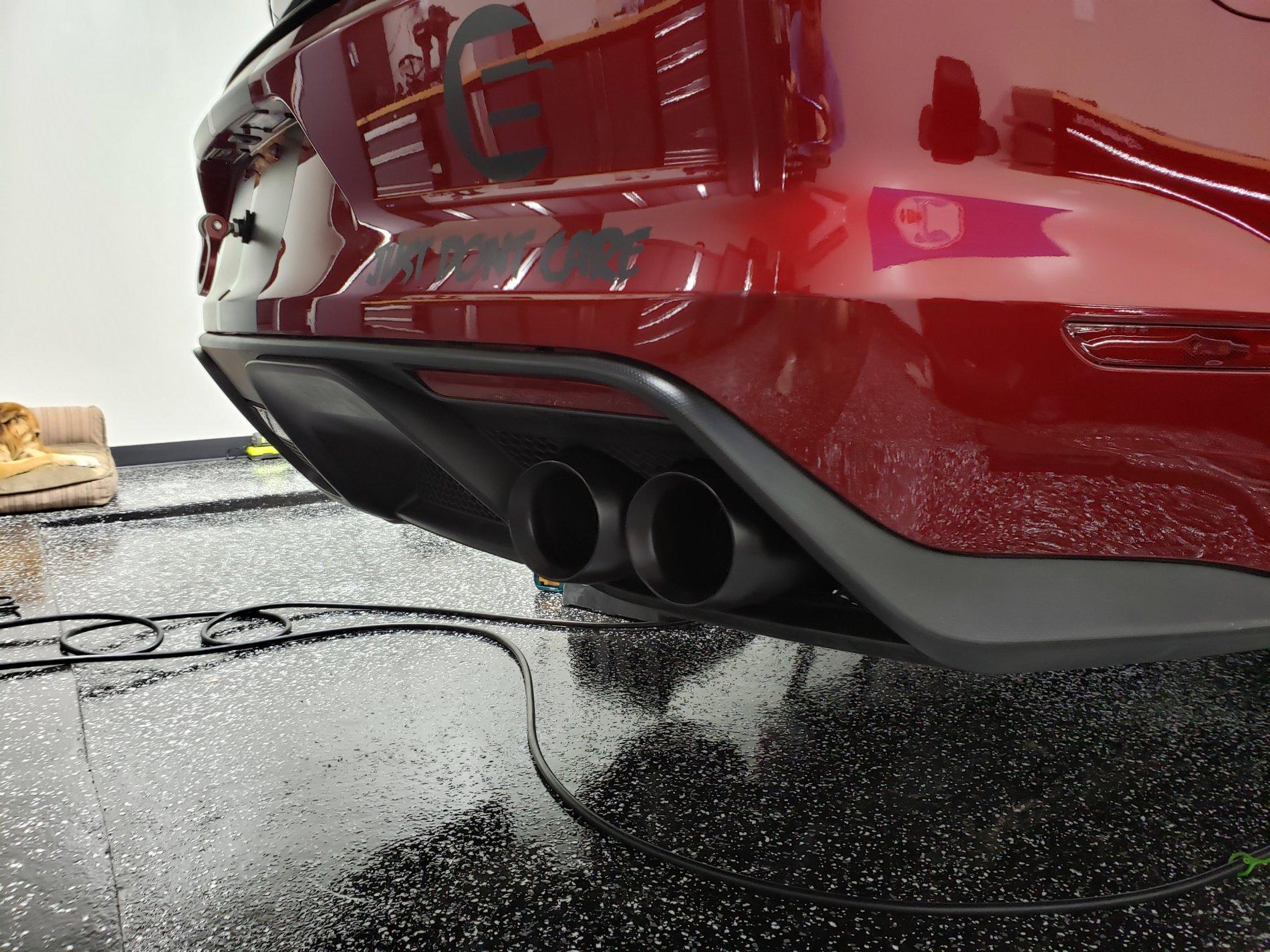

I've painted mine. I can't quite remember all that was needed, but it was quite the affair. Took a couple of hours. Will need to remove the whole valence. There are some screws on each end of it (near the mufflers) and I believe the rest is just held in by taps. You'll need to pull really hard and it's a bit nerve wracking.
Here's a pick of the tips themselves. Couple bolts and 1 rivet that will need to be drilled out and replaced during reassembly.

Did mine last winter!! You have to remove the bumper cover. The tips are mounted from the back side to the rear bumper cover
