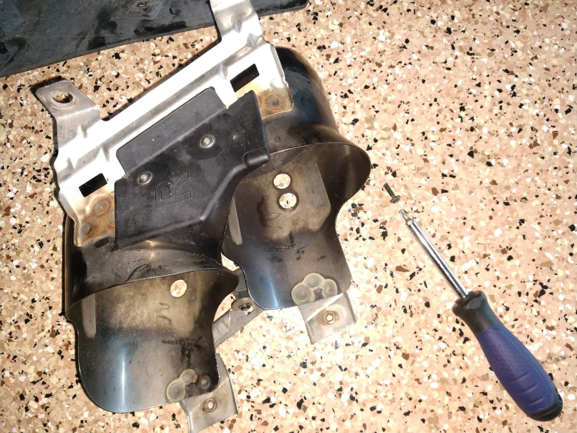

I removed all the 4 bolts and 1 hex screw, still will not come off... Are there clips as well?
There are two rivets on each side that have to be drilled out too.
I saw on another post that is not required. These in eBay does not show it removed either, looks like there is one more bolt underneath it though...

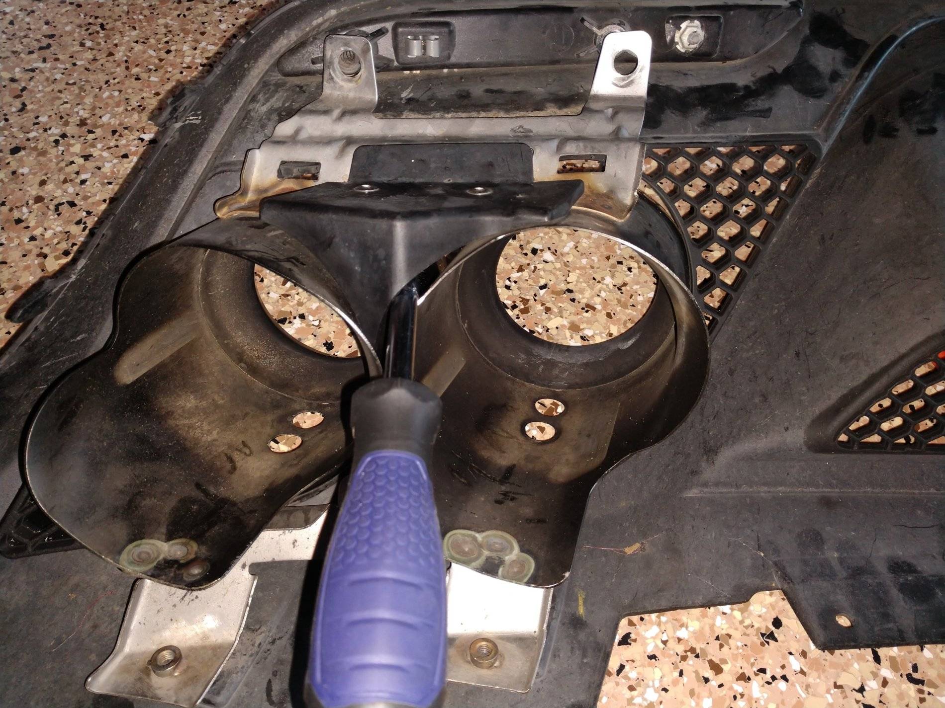

I figured is out, another hex screw under the riveted plastic cover, just pry screw driver to reach it
