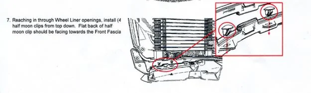

I've done splitters on three cars - '16, '17, and '18 and all had two of those white half-moon clips per side, so 4 total.

Yup, my memory officially sucks. Thanks for the correction! I went back and looked at my old pictures from my first install and it’s easy to see the location of all 4 clips.
My bad OP.

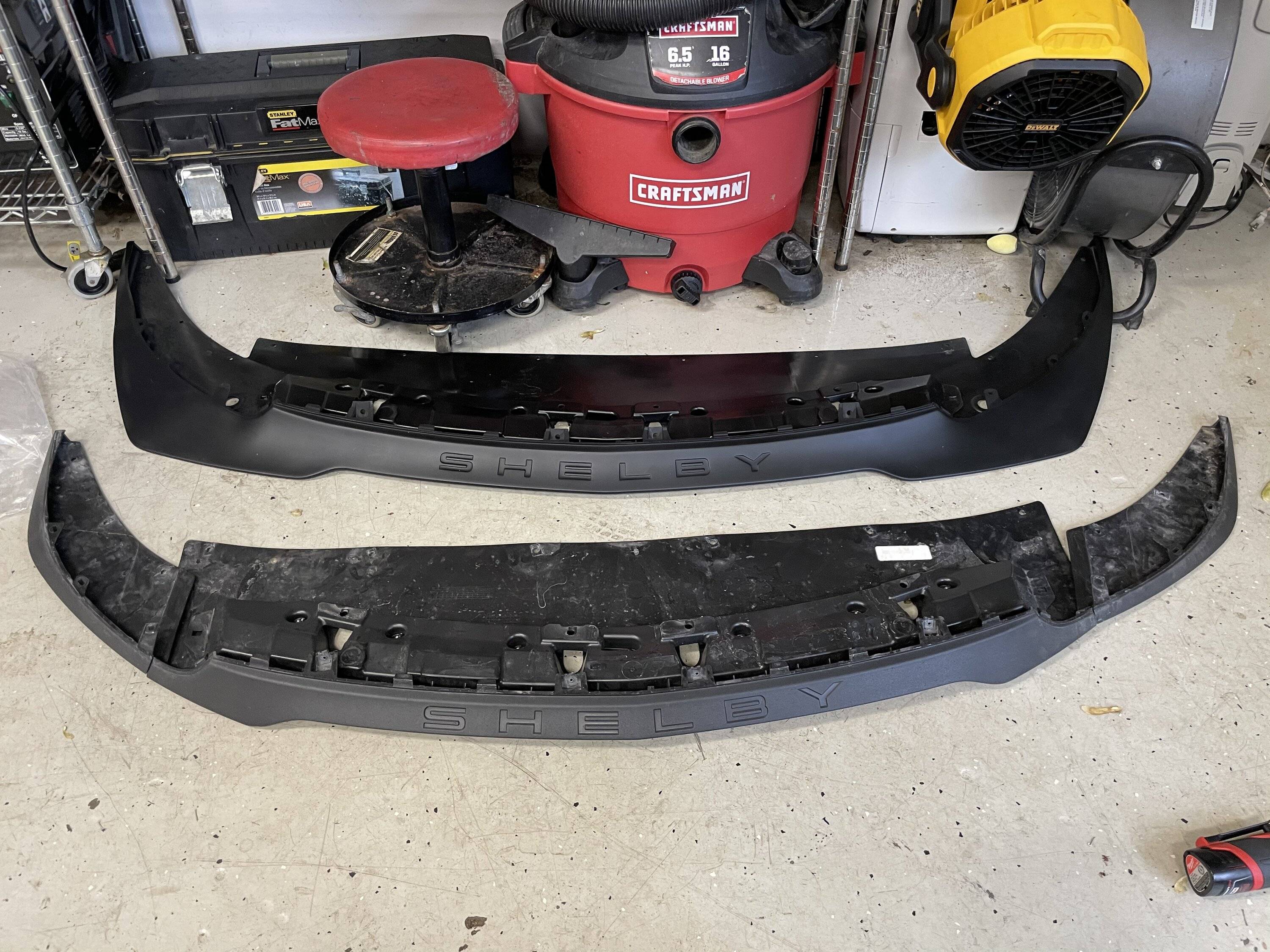

FWIW, they are really on there. The tabs referenced above that engage when installing w/ rubber mallet, they also make it difficult to pull off. I initially ran the non R splitter on my 16 and when I decided to install the R version, removing the non R was tough - and when it finally released, I was really pulling hard.
I've had my R splitter off several times. If you're positive all attaching hardware is removed and good to go, she does take a bit of a tug to get it started. Once it starts popping apart, it'll come and not damage anything.
thanks I will give it the good old tug when I get home.
