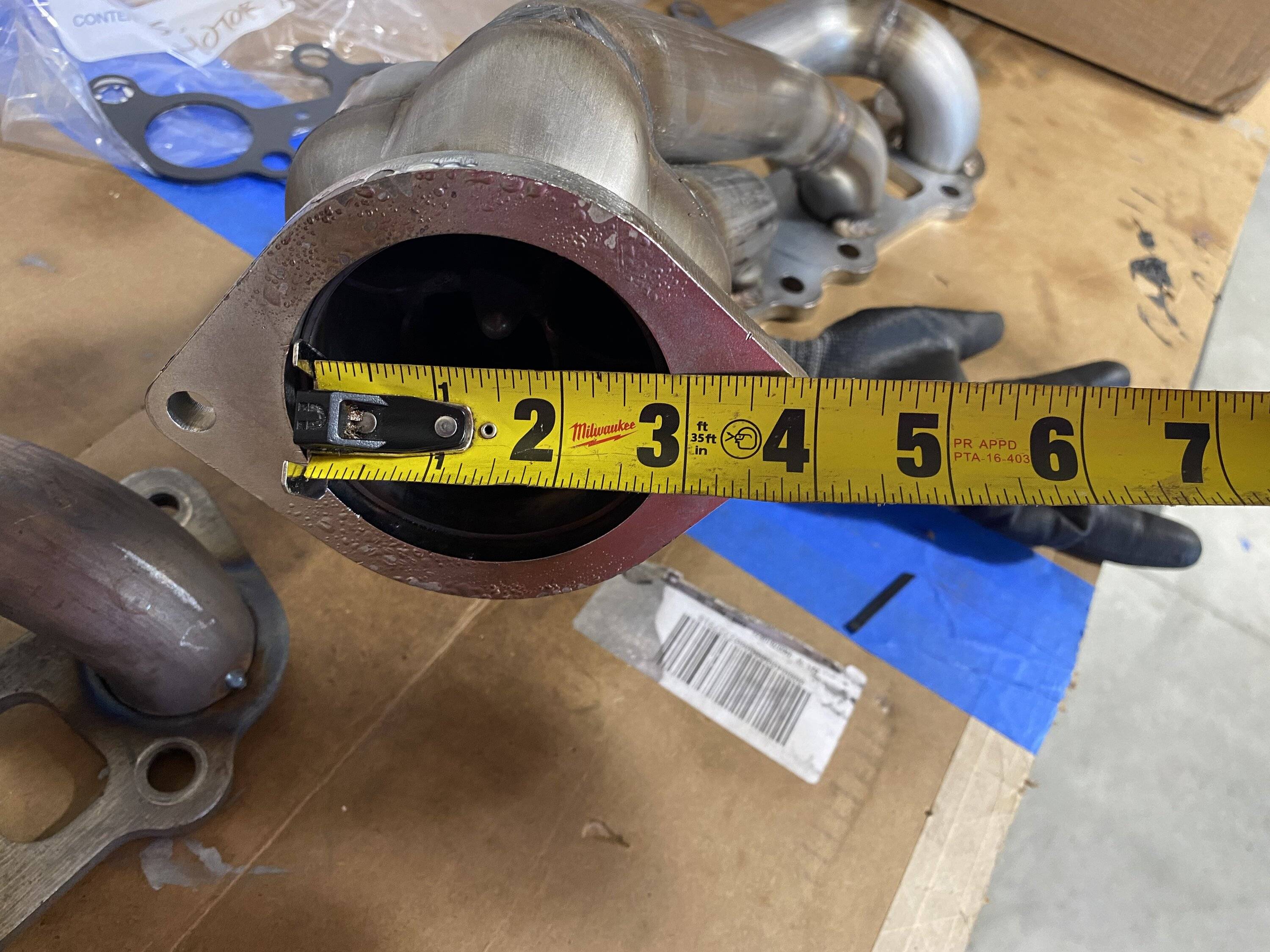

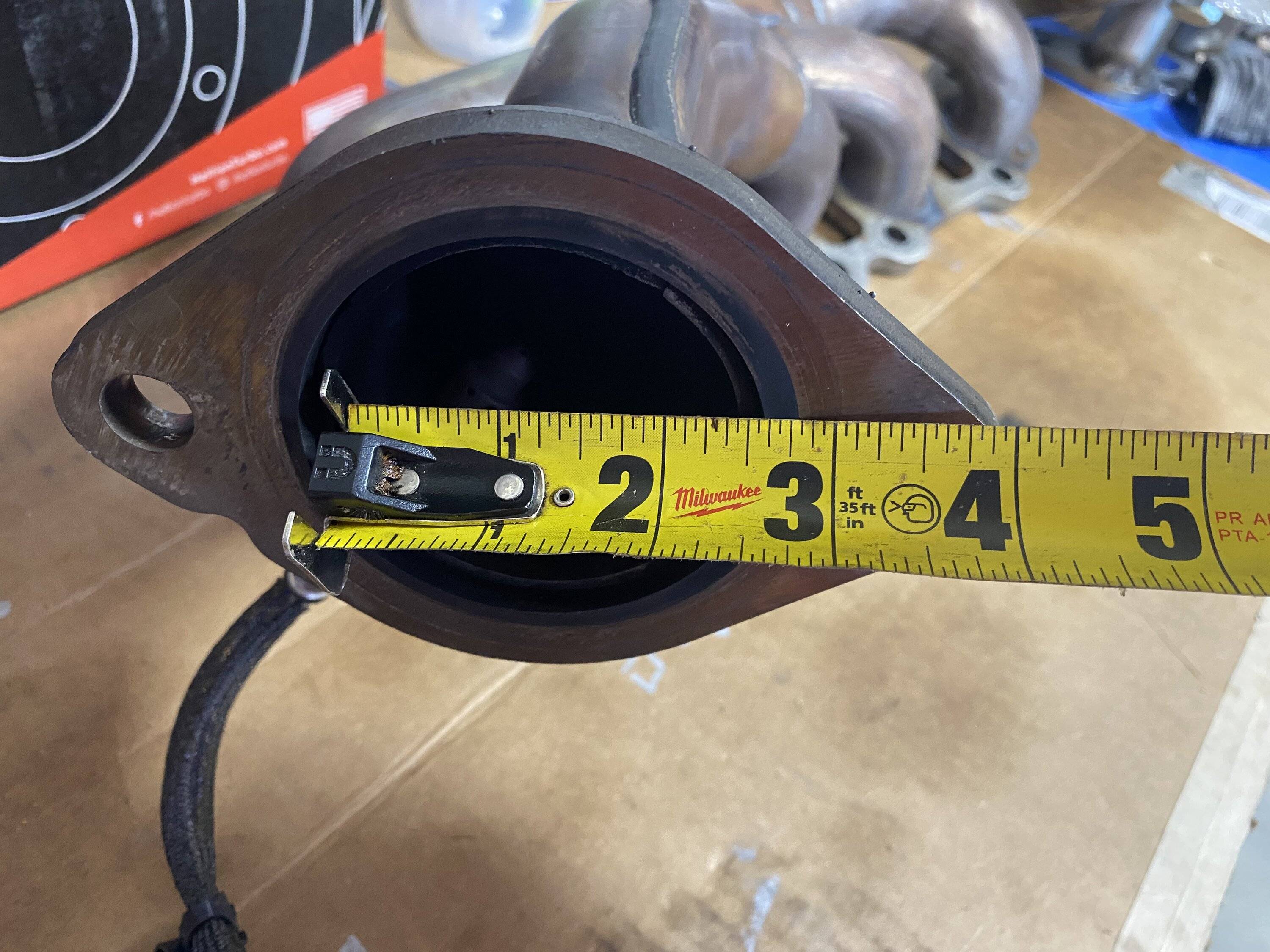

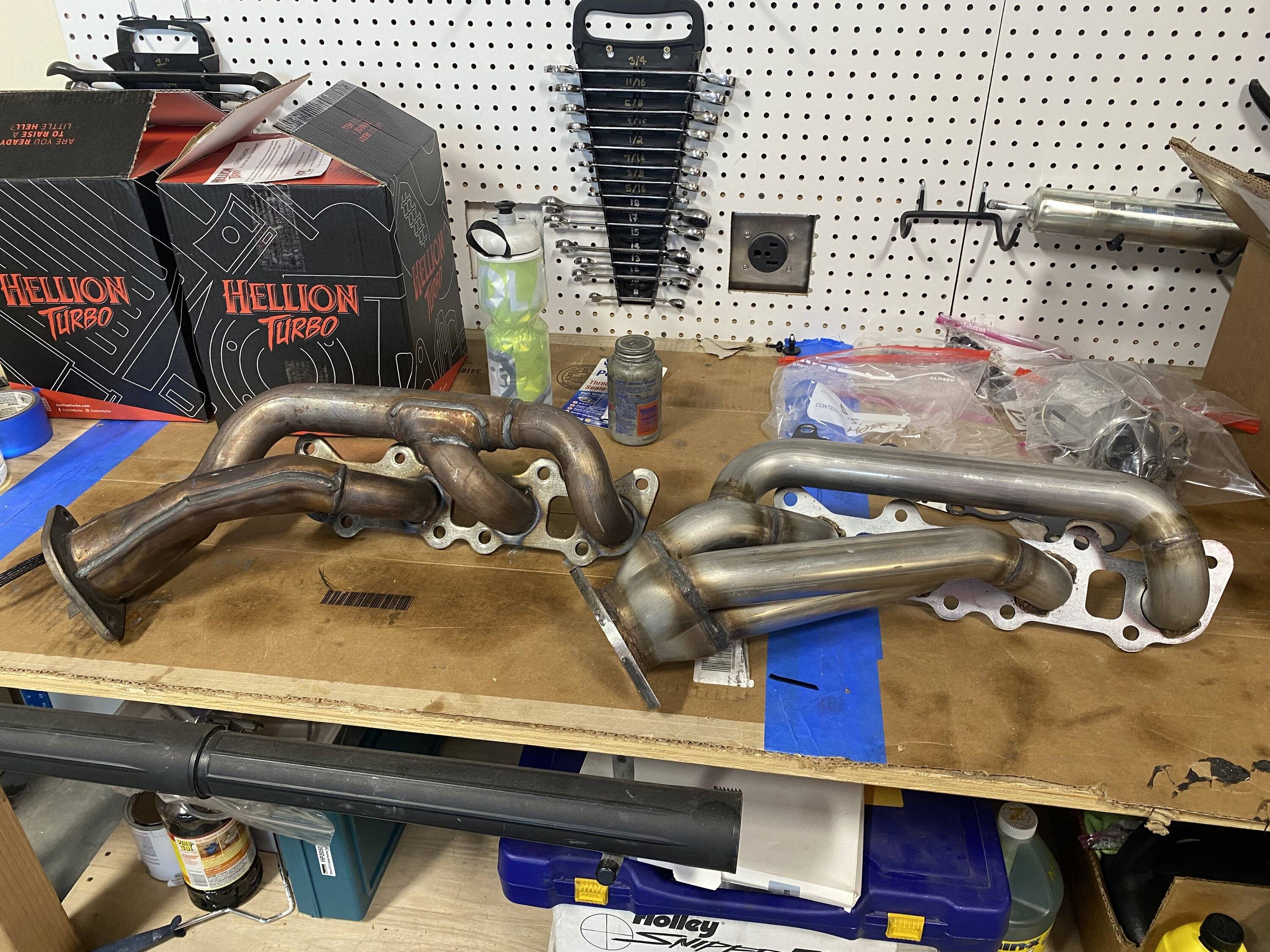

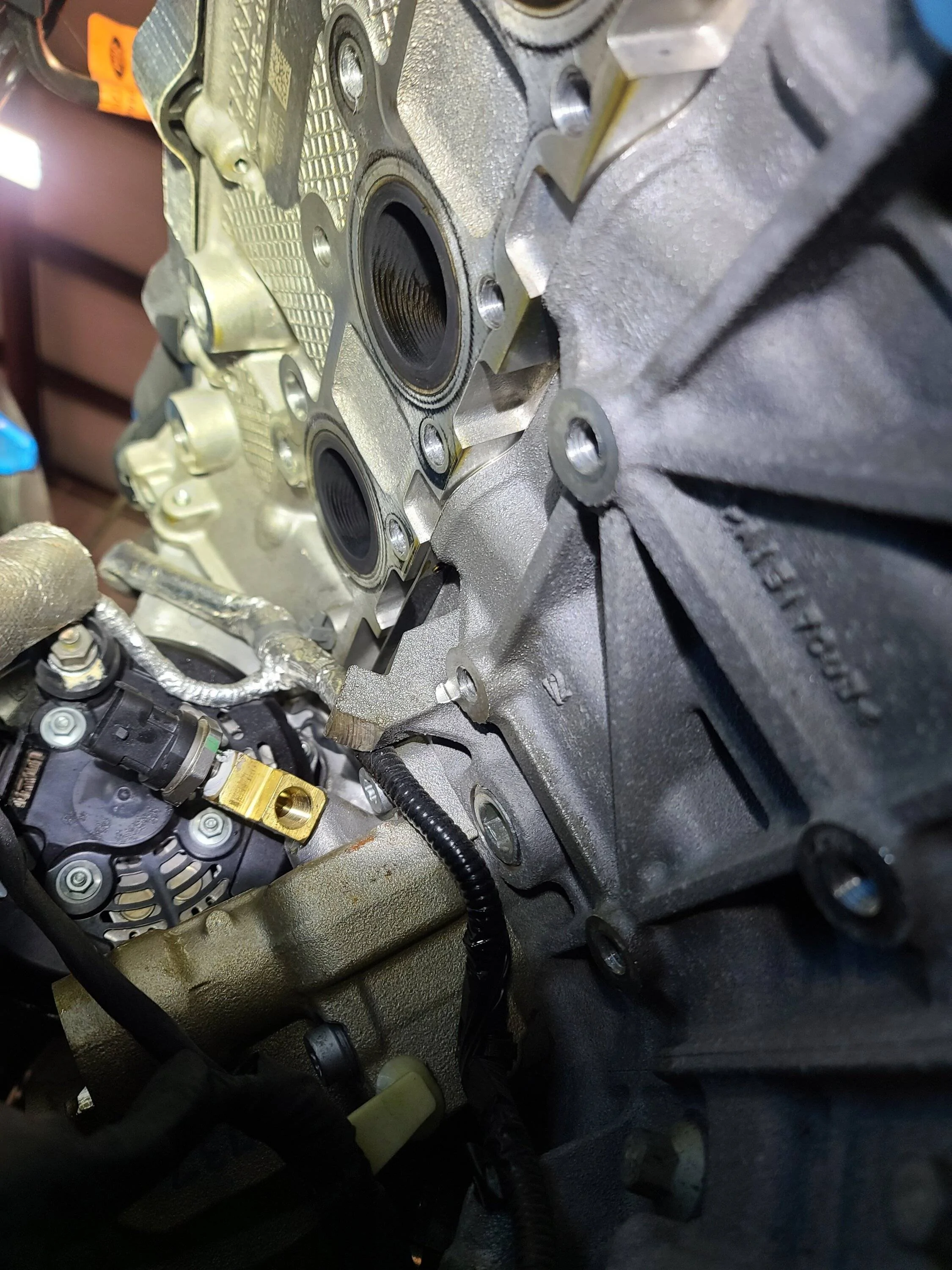

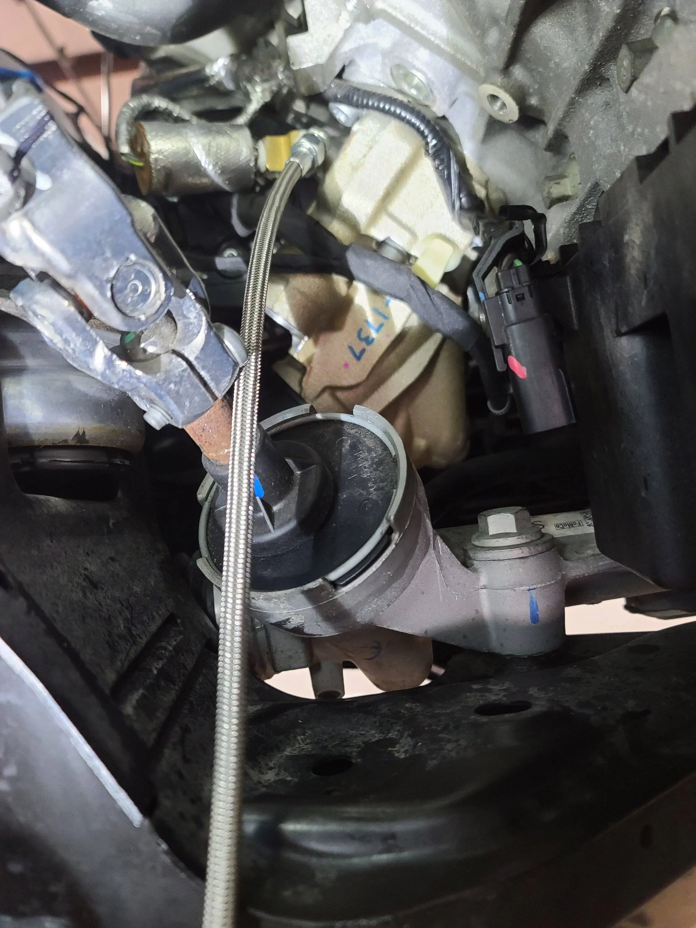

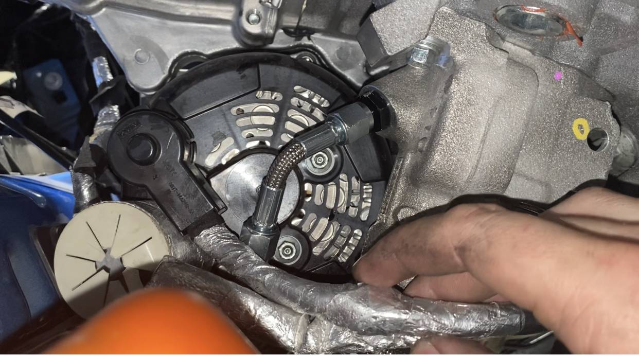

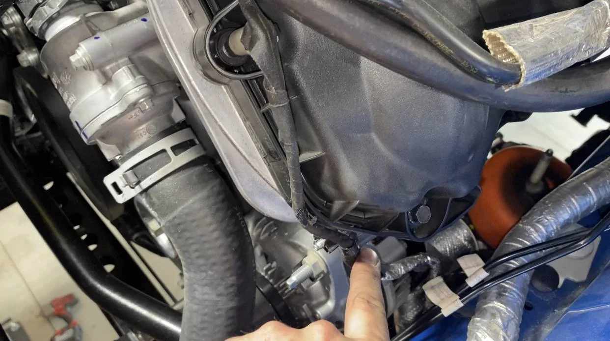

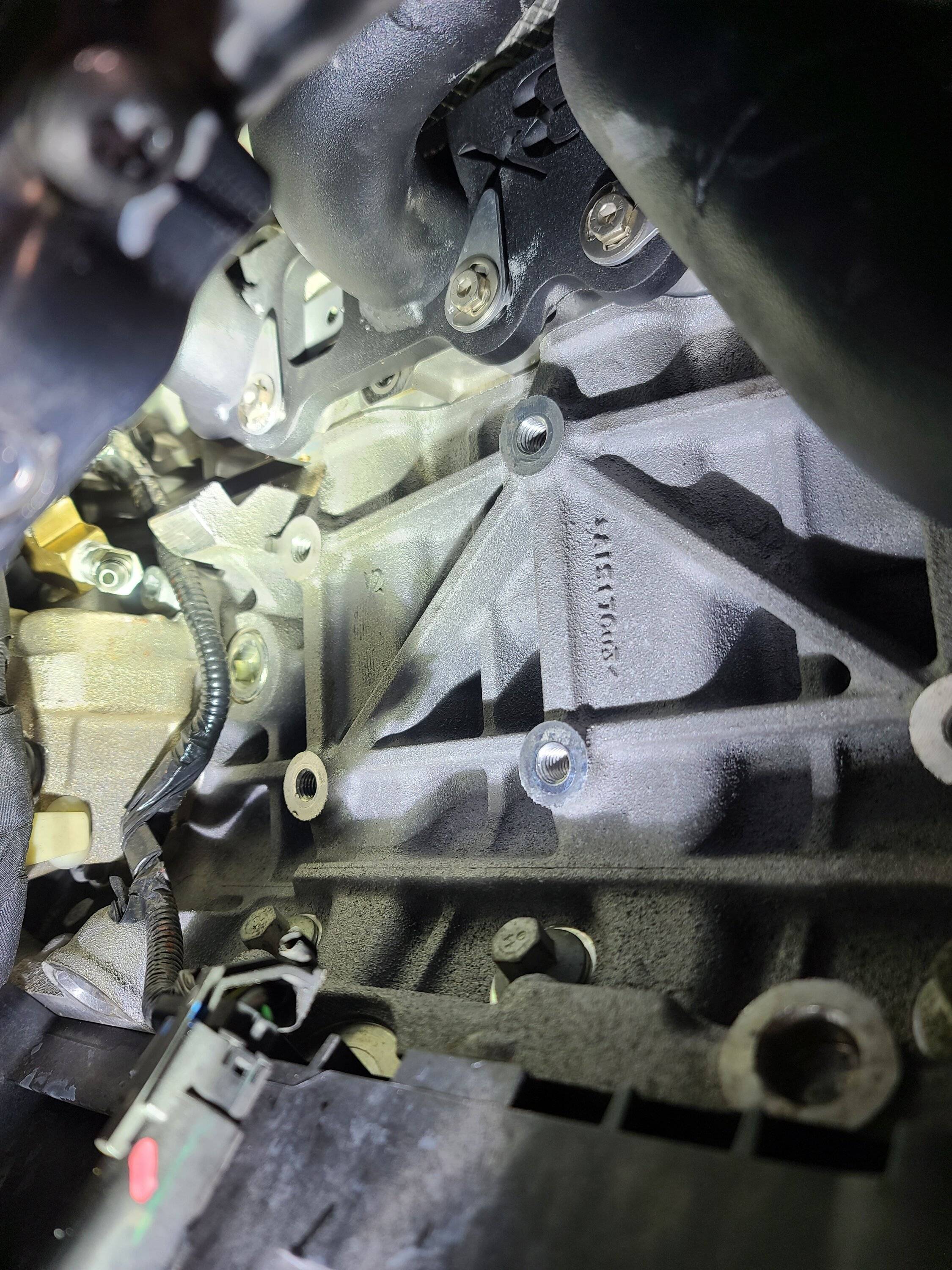

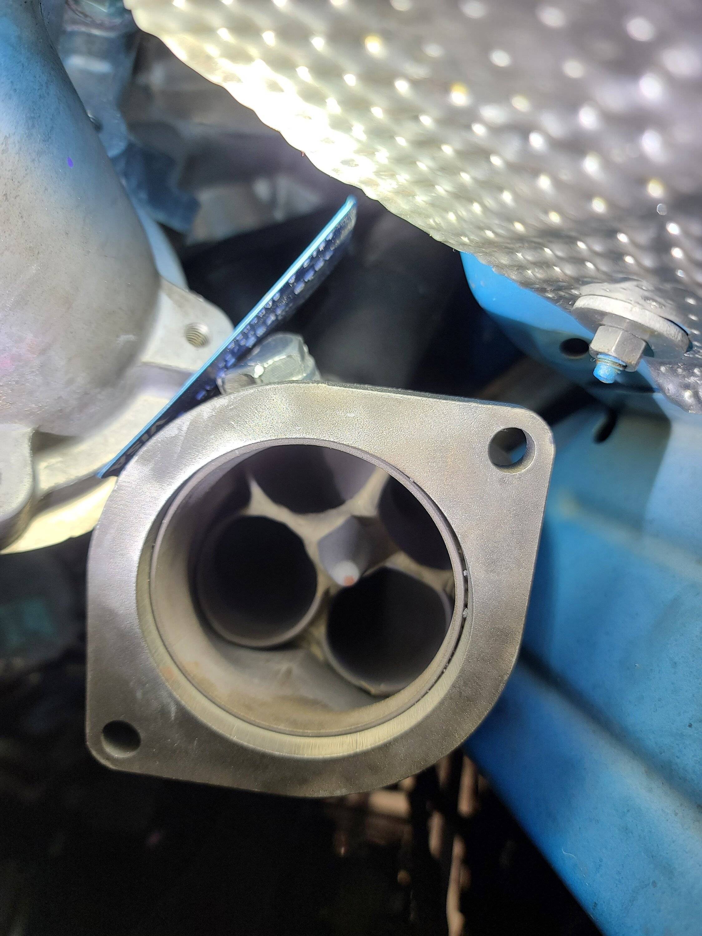

Quick update: This weekend I started to install the kit. So far I got the driver side Hellion 4 into 1 header installed, oil feed installed, and passenger side header in place but not tightened. I definitely learned a few things. First the instructions are lagging a bit. Looks like the oil feed connection has been updated. This requires you to re route the oil pressure sensor wiring a bit. Second header bolt access is a PIA. I wound up having to pull 4 manifold studs on the passenger side to get the factory manifold out. I pulled the starter too for more access. Here are some pictures comparing the stock pass side manifold to the Hellion 4-1. Note the larger collector diameter and smoother transitions vs the stock style.

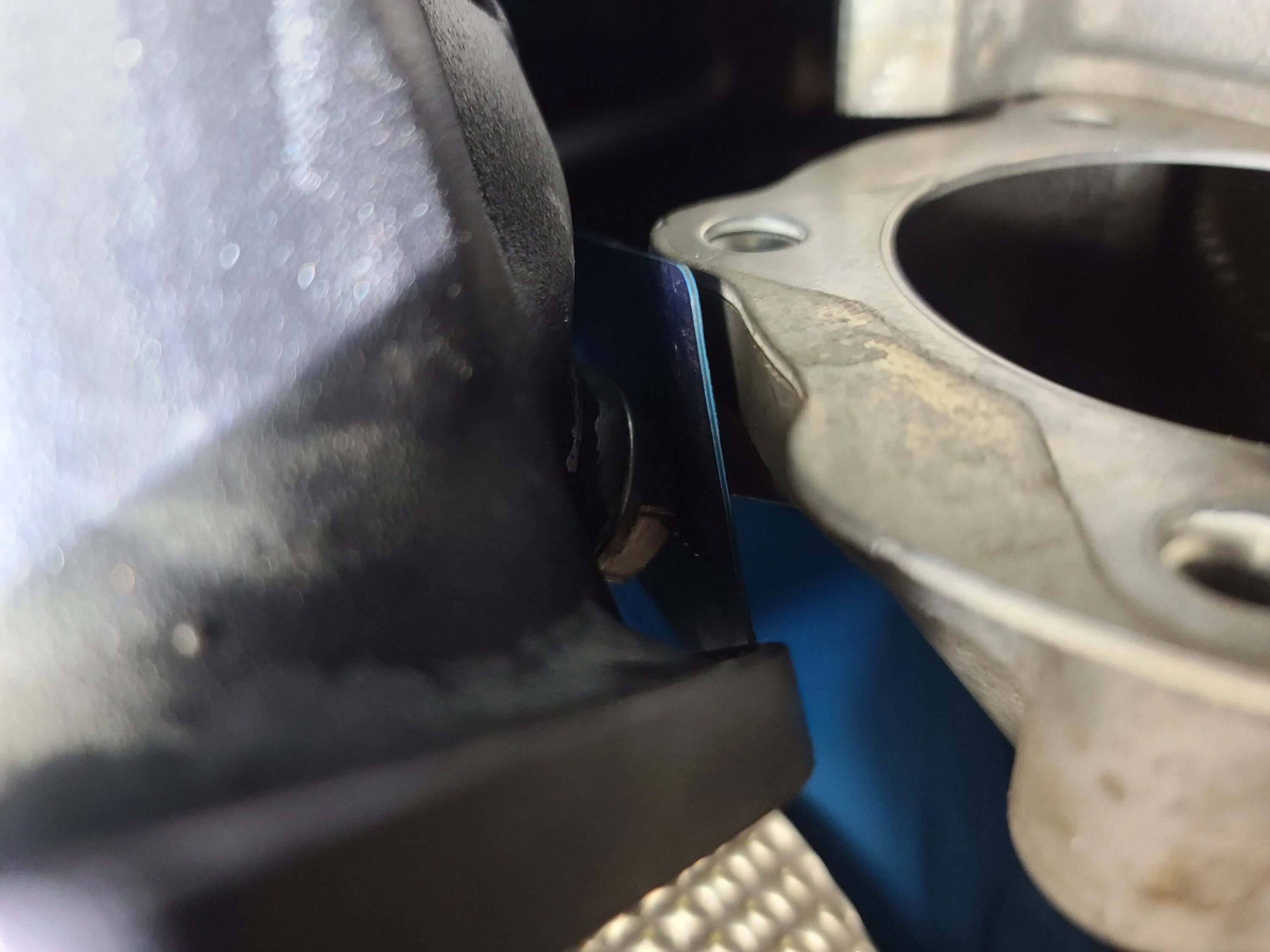

you might have to grind down on the o2 sensor block off on the pass side I had to on my gt350 using the 4 in one headers also I took all the studs out and went with the stage 8 locking bolts made install way easier

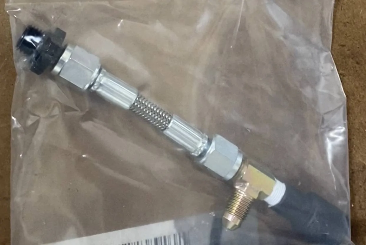

Thats good to know. I just got them mocked up on that side with a couple of studs in and a nut partway tight to keep the header from falling. Ill have to take a look and see. When you did yours was the oil feed somewhat janky? Mine is multiple pieces together (i.e., adapter for onring fitting, SS hose, tee, another adapter, etc. I undid the oil pressure sensor wiring and re reouted it on the other side of the alternator.
did not have to reroute conector don't know if there is a difference between the 350 and mach 1 sensors or harness

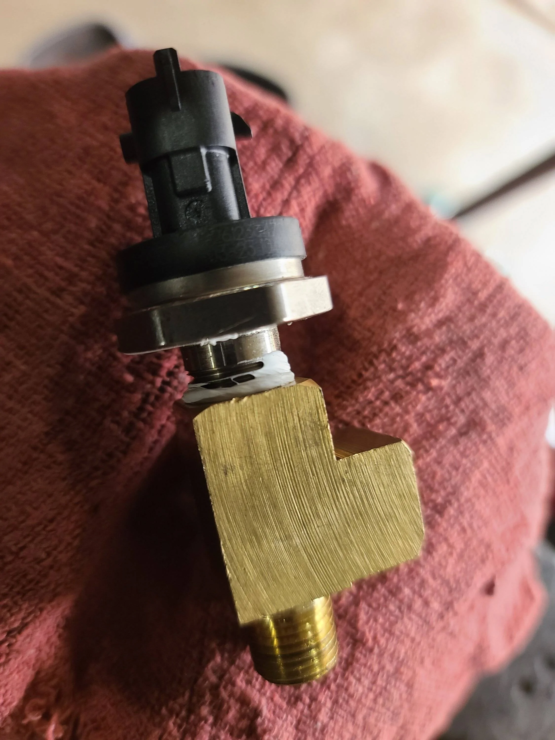

So maybe they changed the sensor style for the Mach 1 (or its a model year thing). I also noticed when removing the starter mine appears to have 3 bolts vs. 2 so apparently some minor changes. Heres what mine looks like (I prefer your setup)
all starters are 3 bolt but yeah not a big fan of how they set that adapter up but it looks like the mach 1 has metric orb threads where the gt350 Is a pipe thread for the ops
