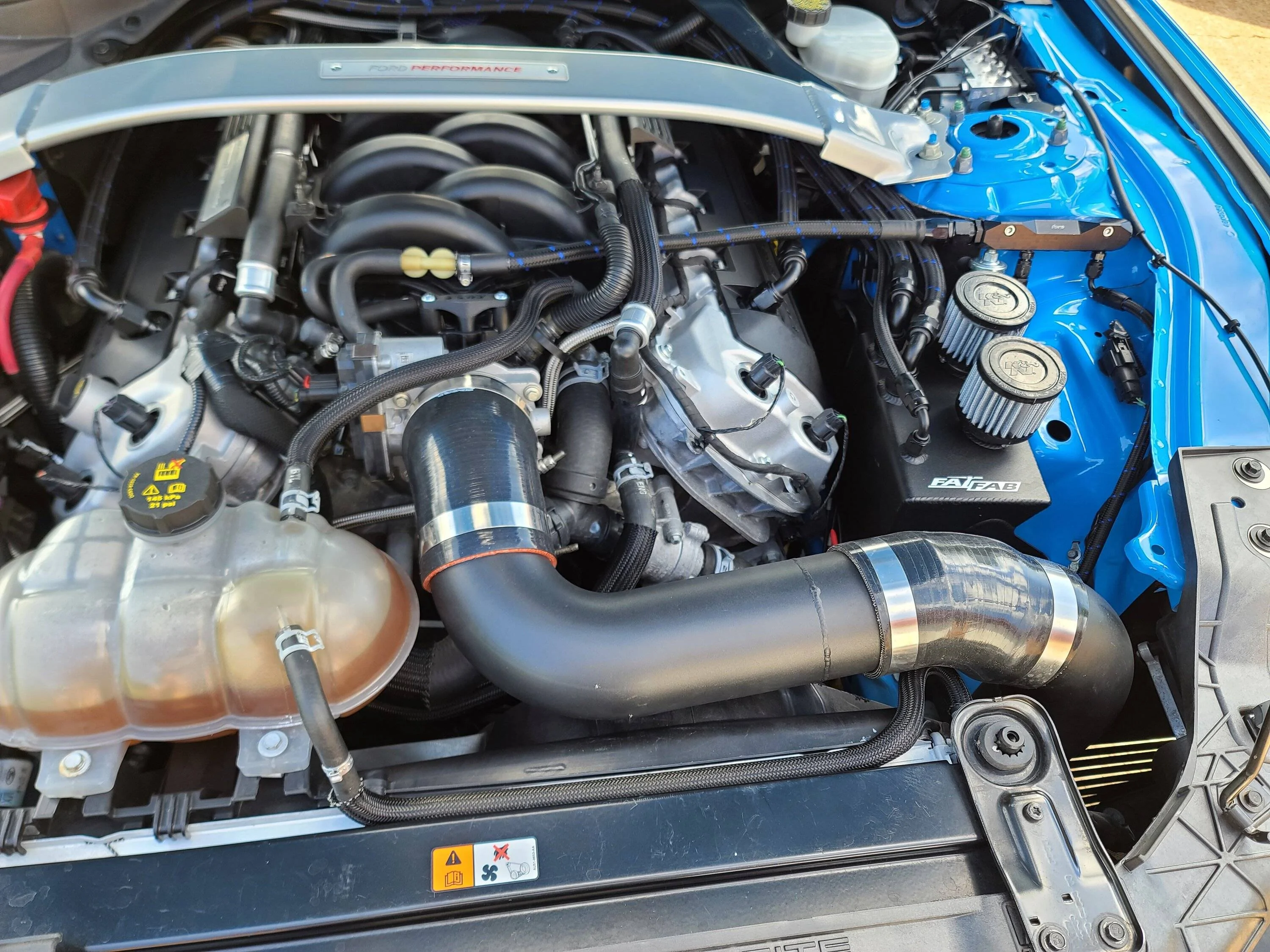

I called hellion about the tb coupler on my 350 and they ended up sending me a 3.5 to 3.75 coupler also I had the same problem with the 90s at the bottom of the intercooler and the top but mine was a 6 inch so idk if it made the problem worse being a thicker core I ended up using the top 90 and cutting the charge pipe to put a 45 in it so it would not be hitting the small hose that goes from driver side top radiator to the degas bottle
That is definitely one way to do it! I know EXACTLY what you mean about the degas bottle hose. Fun fact mine leaked from the factory at both ends after like 300miles. Keep an eye on that. My charge pipe fits well it just needs to be a bit longer. I am hoping the new reducer I receive fixes the issue.

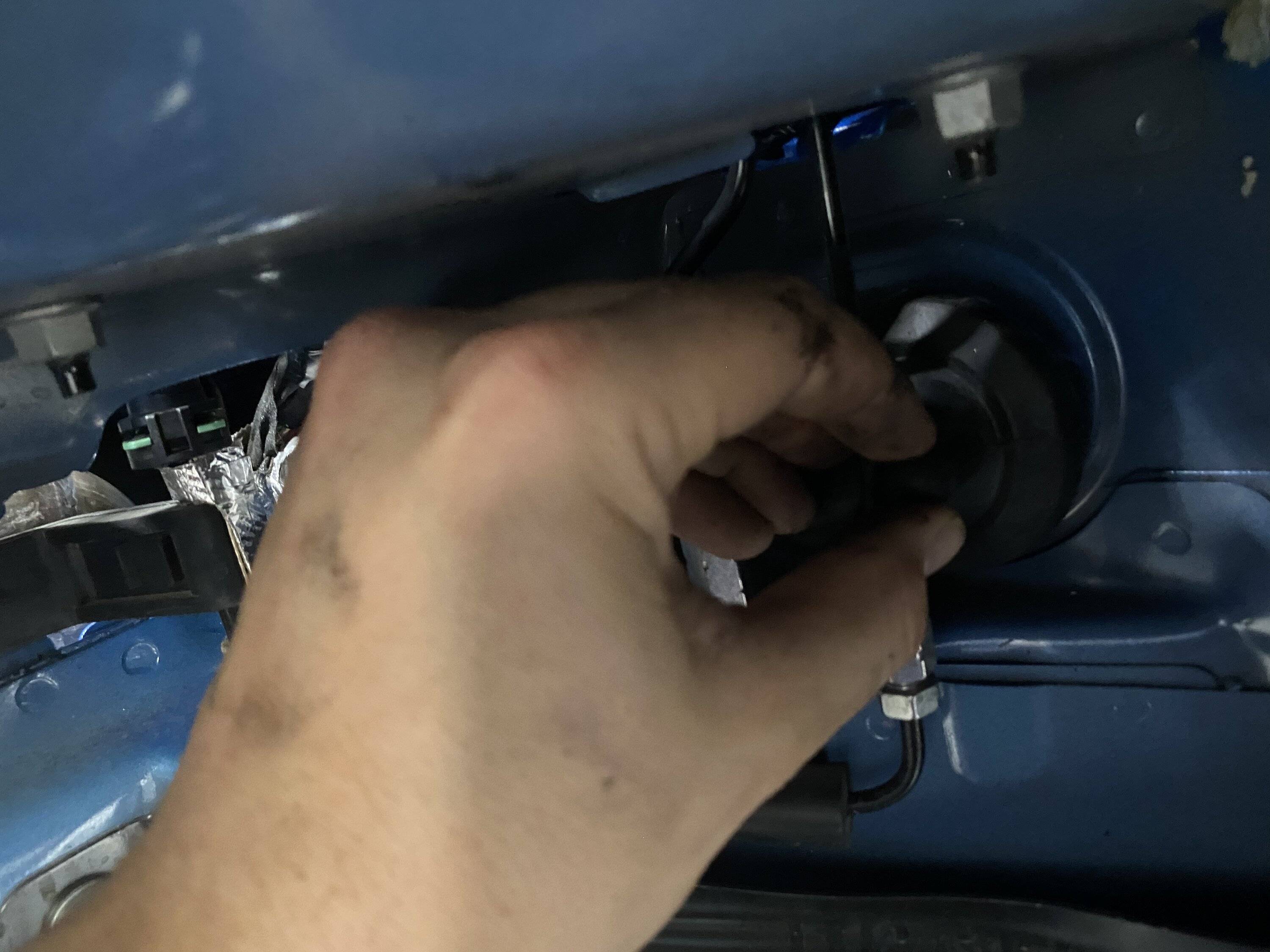

Figured Id post this in case someone was curious. If you are looking to pass wires through the firewall without drilling holes here is one way to do it. On the drivers side footwell theres a pass through that has an extra unused nipple. If you remove the splash guard in the wheel well you can see it. You can poke through this grommet by removing the little nipple and sneak wires through. This is how I got boost + power to my solenoid/boost controller.

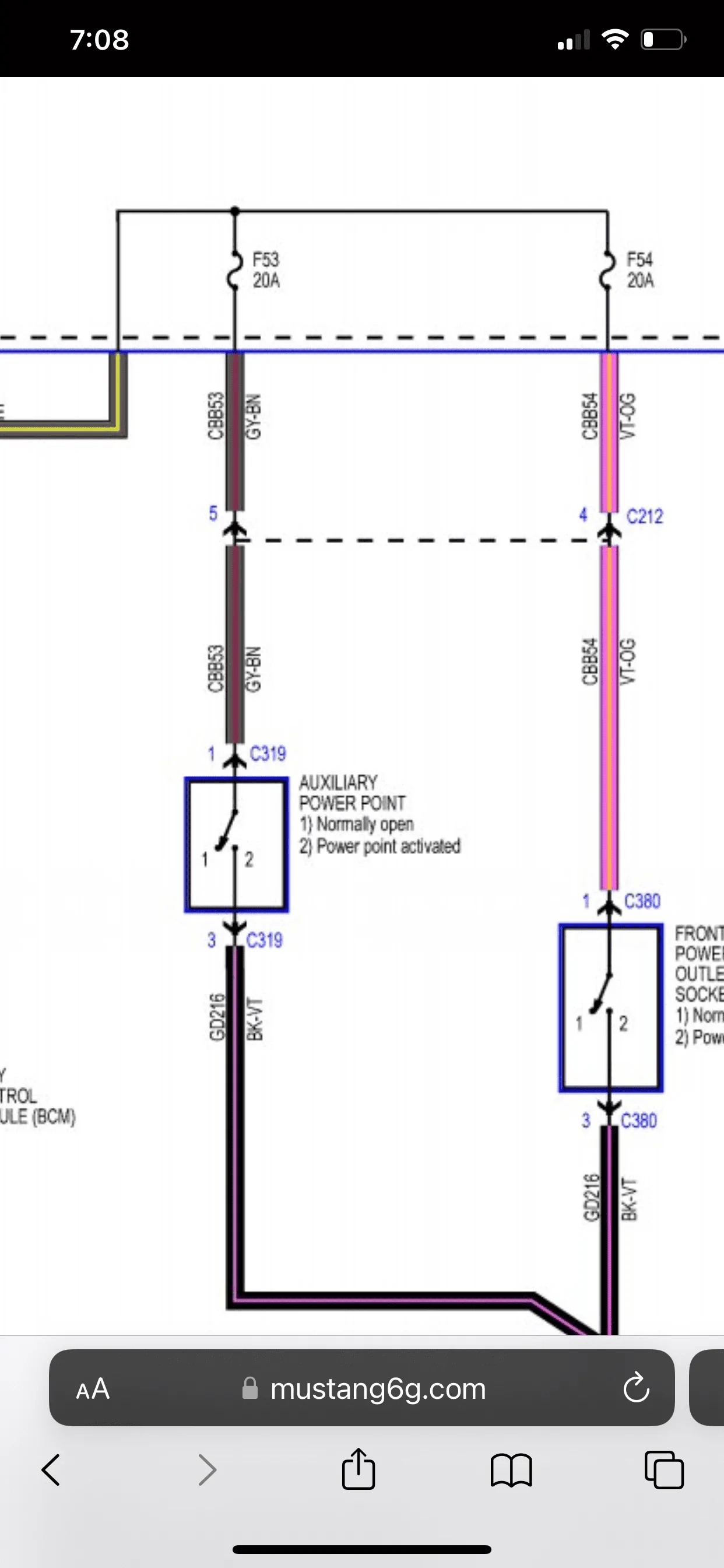

One more thing. You can tap into the cigarette lighter outlet in the console so you dont need to run a wire back to the fuse panel for your hot + ground. Ive also attached a wiring diagram. I may pull/replace fuse F53 down to a 5a to better protect my boost controller.

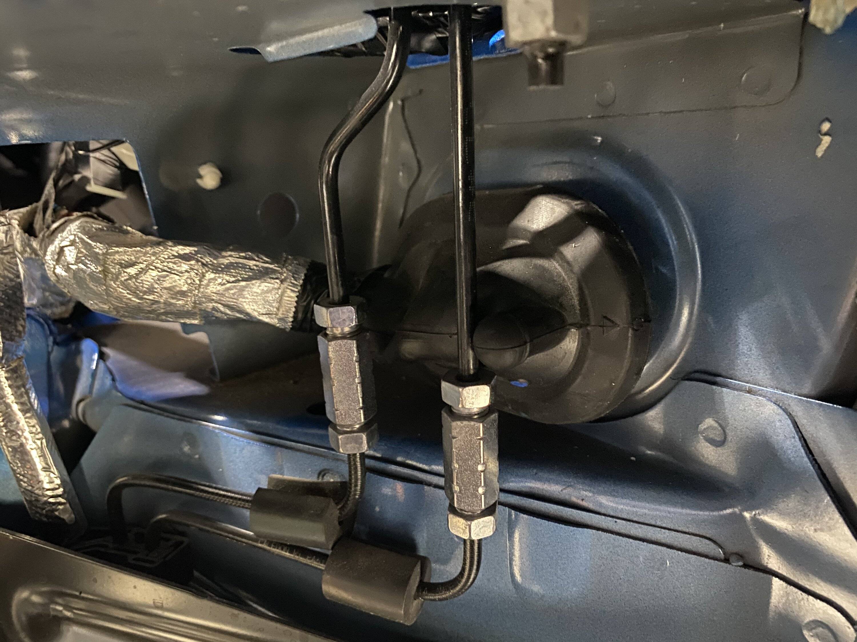

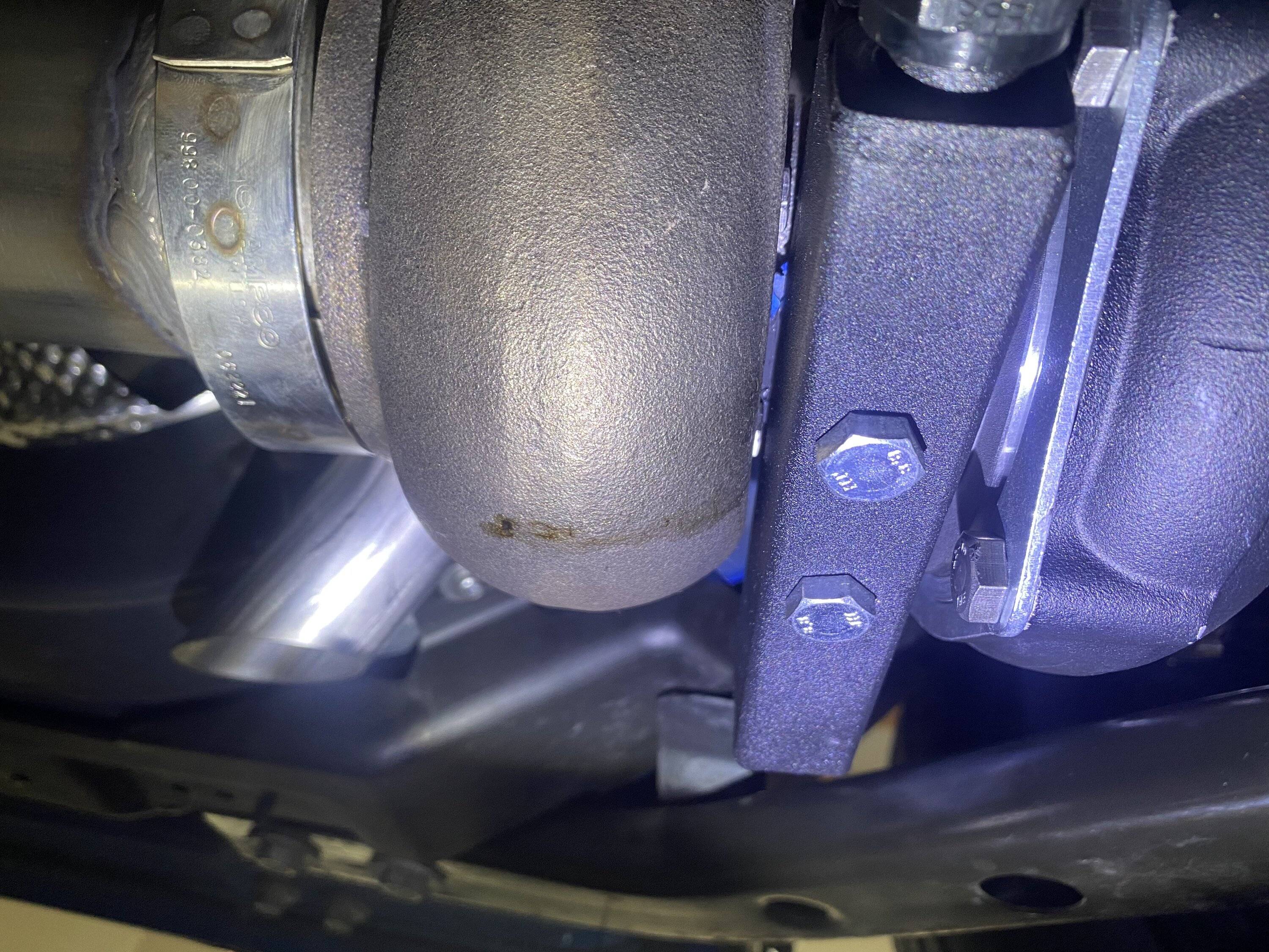

Started the car last night and did my baseline datalogging for Lund. They tell me it looks great and have instructed me to do a pull on wastegate from 3-6500rpm. I am both excited and nervous. I will need to configure my boost controller so it doesnt add boost and ensure there is some over boost protection. Only issues I ran into were one which was my fault and another which hopefully goes away?
First, I forgot to cinch down the oil supply lines which leaked on startup. Once tight we were all good. I am seeing some oil drips which Ive been told by Hellion is normal
“That is just assembly oil and condensation combining to run down the housing from the turbine/backplate connection most likely…”
