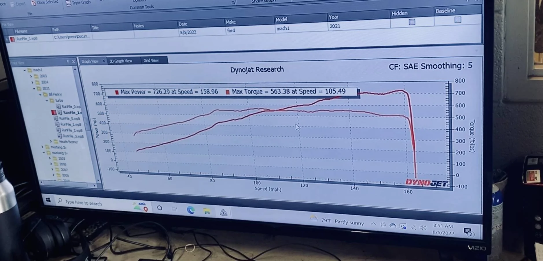

This past Friday I got it on the dyno here at a local shop (Premier Performance) in SLC, UT. As I believe I mentioned before LUND completed the tuning remotely We started off the day by seeing how the car did on 91 octane pump. I was somewhat careful prior to the dyno day to utilize only "name brand" gas stations (i.e. Chevron, Marathon, etc.). The first pull at around 7psi yielded 726rwhp and 563ft-lb. This was just straight 91. Both my tuner and Lund took a peek at this data and concluded that this was "about it" for pump gas. We did a few more back to back pulls and saw some varying data (likely the knock sensors adding timing). I believe the best on straight 91 was 740ish.
Here's a graph of what I believe was the first hit. Boost was likely between 6.5-7.5psi
The tach signal on the dyno was giving us problems. This car has oil pump gears. Initial pulls were in 5th gear (Tremec TR3160 1:1) to 7500rpm. We eventually ran it out to 8000rpm later and got the signal to pick up.

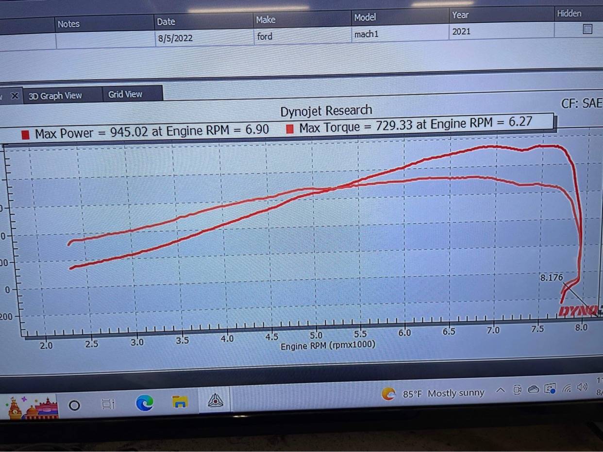

This is when we clicked off our first 900+ whp pull. I was astounded. I think we made 905/666!! We sent the file to Lund and he added some fuel up top and said run it again.
Here was our best of the day and where we all decided to call it quits.
Again I'm blown away. Don't worry I plan to drive this car on the LOW boost setting unless I'm racing and likely that will be with some dedicated gas like 109 or 110 in the tank to yield in the low 100s on octane for safety.

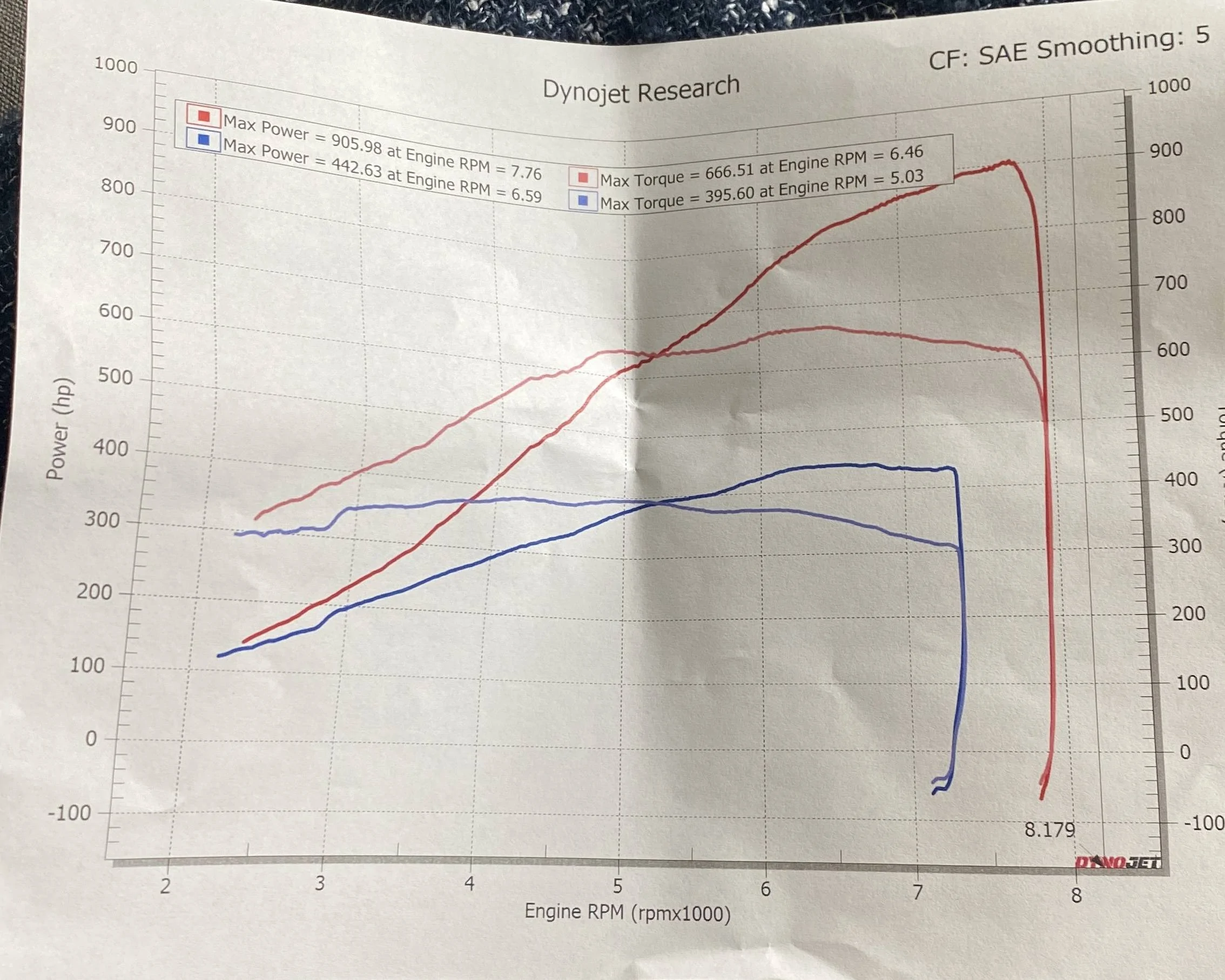

Here's one more graph showing baseline dyno (stock minus a C&L resonator delete on 91) vs. high boost 100octane

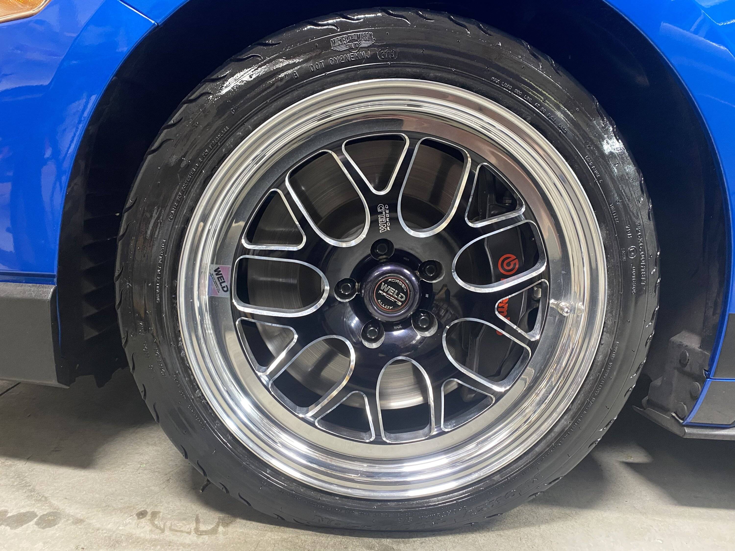

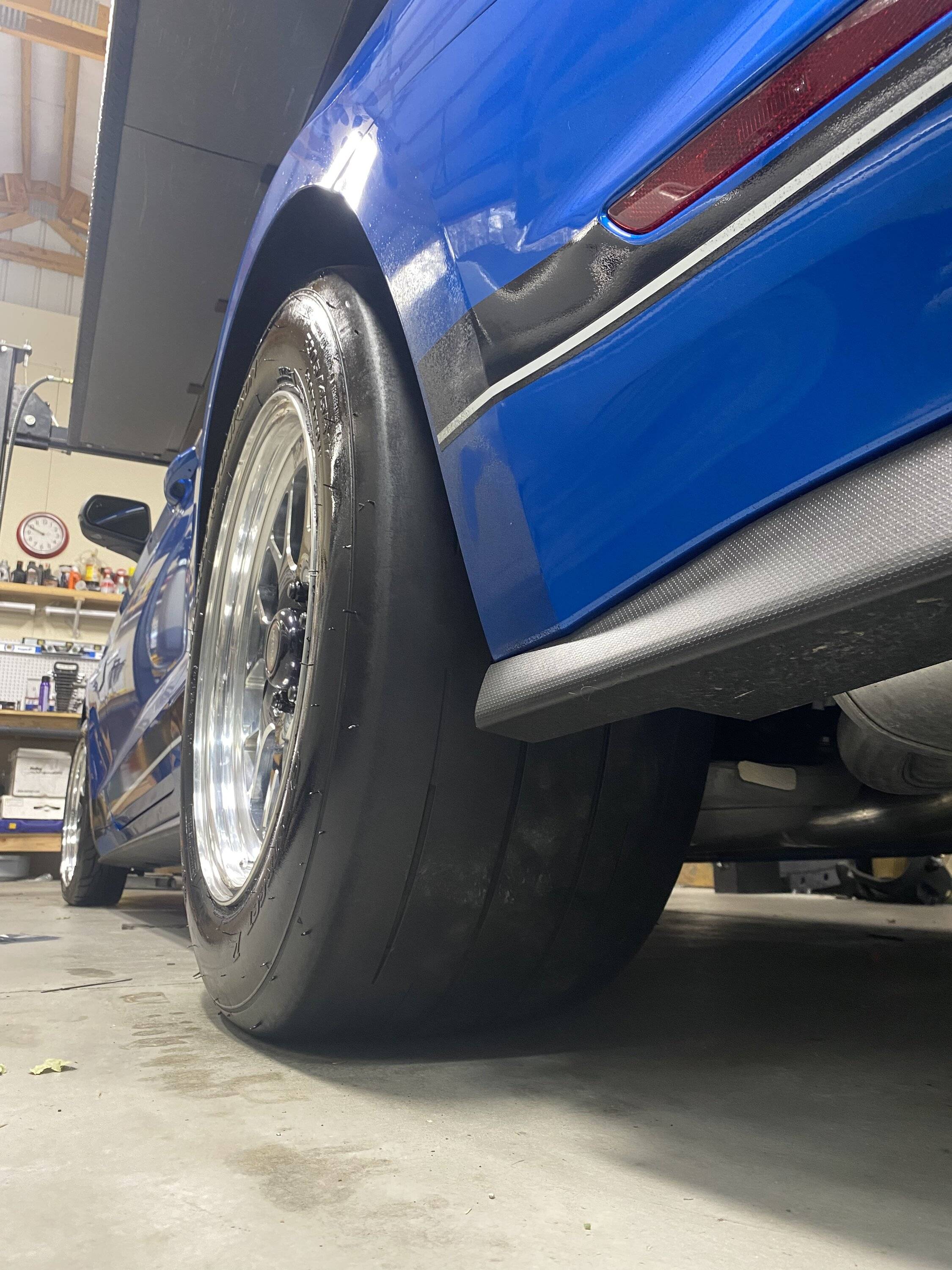

Got a killer deal on some Welds from a local guy. I wasnt initially planning on going full drag pack but this was too good to pass up. I cannot wait to try out the ET Street Rs.
Awesome car man!
Some advice for you! I am running a built GT with the upgraded Hellion TT kit pushing around 1000-1200 depending on boost settings. Lund tuned also.
You will most likely need to start looking at some suspension mods to support these power levels. I am still not perfect on getting mine to stick on a preped track and I have tons of suspension mods. But I blew up the last engine while dialing the suspension in.
Also why not switch over to E85? Much better fuel and MUCH safer when running that kind of boost.
