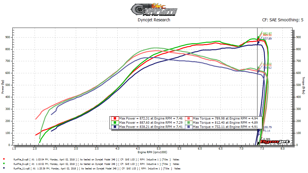

Here ya go. Mod list in sig. 15, 14, and 12 psi. Stock springs and motor. Lund told me the dip at the top of the power band on 14-15 psi may be valve float but they didn't say for sure.
