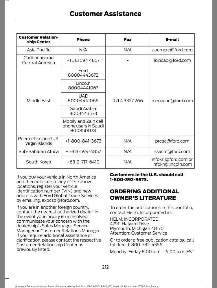

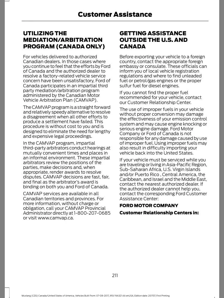

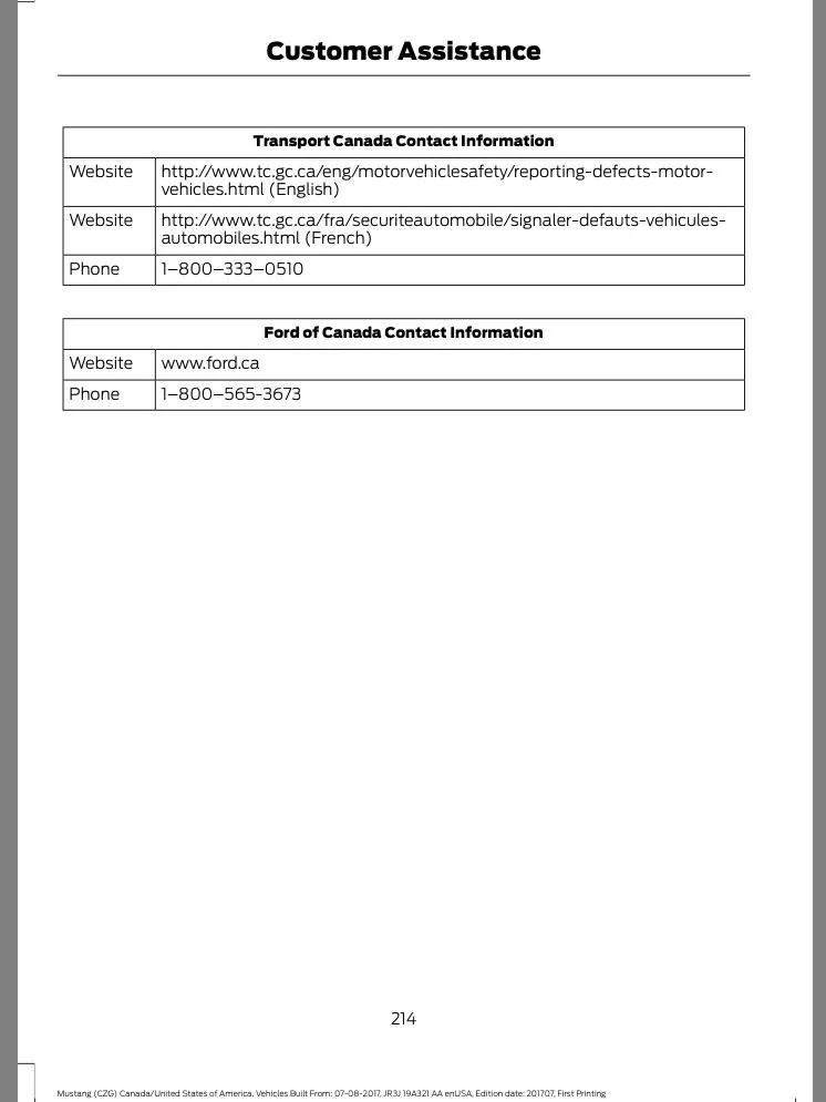

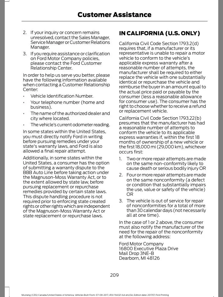

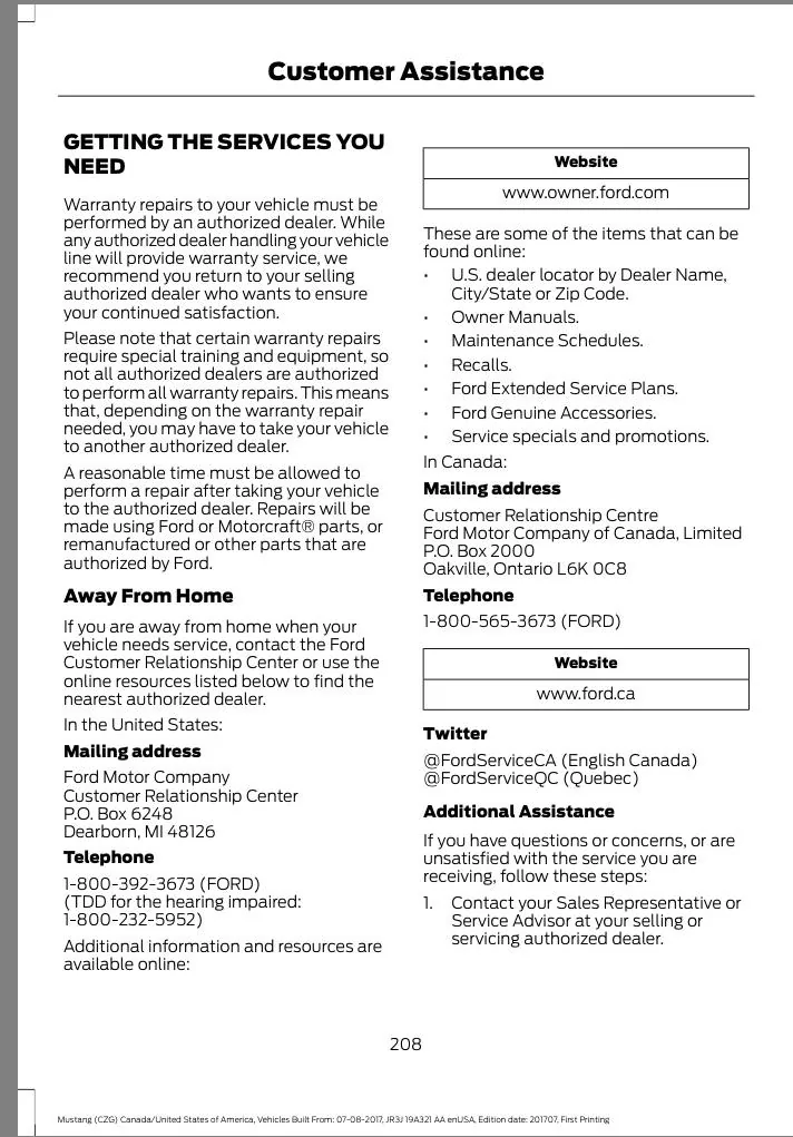

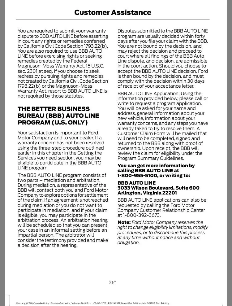

I'm going to call ford a file a complaint. Who do I call? Or anyone have a contact number?
Thanks
Cobra Jet
Feb 12, 2015
771
17,612
20,073
Thanks
Here ya go - all the Ford Customer Service info you should need:
