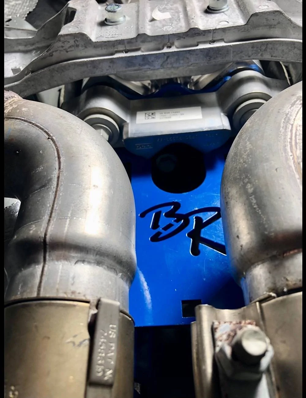

Correct me if I'm wrong, but was this because the shifter was not mounted to the transmission and body flex was the problem?
Sevensixteen
Feb 1, 2020
139
288
New jersey
Brian
2020 mustang GT, MT-82, 2024 Bronco, Big Bend, SAS
I always thought that goofy design didn’t made any sense, added the blowfish mount & I haven’t had any issues since
