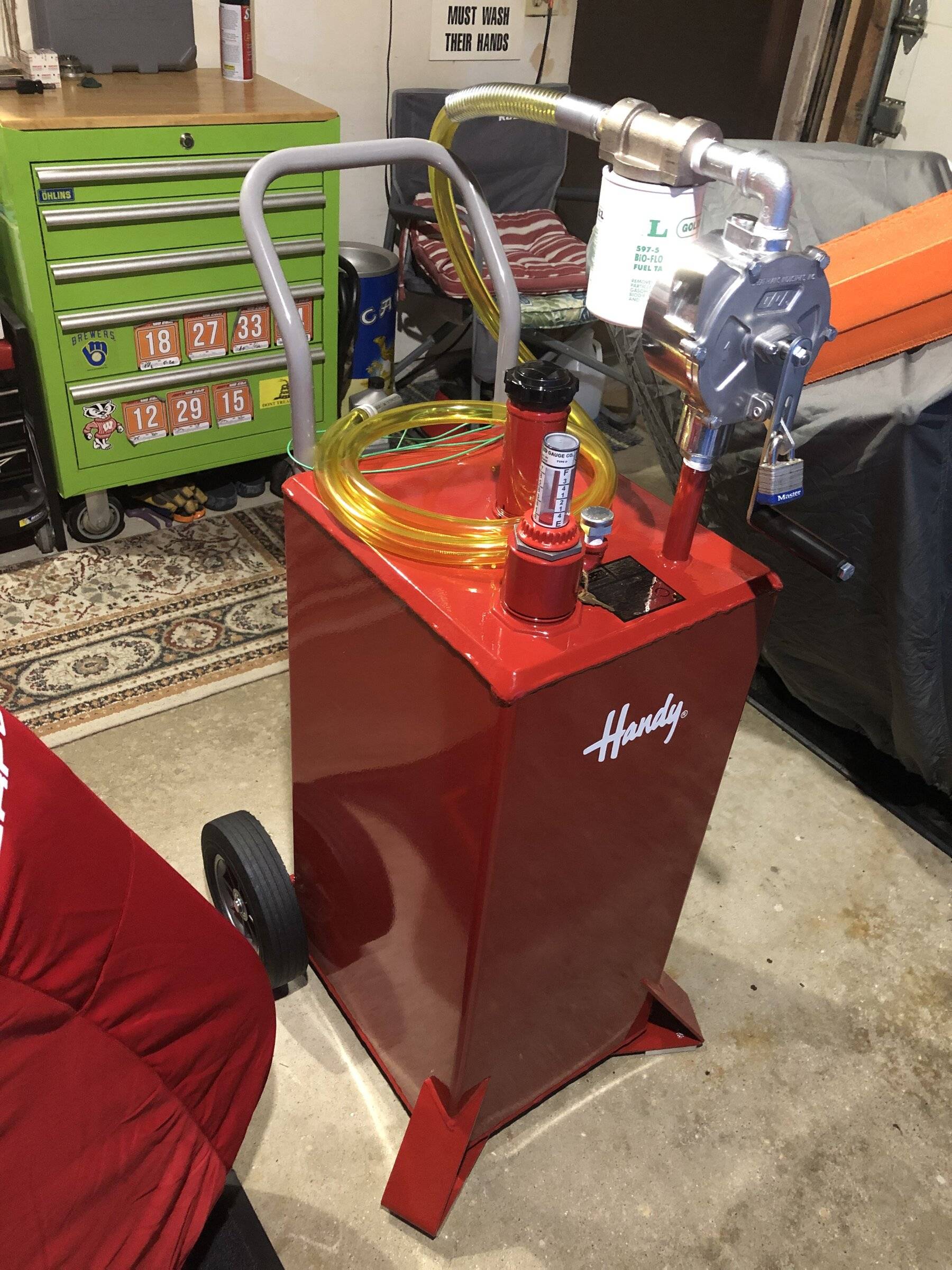

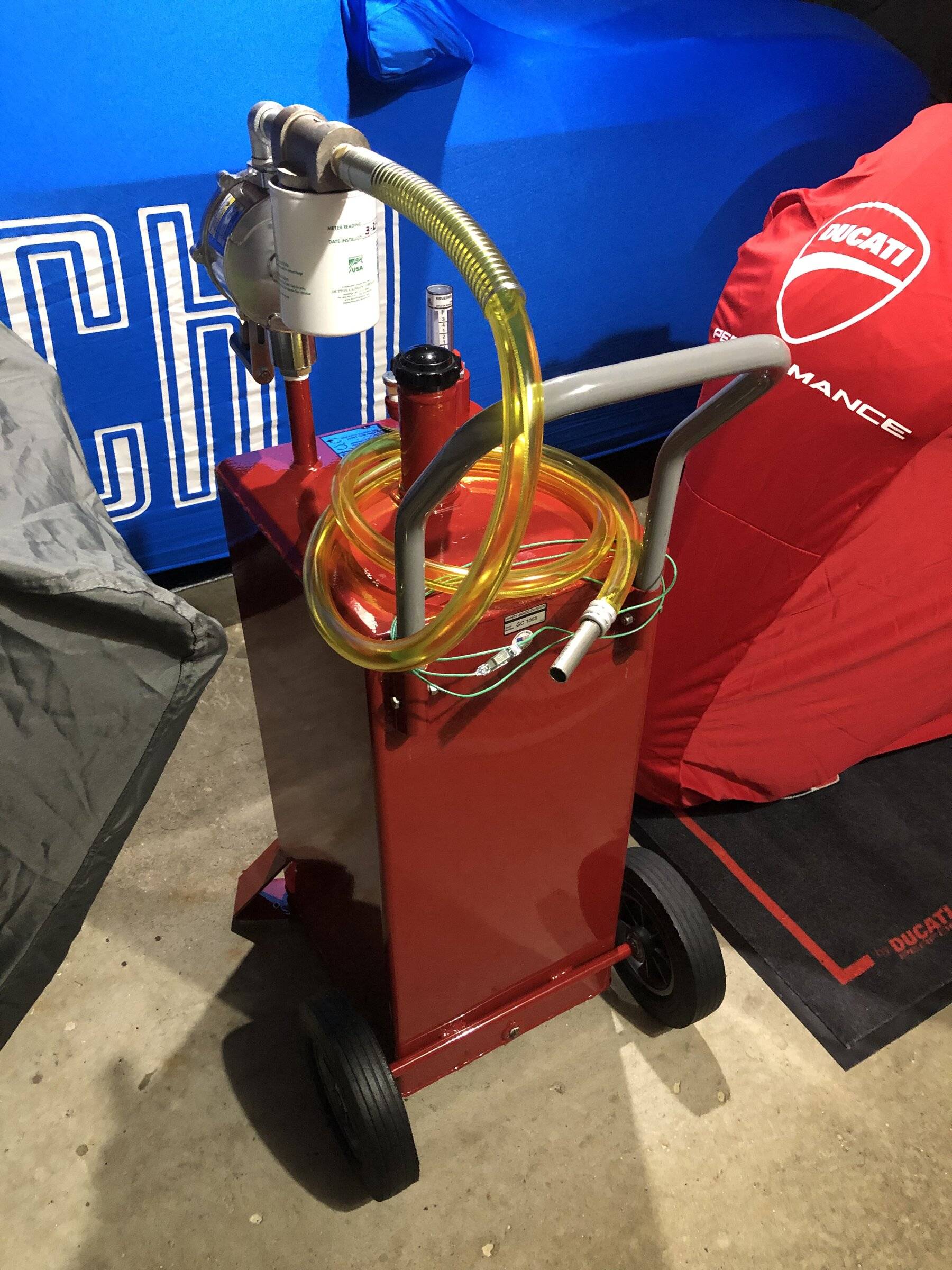

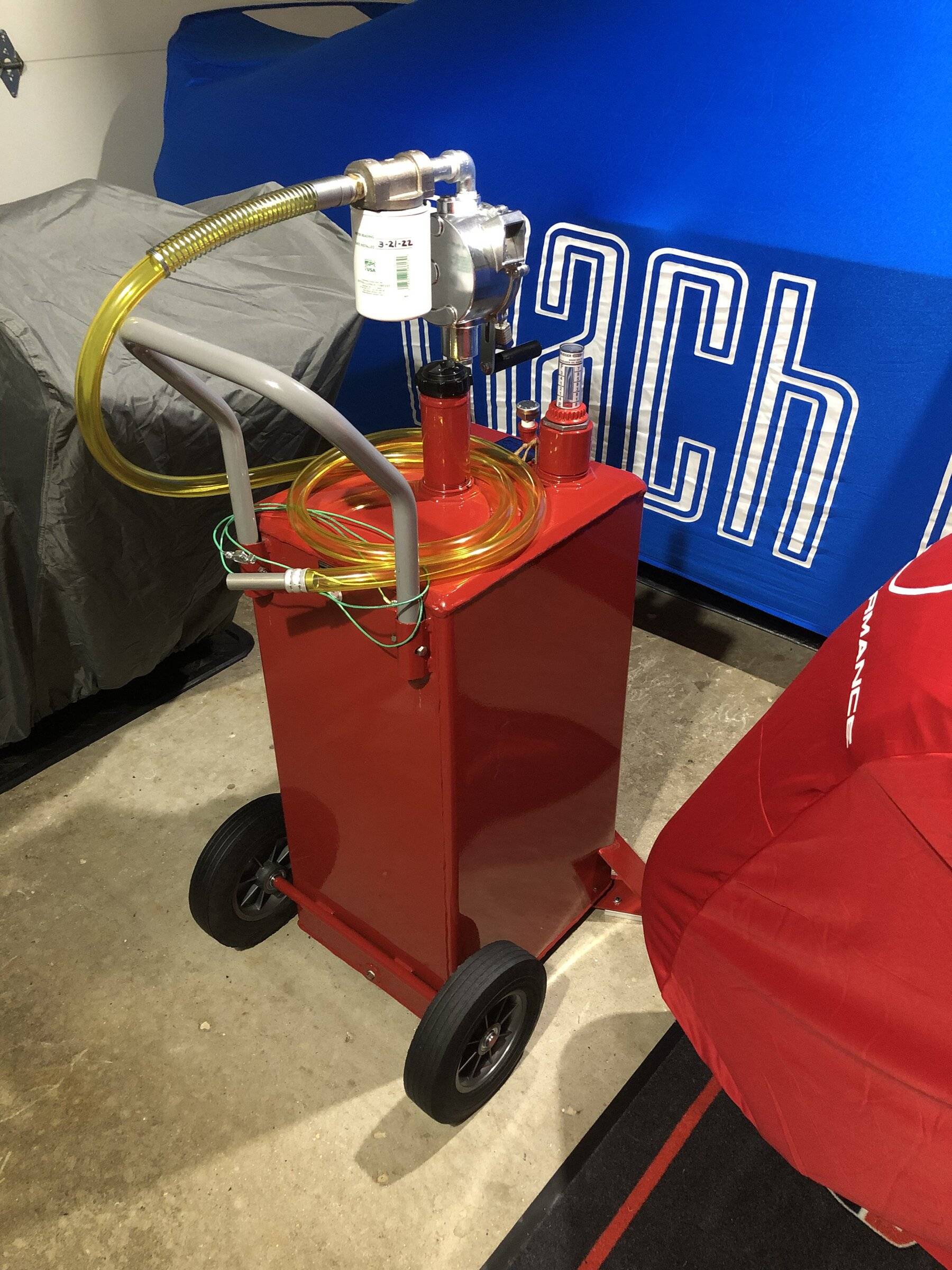

I’m looking into this as sometimes we do a track weekend event. I have space in my trailer and this caddy takes up less space (footprint) than ( 4 ) five gallon jugs. Seems more tidy fueling than lifting a 35 pound jug couple times a day. Plus I’m not a fan of plastic jugs and the metal jerry cans are a bit thin so this is on the front burner before track season starts.
https://www.handyindustries.com/gc-30-gas-caddy
Added filter and ready to go
