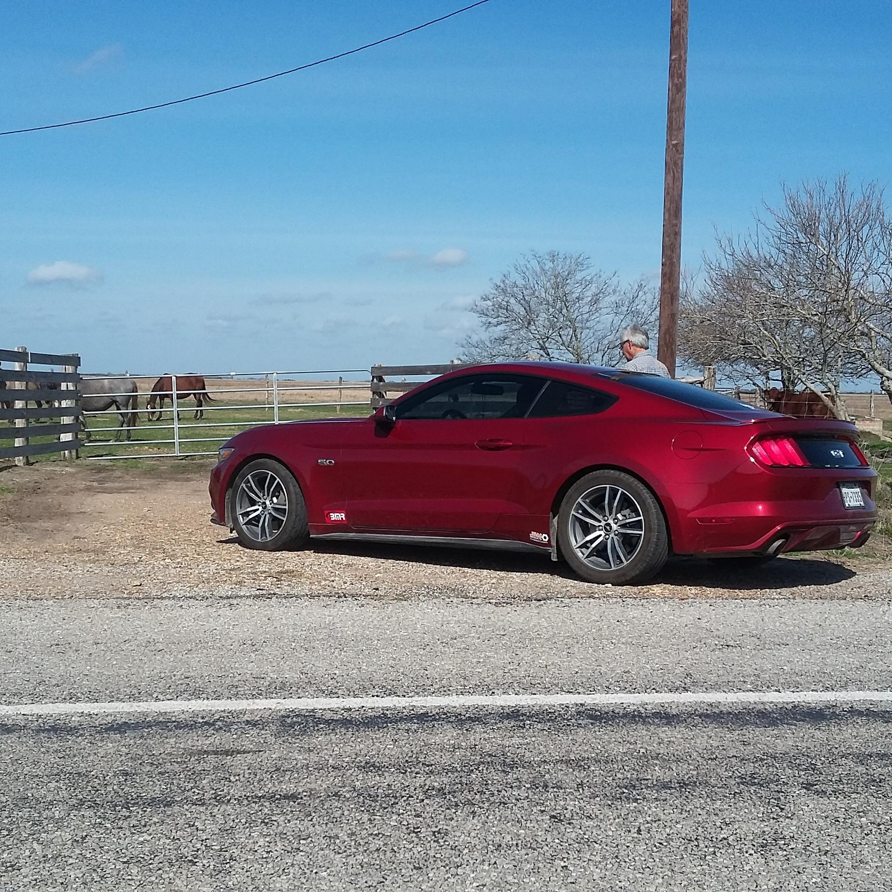

To drop or not to drop?
Before my drop, my GT would float at speeds exceeding 70 mph. I didn't like that at all when passing slower traffic. The BMR CB005 & 006 tightened the chassis well and I bought SVE progressive springs on sale at LMR for $179.00 and their drop is 1.0 rear & 1.1-3 front. Here's a pic. Of note: I have 255/45/18 rear & 255/40/18 tires on the front.
