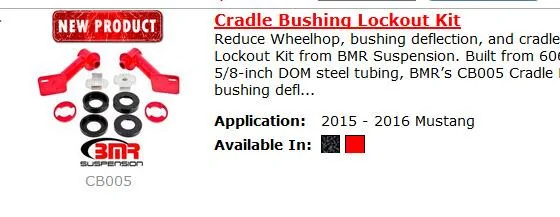

BMR CB005, and diff bushing inserts to stabilize the rear end. if you dont want to lower the height, find someones take off performance pack suspension. The OEM tires arent that great to be honest even on the performance pack, hence why I swapped to squared 275/40/19 PSS.

I've been looking into the rear end also, and have a question. Can the BMR CB005 kit be used in conjunction with Steeda's subframe support system (set of alluminum lockout rings)? Or do they do they both control the same thing? Just wondering if they would compliment each other or not.
Sorry, I am not familiar enough with the rear suspension of my GT to know any better.
Those will not work together. I would get the BMR CB005.
