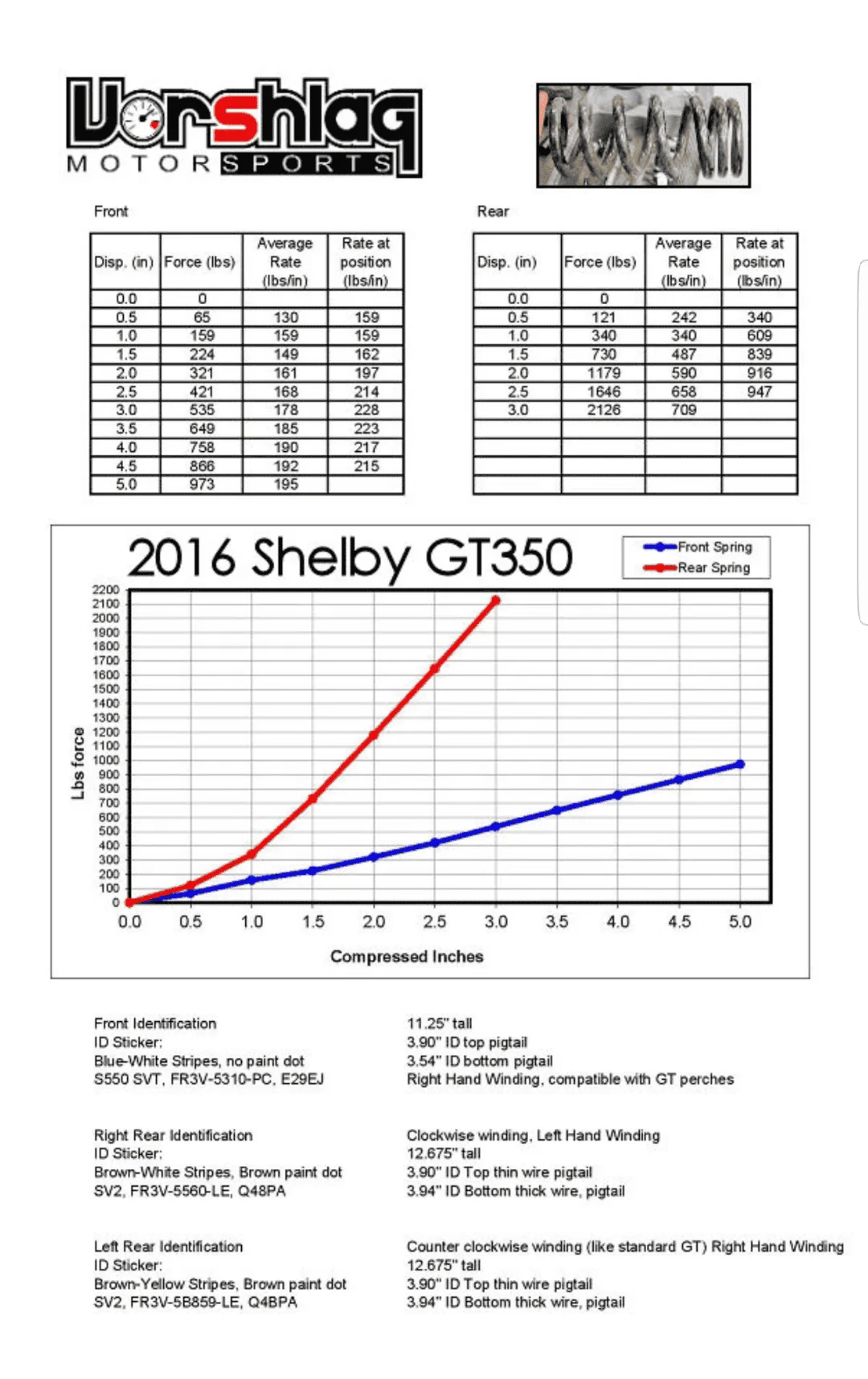

I didn't realize that, total oversight on my part. Found this thread involving the GT350/R spring rates: https://www.mustang6g.com/forums/threads/m-5300-w-fp-spring-rates.91226/
If the spring is progressive and the chart from Vorschlag in that thread is correct, that means that it's only gonna suck if I gun it over a speed bump or into a driveway. Minor bumps and road imperfections will be no issue.

Thats a reasonable assumption
I have a 1" key way into my garage, and coming out (again im on linear rate springs) and its "firm" but not terrible. Granted I ride the brake out to so i dont bounce and bang etc

I haven't really settled on what I feel is the best, but I think about an 800 linear in the rear is tough to argue against. When had the rear of my car stiffer, it wanted to do kind of a hop thing as I'd go to throttle which would hurt traction. As I've softened the rear, that feeling has gone away and traction is much better. None of this seemed to have much influence on actual balance; it just drives off the corner straighter. 800#/in is the range where it's gone for me. Couple that with as stiff of a front as you dare. I don't think even 300 #/in is that big of a deal as long as you are allowing compliance in the rear of the car.
As far as 2" of travel on that spring is concerned, that's where you'll be at static ride height. The 'soft' portion of the spring is taken up in collapsing the soft portion of the spring, which determines the static ride height of the car. On the road, you only see the stiff portion of the spring.
