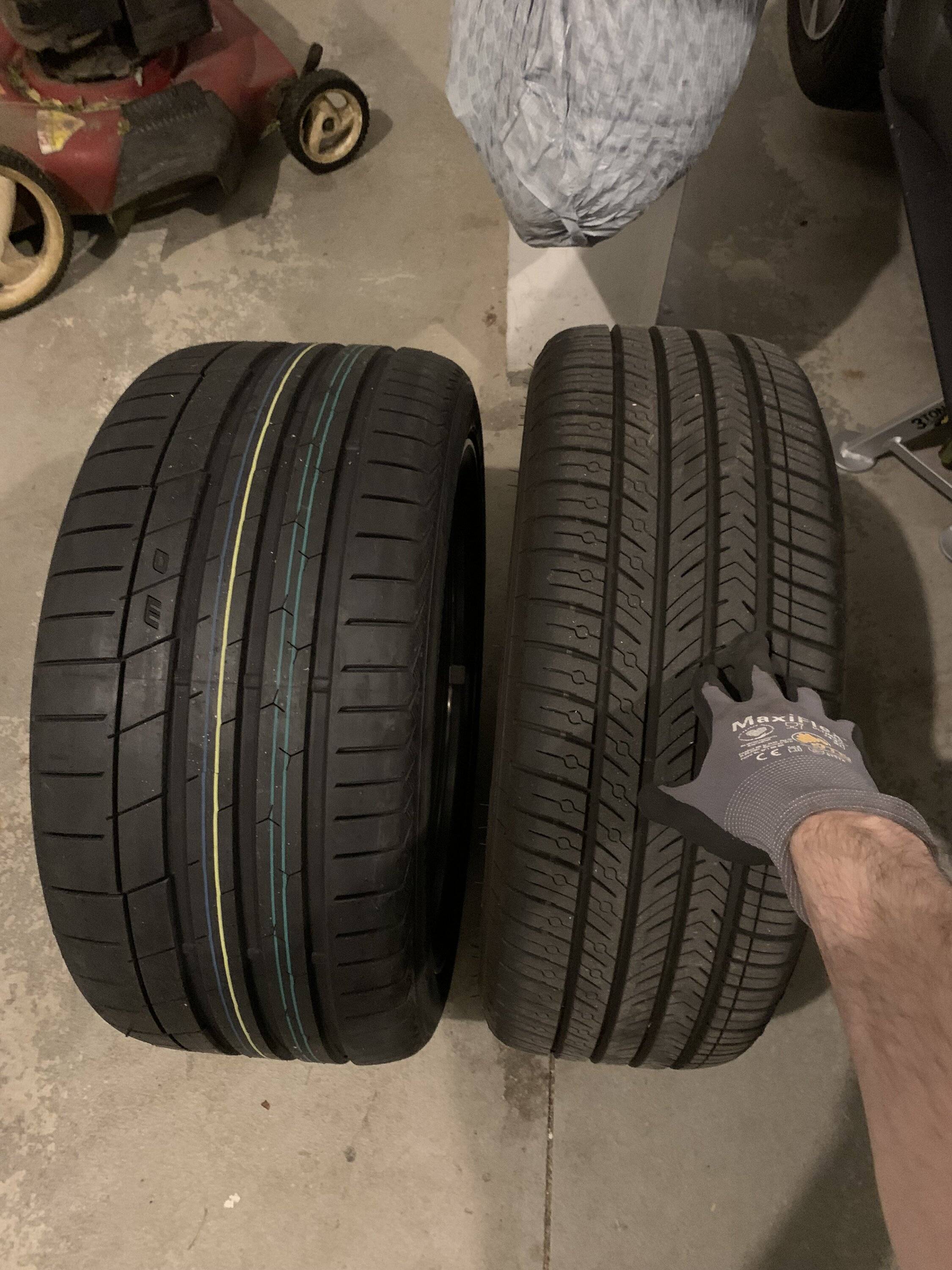

I got all my parts in. Wheels/Tires are a pretty big upgrade. Suspension goes on memorial day weekend.

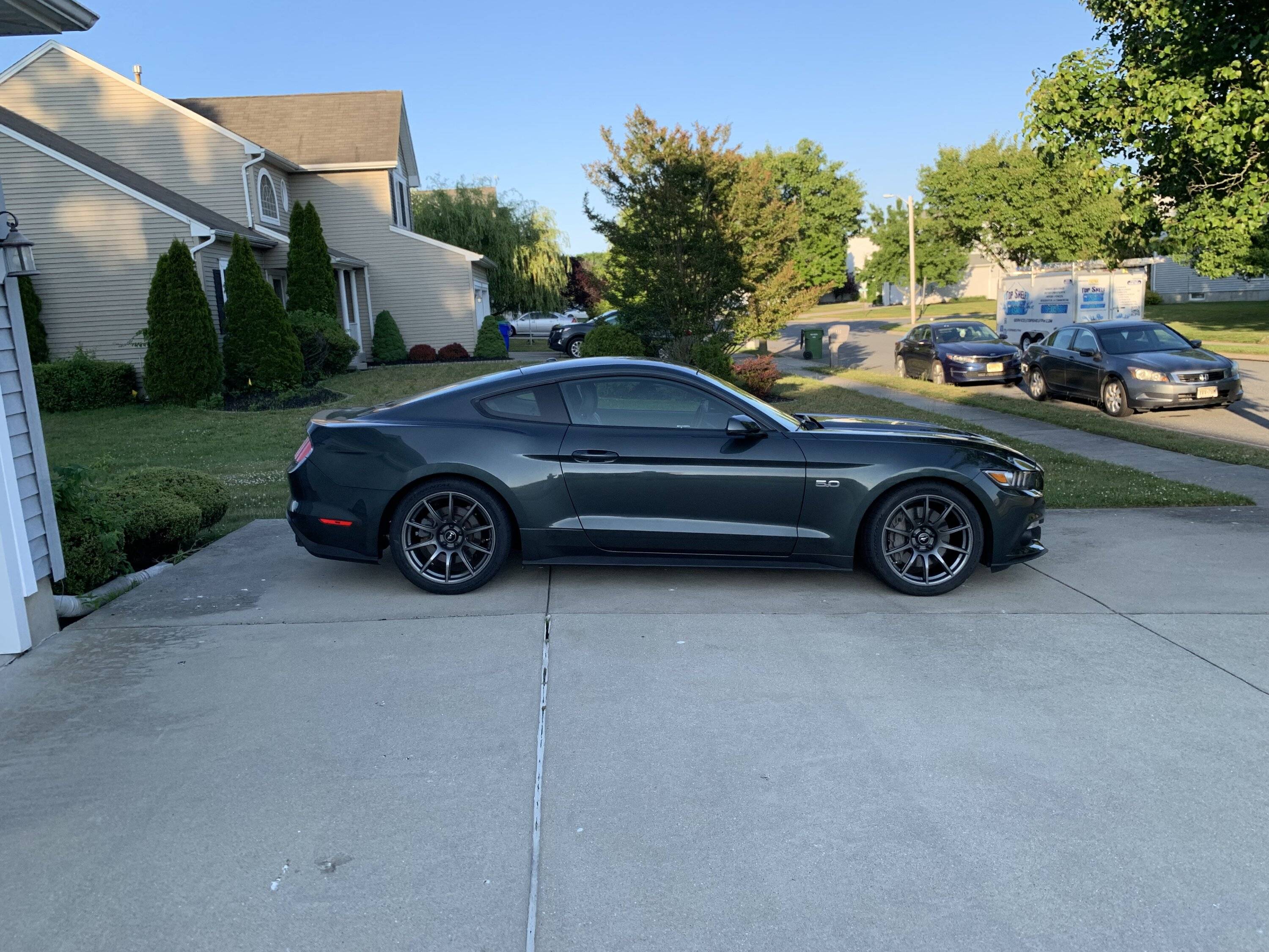

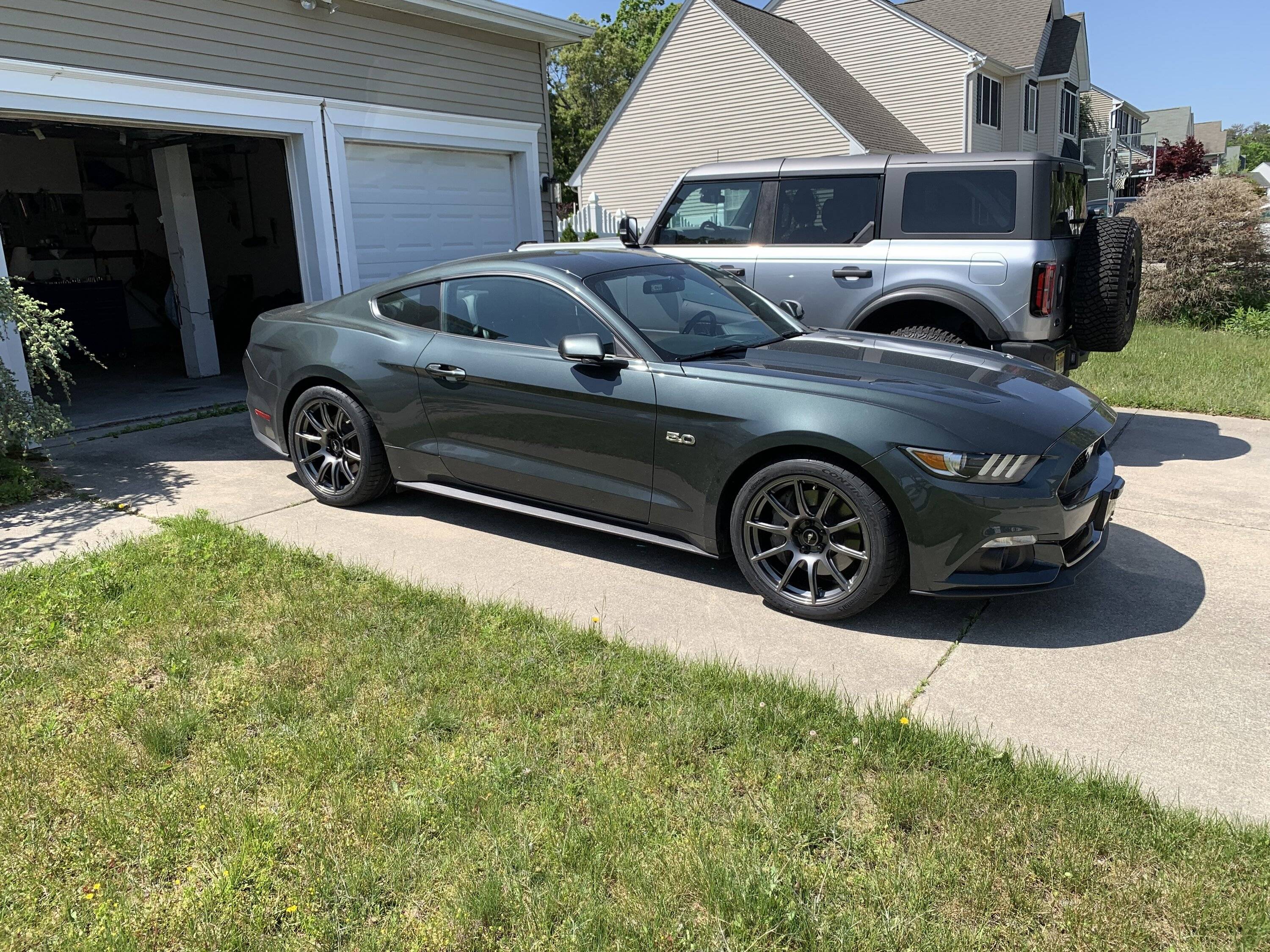

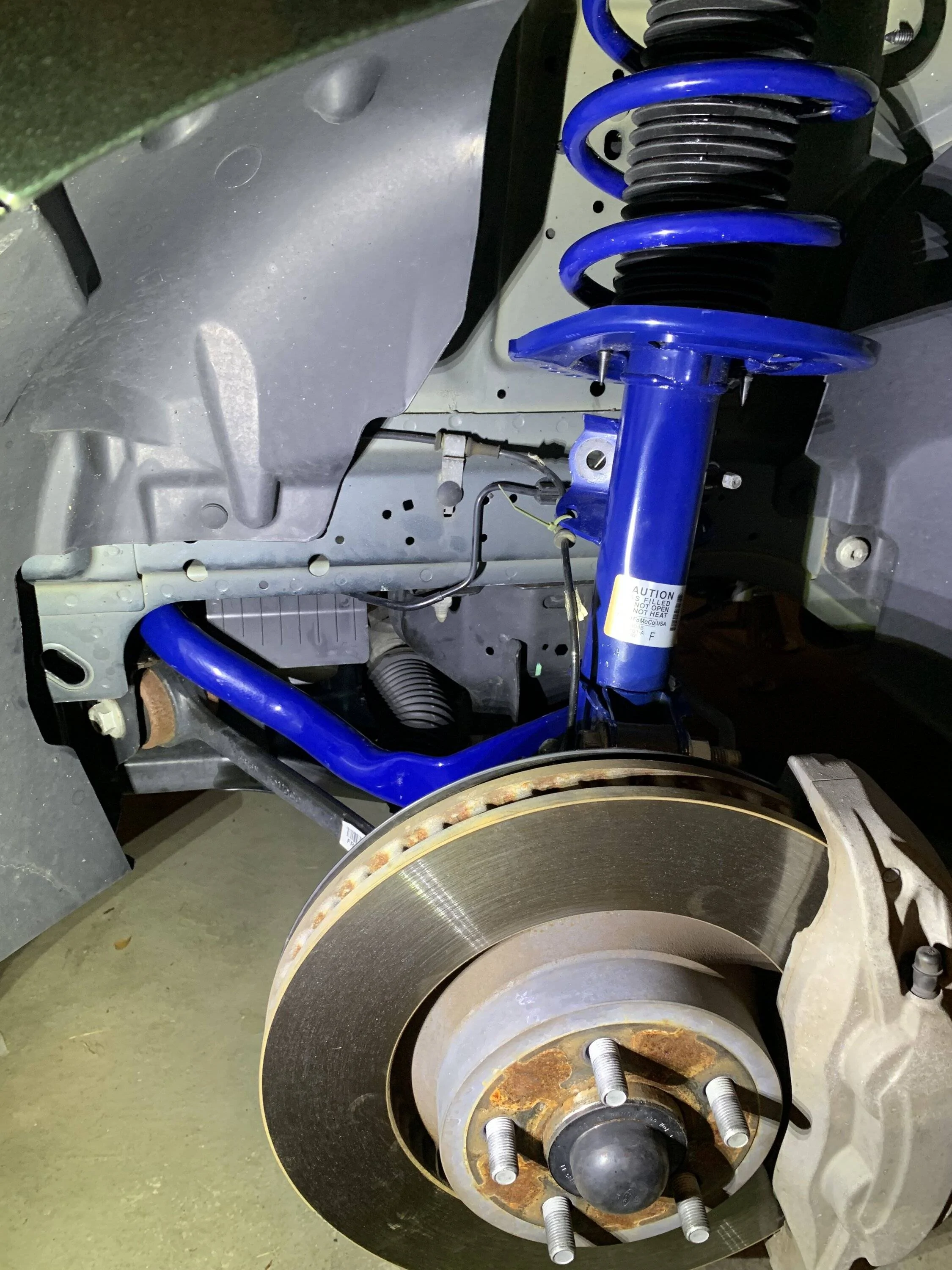

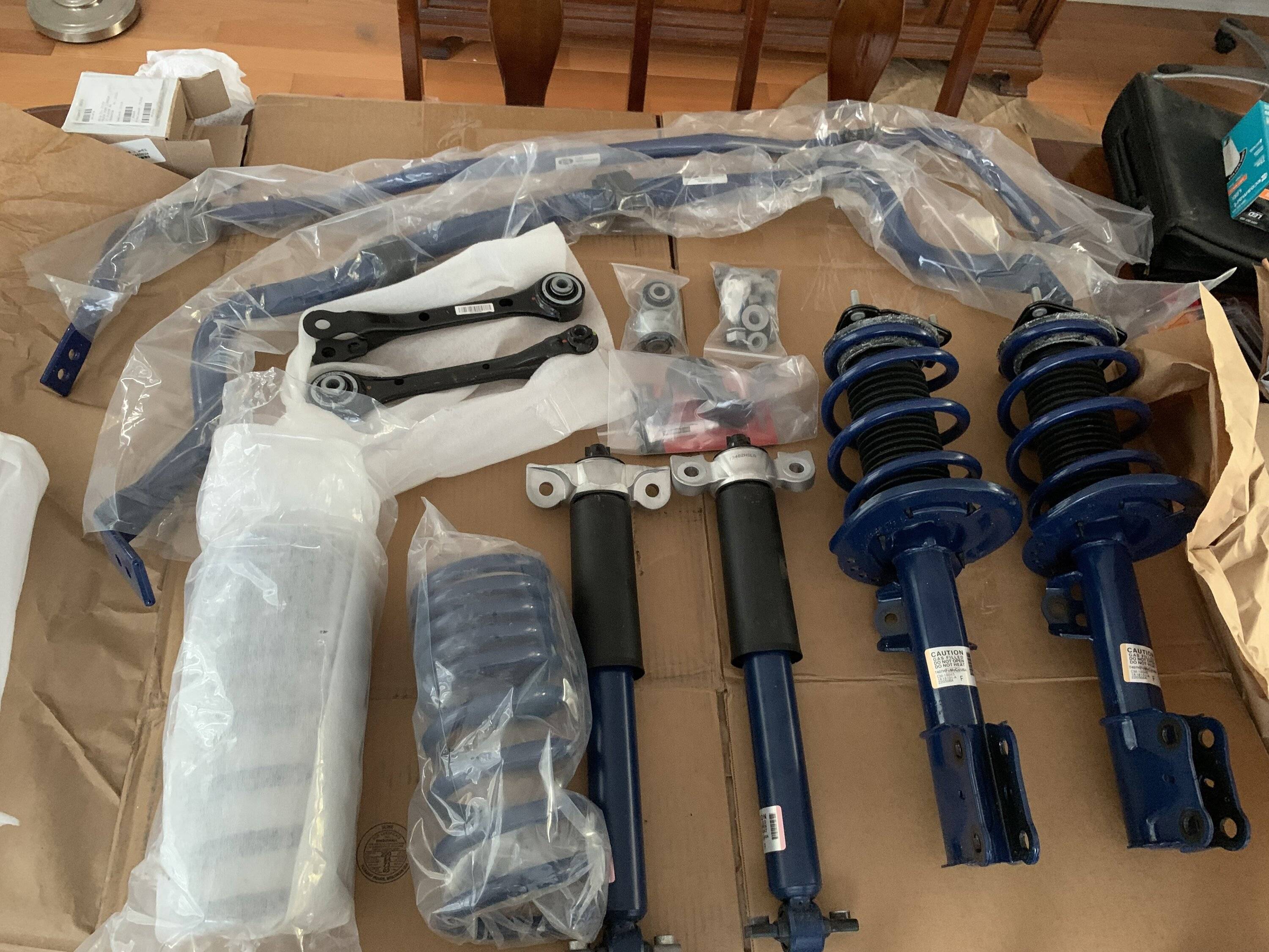

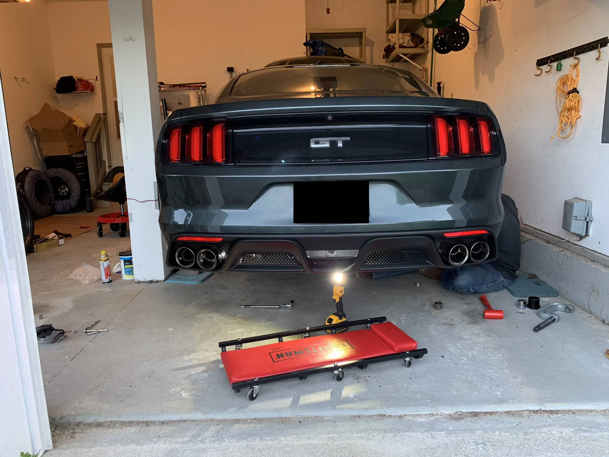

This became a bit of a build log, but I got everything on last weekend and got an alignment.
The swaybar bolt under the alternator was a pain. The instructions for the toe bearing that say to use a 1 1/4" were wrong, I needed a 36mm to hit the sleeve perfectly. Aside from those two incidents, it went well. I followed some videos on YouTube, and just lowered the rear sub-frame one side at a time.
The car handles quite well. There is plenty of grip for me without tramlining. There is significantly less body roll with the sway bars set to their softest setting. There is no bounce, in exchange rough bumps are really felt. Smooth roads feel at least as smooth as they did before.
Most importantly, after my concerns earlier in the thread and with the other posters I found who did not have an even drop, my car dropped just fine in the rear.
