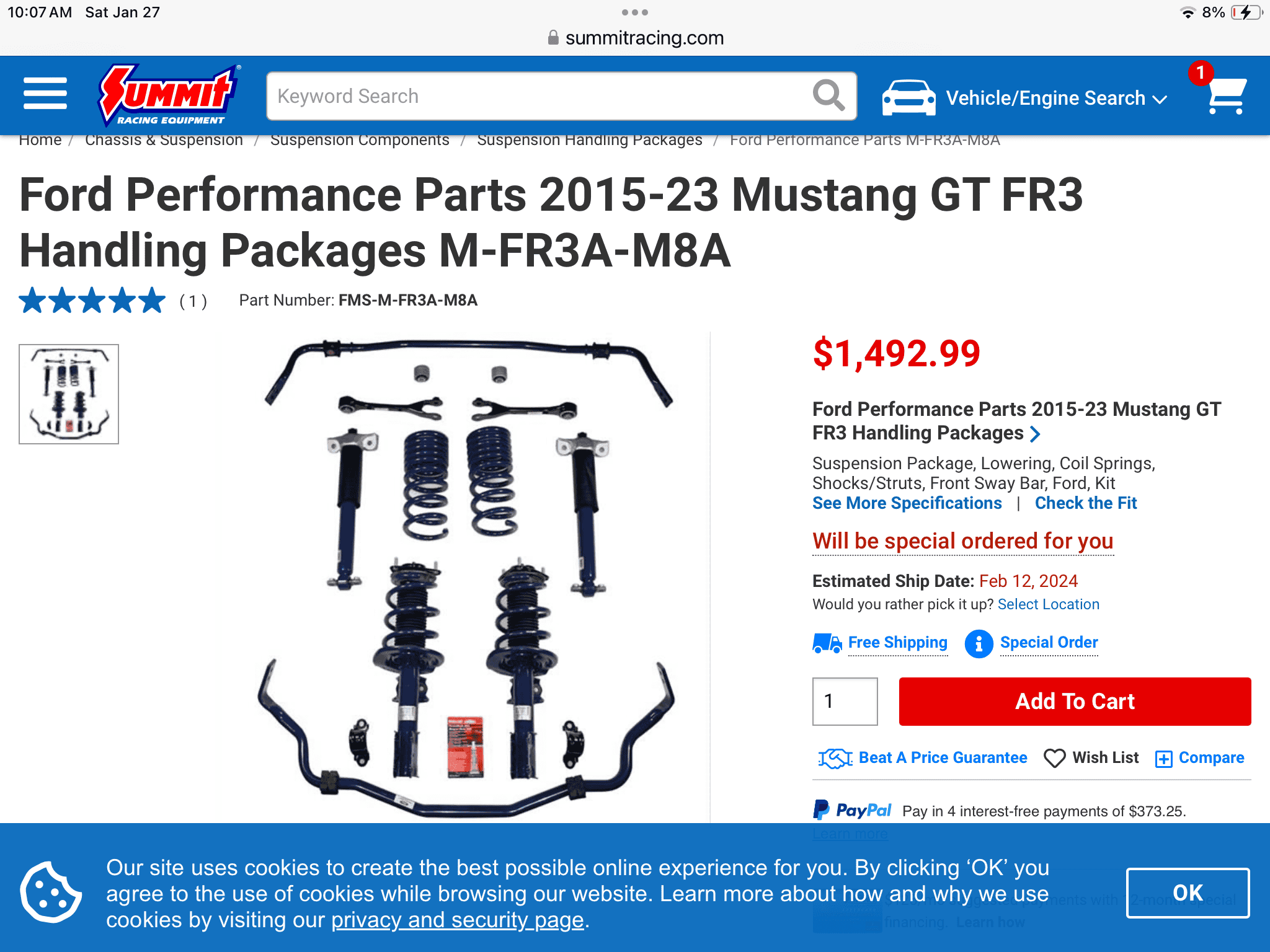

Pulled the trigger on the FP Track Handling pack…
Summit indicated they have some due in next month, ford performance, steeda, AM and most everywhere else i looked said they were all backordered… my car is cooped up till spring, so im ok if i do not see it until spring. I was planning to put some money into the car, either suspension/handling, or replacing the not so hot stereo….
handling won out over sound…. Excited for spring….
ill probably pay (dearly) to have this dealer installed - presuming they will install parts not purchased directly from them. If not ill get my local guy to do the install. I am sure it would be cheaper from my local guy, and i am sure they can do it. They just do not do alignments there so id have to take it elsewhere for the alignment after the kit was installed…
i am assuming i could drive it a bit after this was installed without the alignment done?
i mean just home - 25 miles and then to an alignment shop? Or would this not be recommended?
