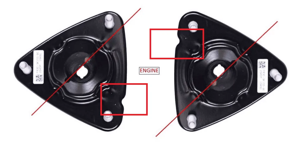

Yeah I was trying to follow that thread as well. I'm following the instructions the #4 reply mentioned even though my strut currently looks like #3 reply.
I tried to get my notch to match the ford sheet, but I can't get it straight and have the bolts line up with the holes. If I can't figure it out today I'll call ford performance tomorrow since they're closed right now.
racingandfishing
Oct 27, 2015
702
426
Austin, Texas
2015 Mustang GT PP
I believe the original post with the pic below is correct and number 3 is not correct and how mine were originally installed. This is how mine are now with both notches facing the engine.
Either way, please post what Ford Performance says tomorrow so we can all be clear on the topic!
"This is the diagram that @aleccolin posted in other thread but looks like some peoples' cars didn't come this way from the factory."

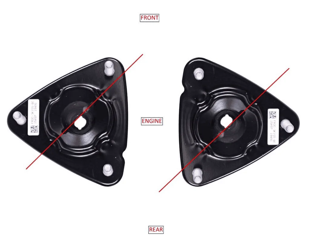

Yeah mine came actually like this
Rear
| engine |
Front
from the factory (notches parallel with engine)

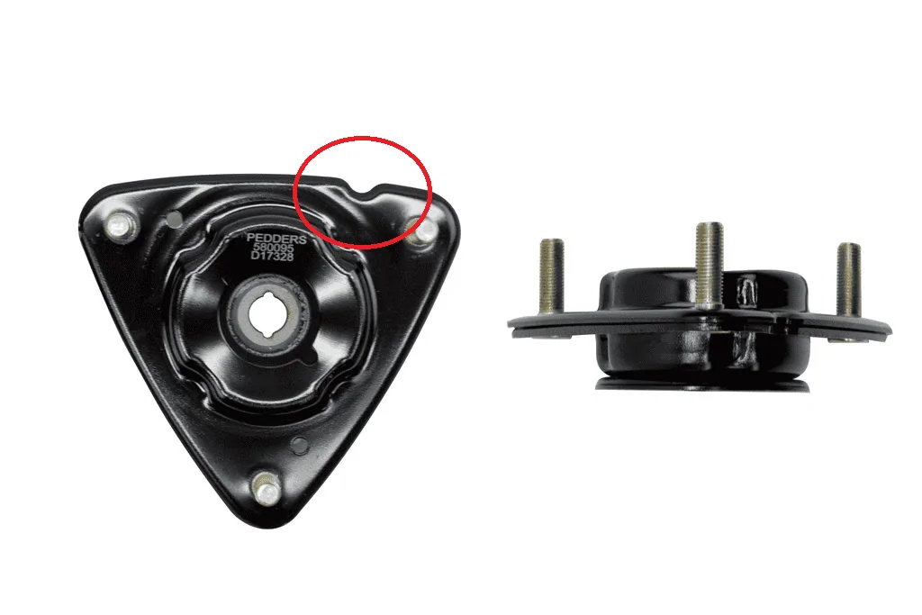

Ok I finally understand it now after re-reading that post you sent me. The notch I was looking at was the wrong notch, the real notch is on edge of the top hat:
Apparently I missed that little red circle on the OP's post....definitely could've saved me a lot of headache if FRPP just put a diagram of what notch they mean :/
TL;DR this diagram is correct and those middle 2 notches should be orientated this way.
Also...my factory notches were way off :(
Yeah, sorry about that, I should have highlighted the notch I was talking about! And yes, the instructions are less than specific. Though when I did mine a few years ago, I couldn't find any install videos that provided clarification and I think even some of the ones produced by companies selling these parts may have installed them wrong.

FRPP tech said I should have those notches pointed toward the engine bay as it affects camber - I have to undo my driver side and rotate the top hat ugh.
Yup did the same thing . Installed it the same way it came off, which was obviously wrong. If I recall, I only had to undo the three nuts on top and the sway bar linkage and was then able to pull it down enough to rotate it.

I could be wrong, but I don't believe how the upper notches face are what the instructions are referring to. I believe it is the ones in that photo I posted. I have them installed with the underside notches facing the engine, and the upper ones point differently on the passenger and driver side.
As far as consequence, not sure what they might be if they are wrong, but guessing it has to do with camber. I didn't notice any difference when one faced in and one faced out vs. both facing in, but I haven't tracked the car either.
Of course I could be wrong about all of this! I would chat with Ford Performance tomorrow and see what they say. Maybe I misunderstood them when I was installing my springs.
The notch they are referring to is this one:
