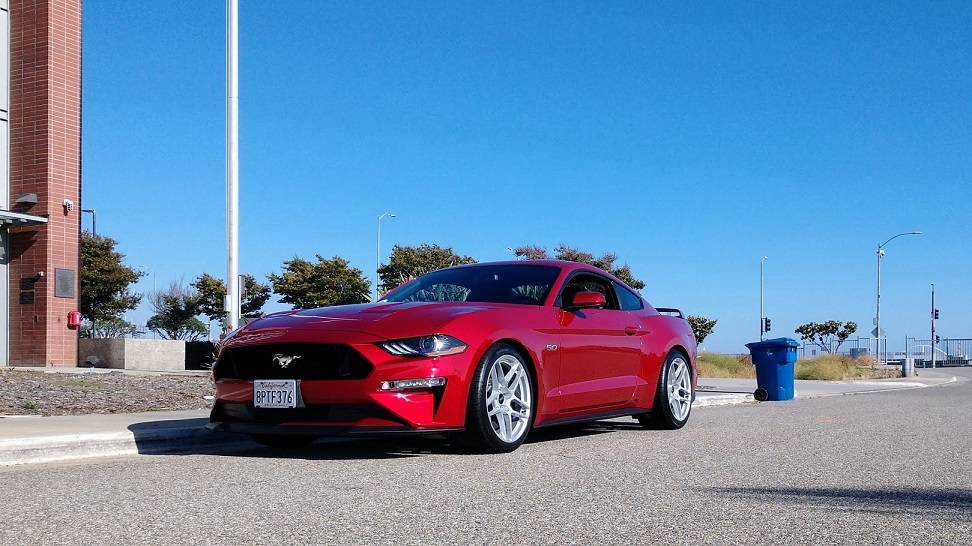

I didn't quite get 1", it was .875" front and only .75" rear. I did clock the bushings. It evened out the height though. Front and rear are pretty much equal.
