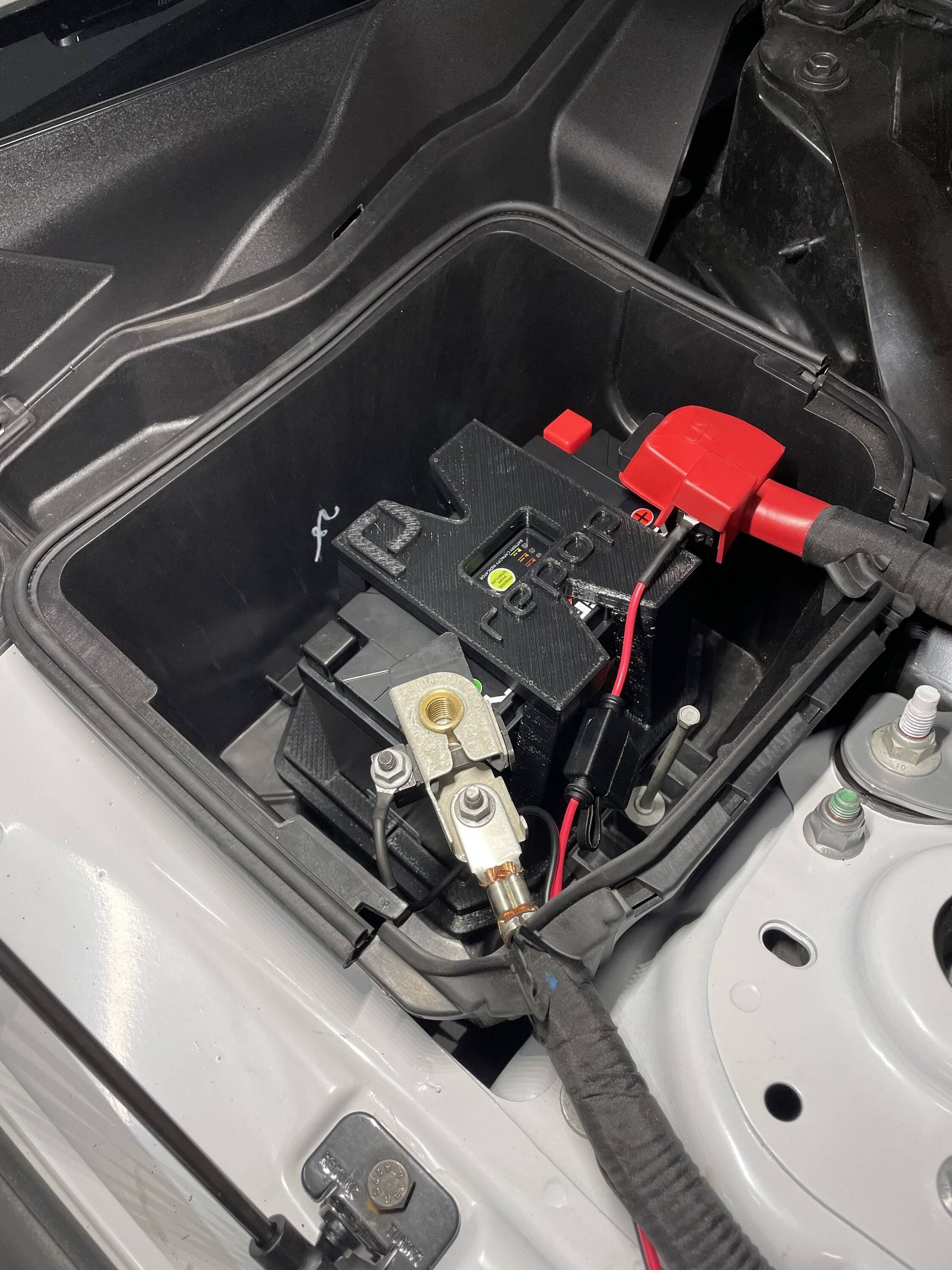

Sorry to hear of your troubles. I was wondering, where do you hook up the Negative side cable from your charger? I found out these mustangs charging system are different than some other cars. Good Luck
Pos & Neg leads for the charger go straight to the battery terminals. Been like this for five years now. Zero issues.

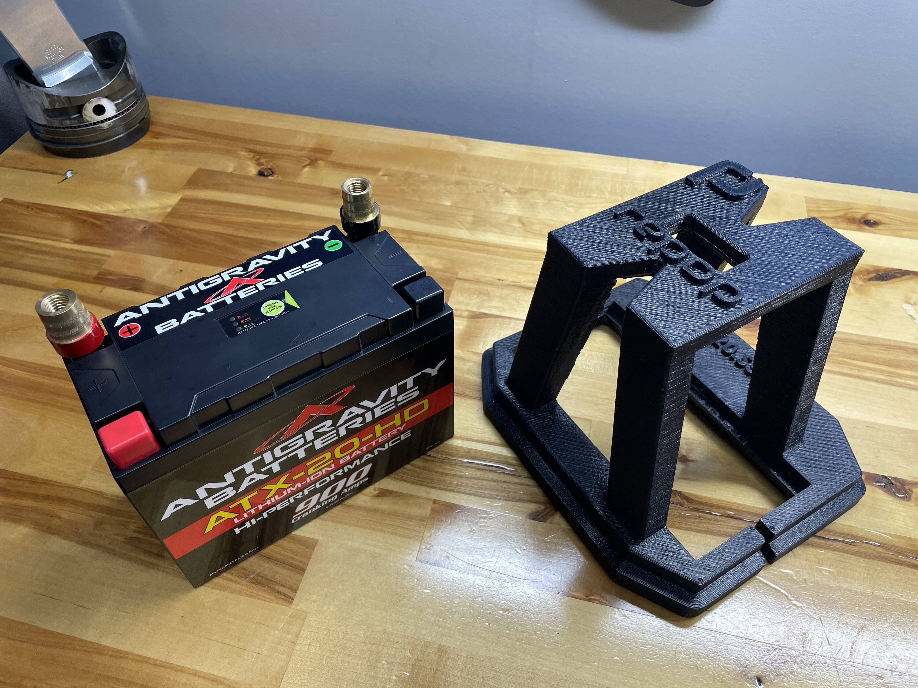

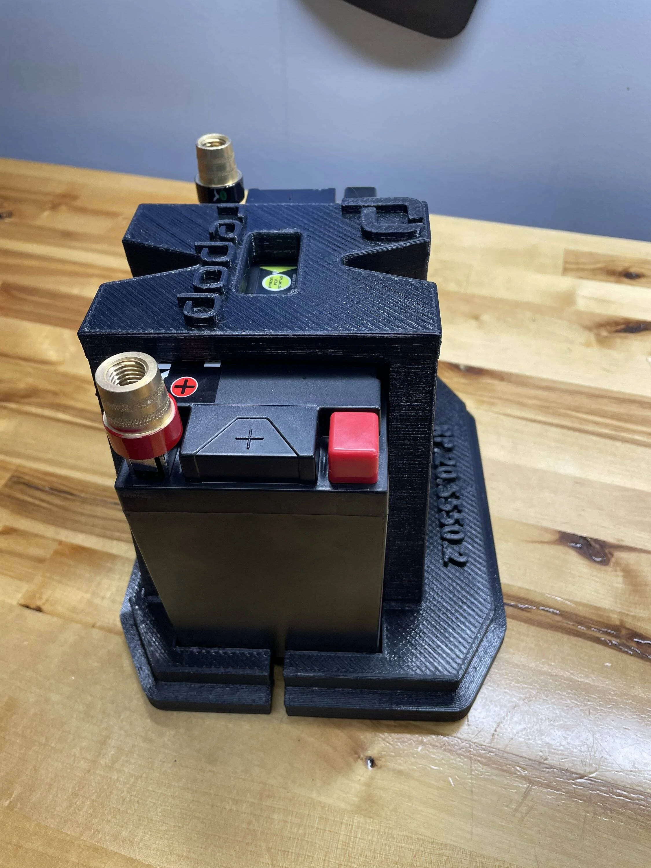

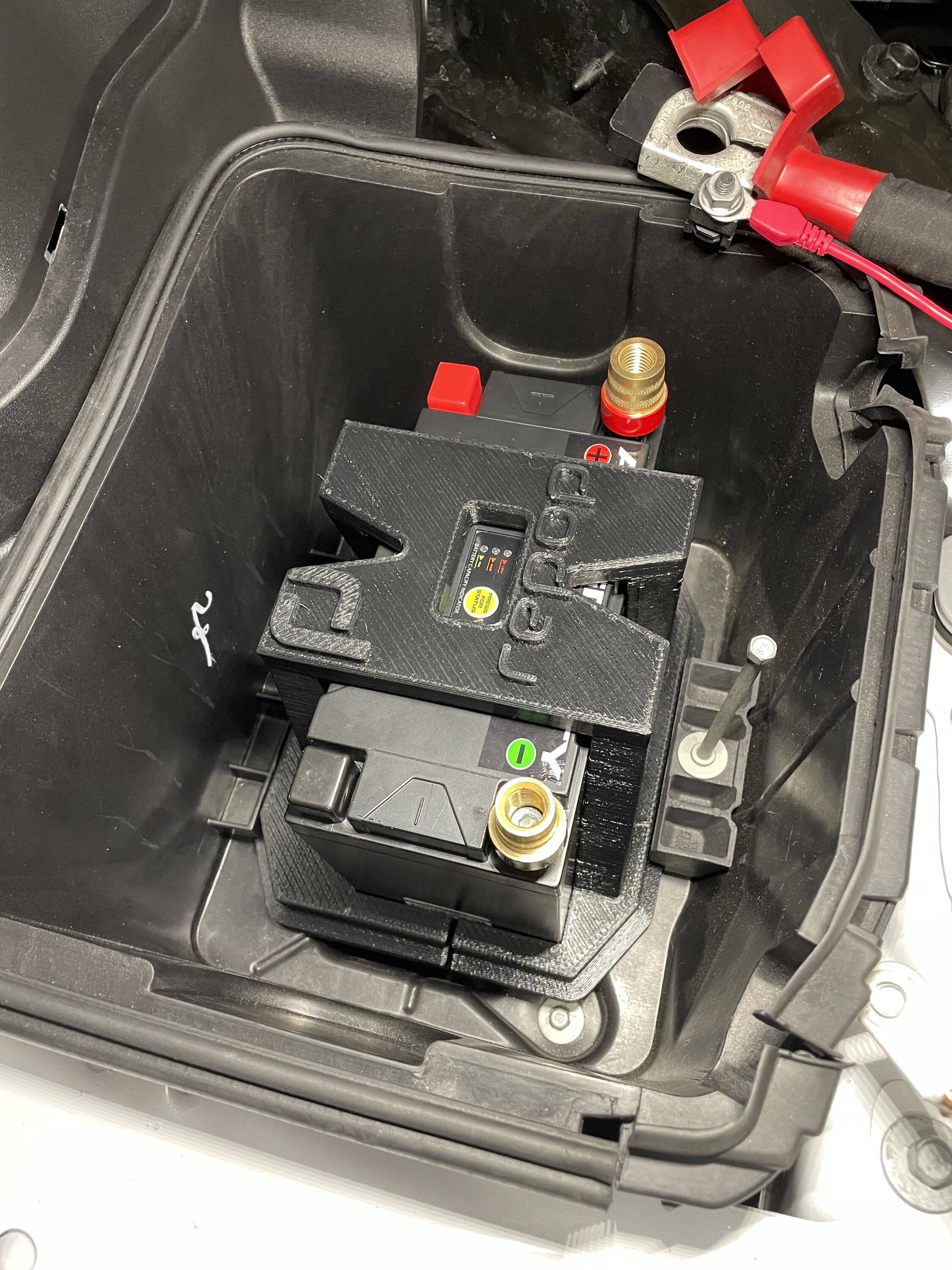

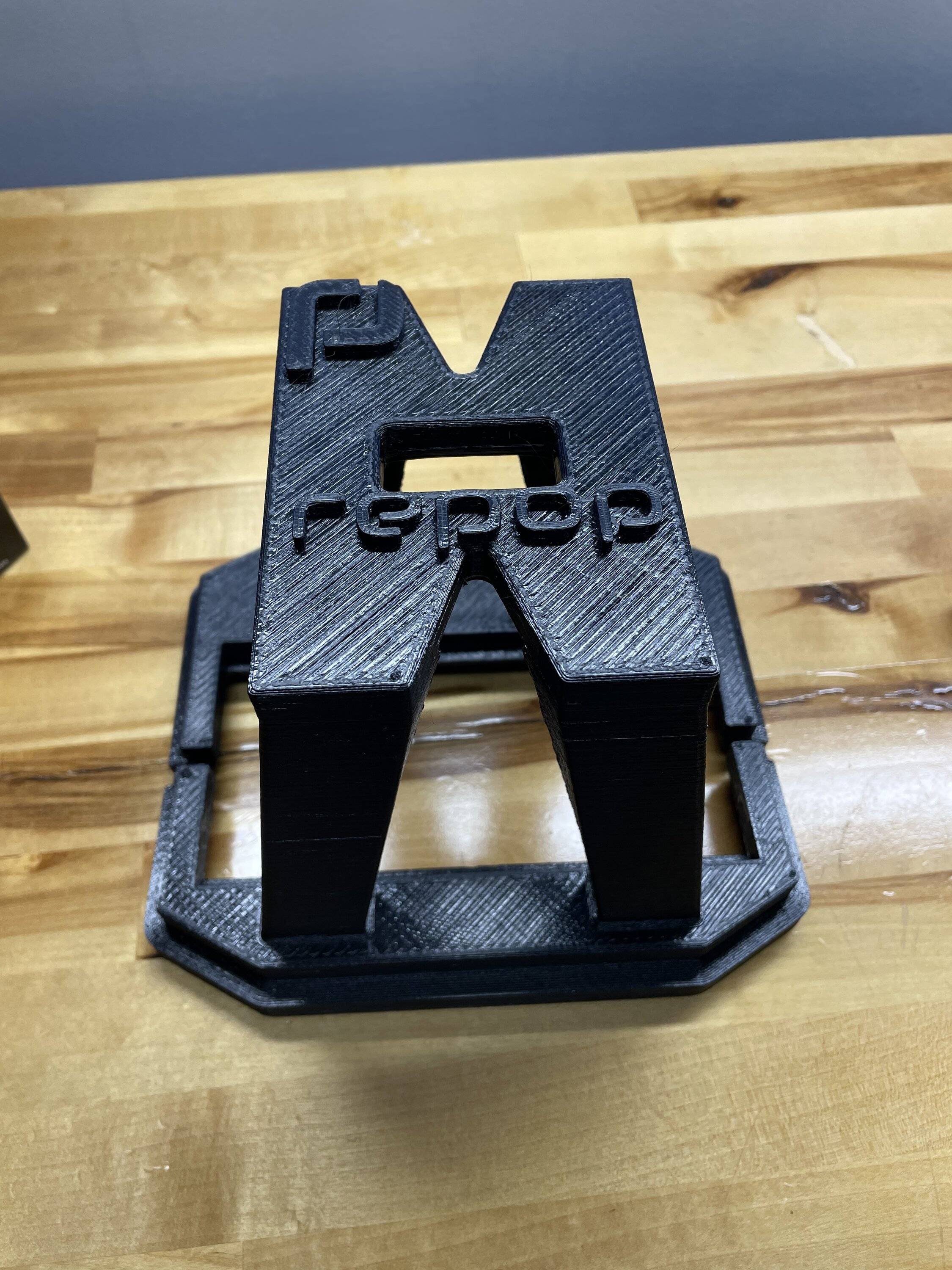

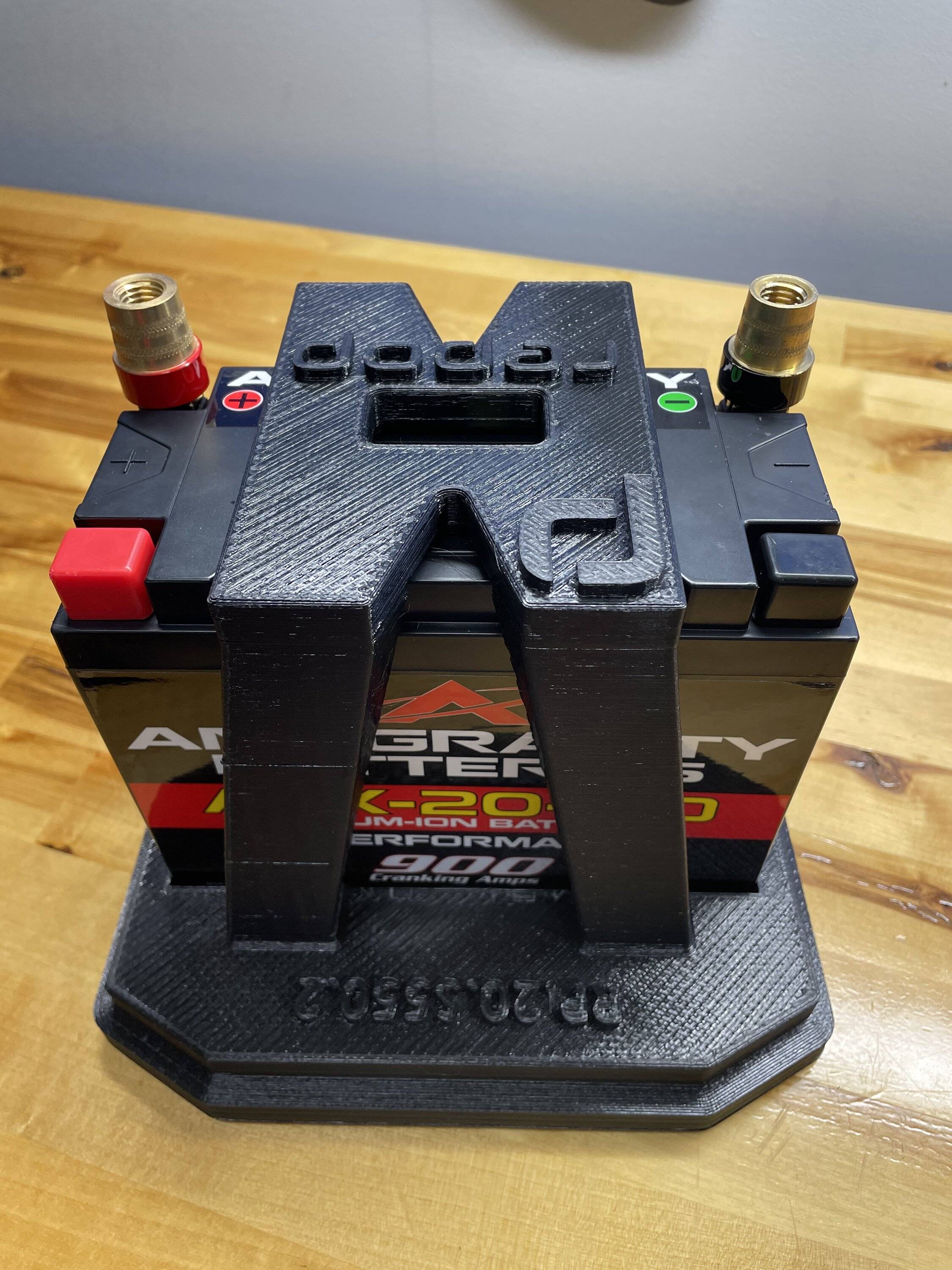

Oh…and since my thread came back up, here’s the latest.
Got my AG in and it’s pretty incredible. This car has never cranked this fast, even when brand new. You can see my charger leads connected in the one pic.

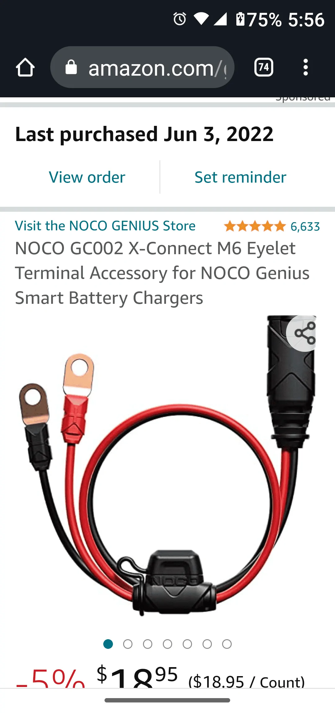

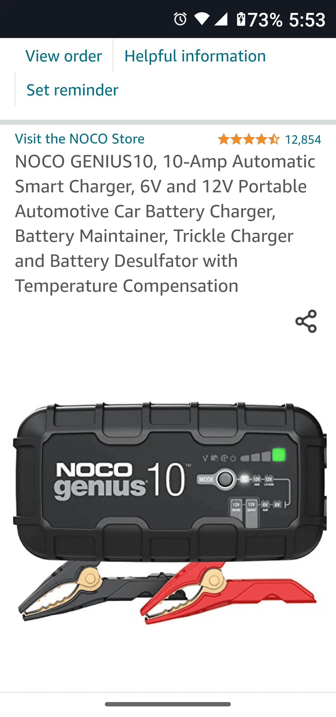

I've got mine hooked to the ground bolt on the passenger strut tower, the hot is attached to the cable in the fuse box that goes straight to the battery. I think it is the one closest to the battery box.
DougS550
May 18, 2020
317
4,748
2,723
Fishers, Indiana
Doug
2019 GT Premium A10 PP1 Whipple Stage 2
That's where I have my Neg - POS wires connected to. I also do a BMS reset each time I disconnect my battery cables for what ever reason. I also switched my battery old trickle charger with one that is an automatic, maintainer, Trickle charger. I also hard wired in a connected with the connector end sits just front of my upper grill. When I connect my charger, maintainer I don't have to open my hood. Makes it easier.
