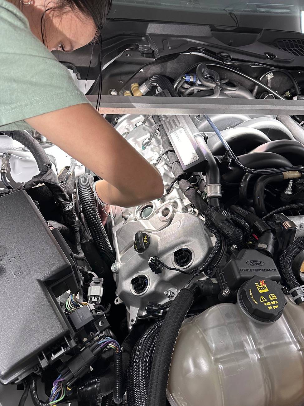

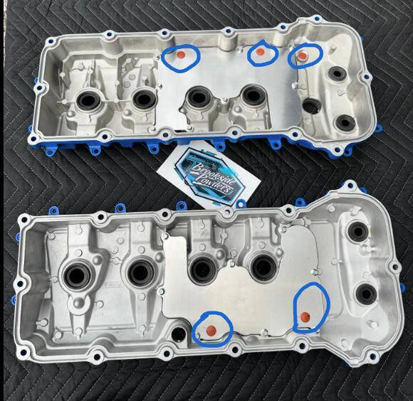

Does anyone know what the function of the supplied pink plugs that are located on the underside? Is this just for shipping reasons?

I've always heard them called "rain shower plugs". I've seen vendors use them to regulate oil dripping onto valvetrain components. Ford uses them to drain the oil from behind the metal PCV baffle plate. The 3th one on the passenger side cover, when installed, will allow the GT500 air/oil separator to drain the captured oil back into engine.

I've always heard them called "rain shower plugs". I've seen vendors use them to regulate oil dripping onto valvetrain components. Ford uses them to drain the oil from behind the metal PCV baffle plate. The 3th one on the passenger side cover is for the GT500 air/oil separator, if you remove the bolt that is torque in the cover.
So i should leave them alone and install as is? Thanks for the help.
They are 1 way silicone drain valve for the oil that get separated from the oil mist in the breather baffles
Do not remove them

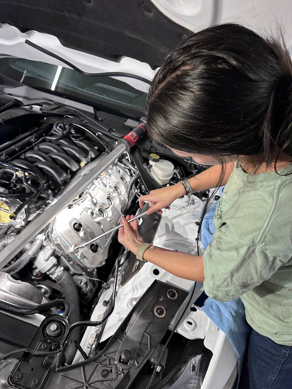

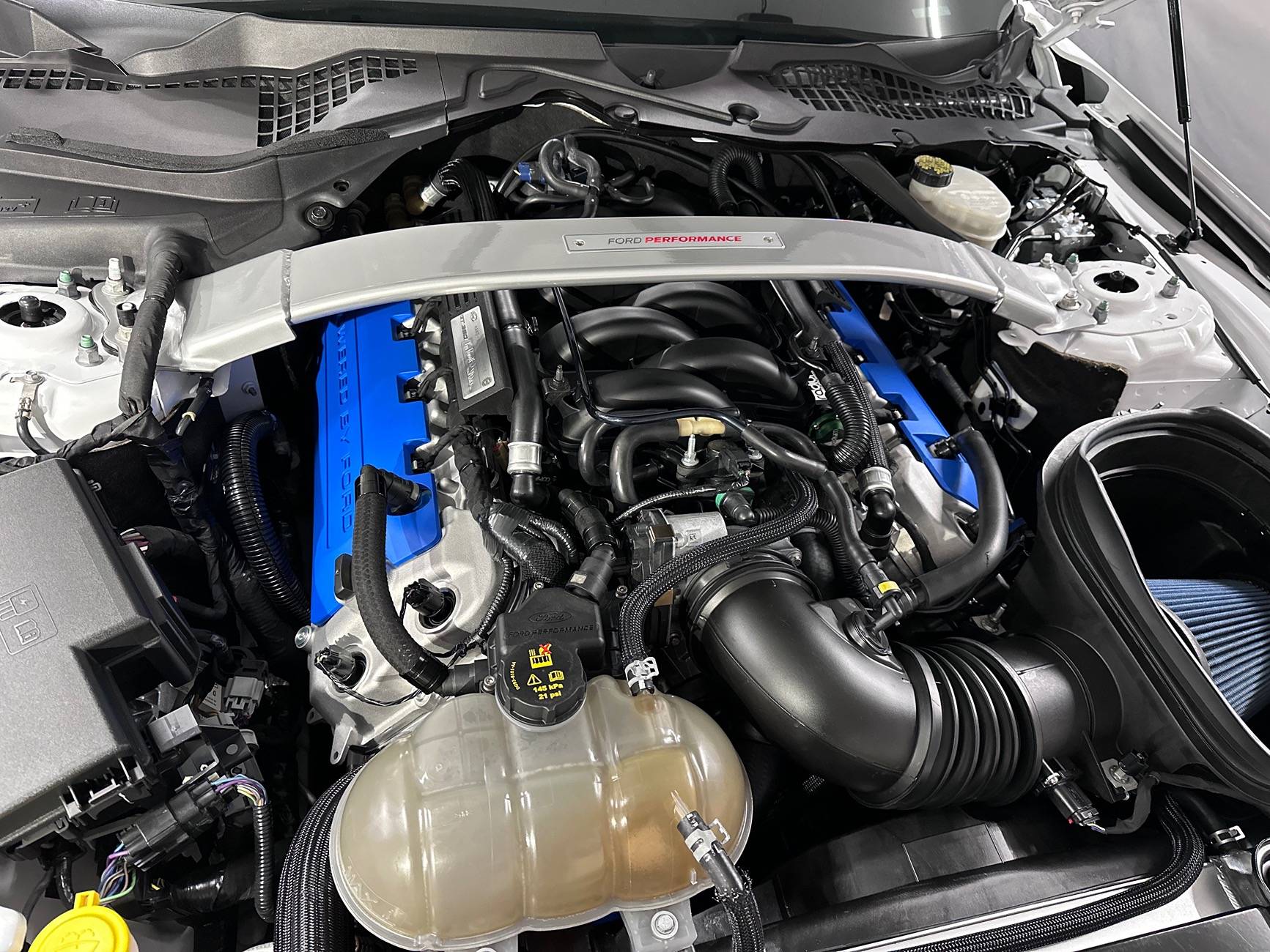

What is the purpose for this install?
jloshotz
Feb 11, 2024
341
310
NY
Jack
2016 GT Premium
1) Way cooler looking than garbage plastic
2) Practically twice the mounting bolts thus way less likelihood of loosening and oil seepage (BEST reason hands down)
3) Arguably either hotter or cooler dissapation wise (many arguments either way)
4) Definitely heavier, i’ll take that negligible trade off
5) No need to lug around that pesky extra $350 😁
IMHO just a matter of taste otherwise

Yep, from my experience and research the stock plastic covers only use 9 of the 14 mounting holes and they start to leak. The one I did for my son leaked pretty good.
The stock replacements also only use the 9 of the 14 mounting holes and are pretty close cost wise the the aluminum ones.

You guys forgot #7...quality time in the garage with my favorite gearhead!
You should have her change the blinker fluid so you can spend more time with her.
