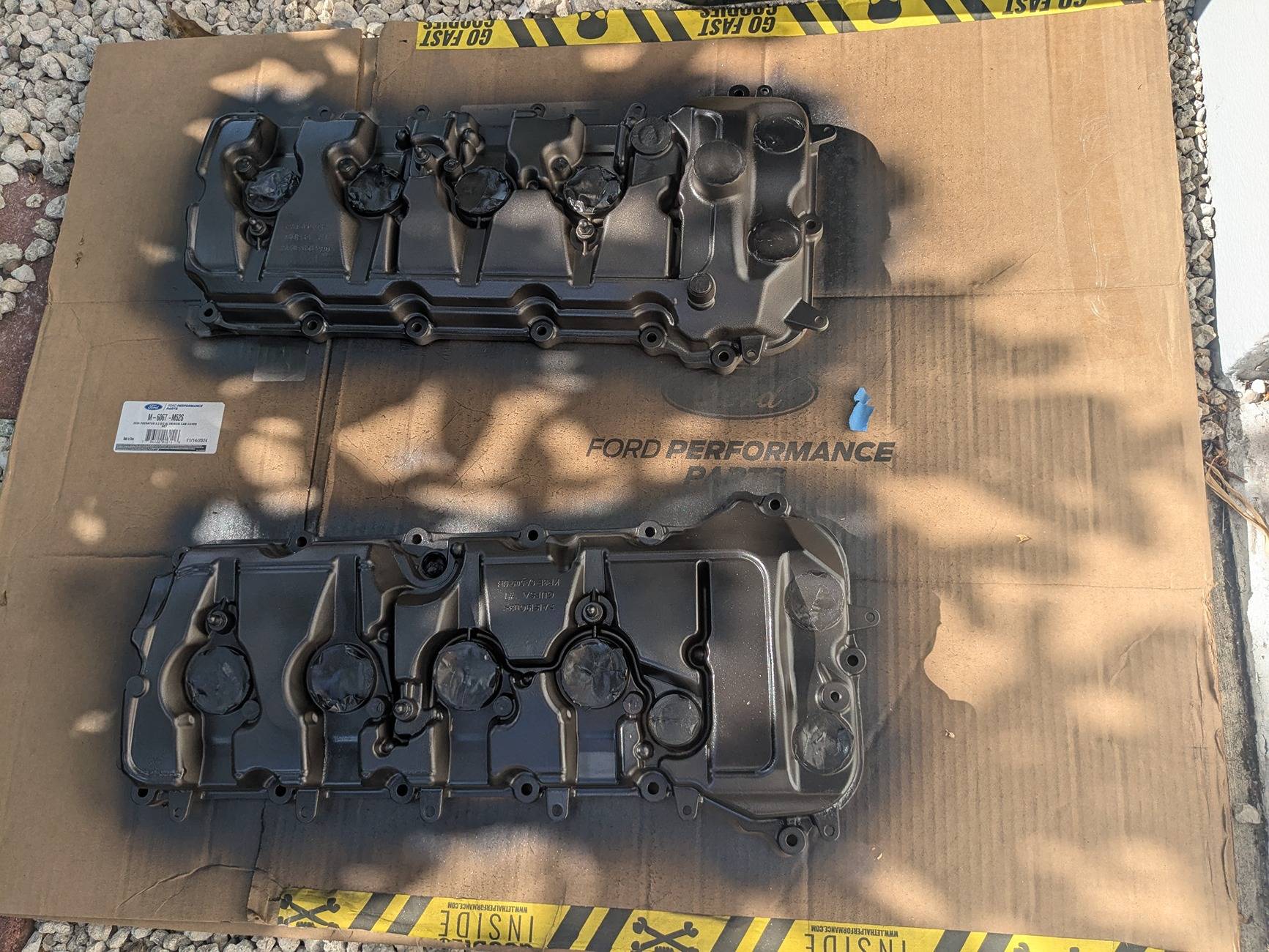

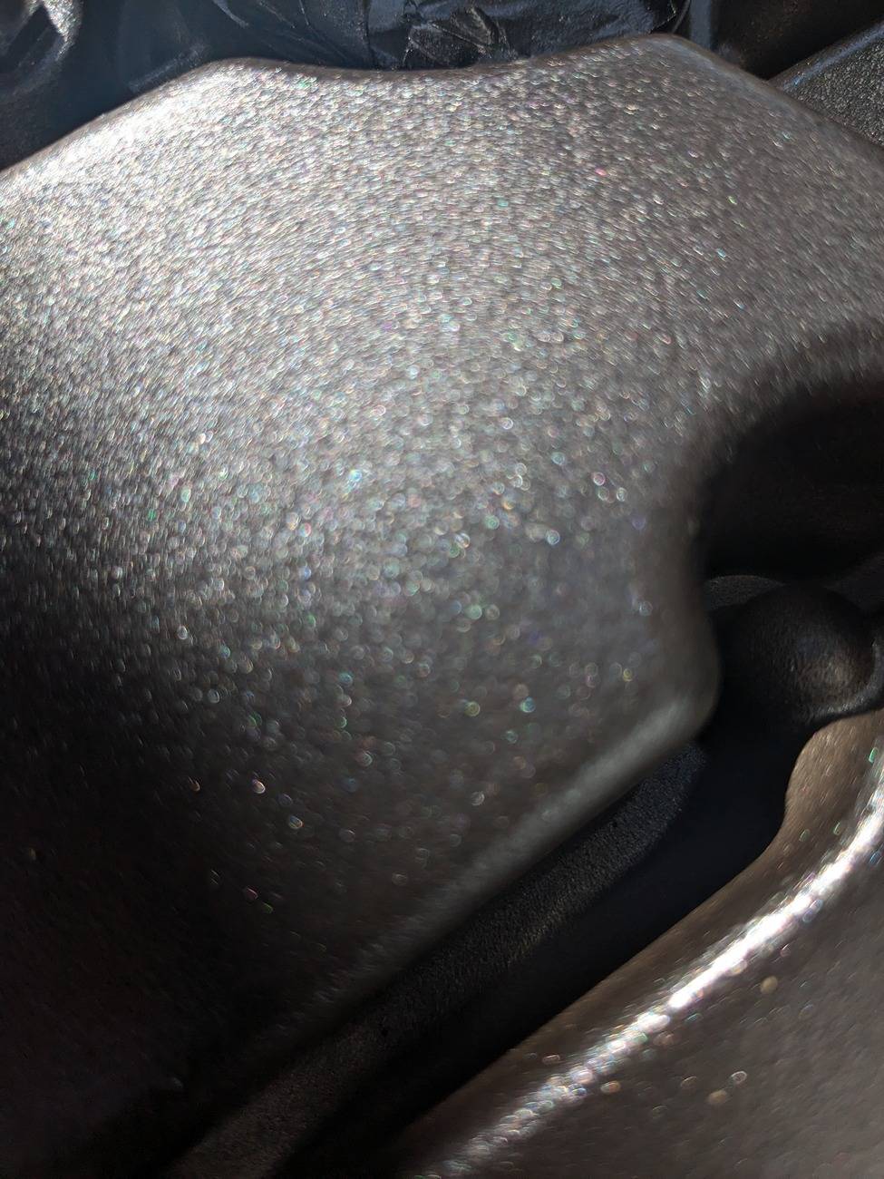

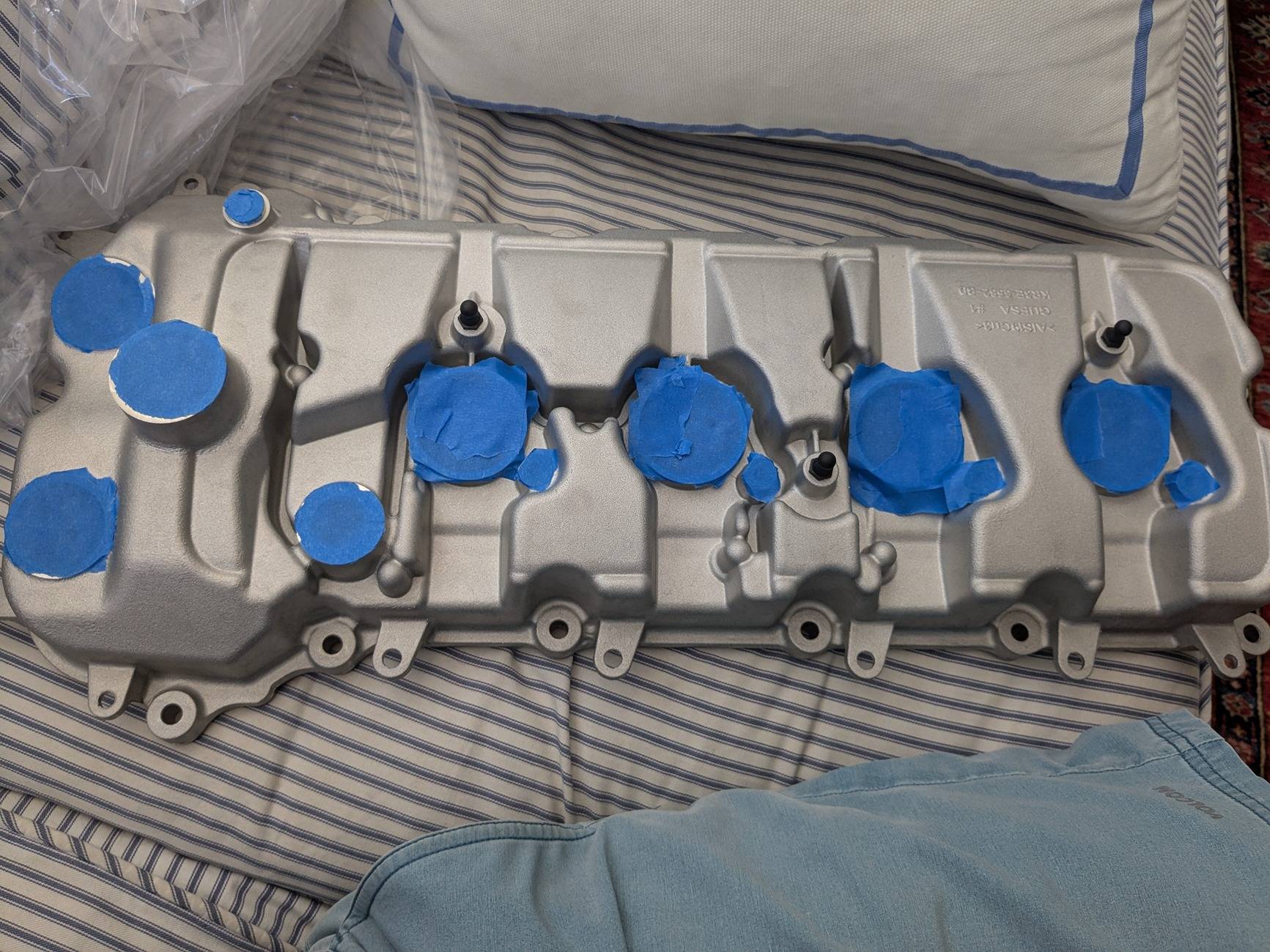

Mine still uninstalled from Christmas, prepping to paint today. Going to be sparkly black metallic
Now painted. Hard to photograph the metallic sparkle unless the camera is right on the part. Looks great in person!

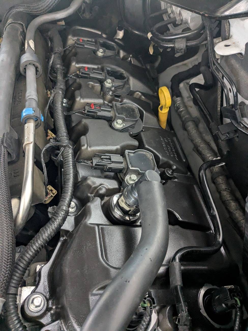

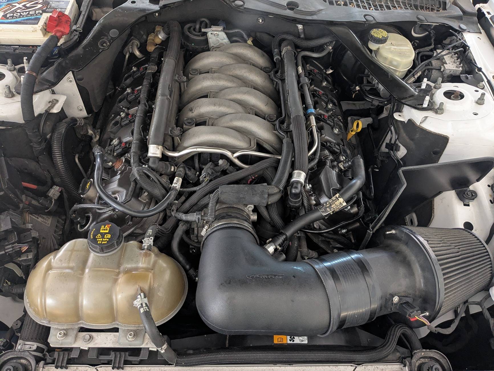

I started taking the engine down and got stuck at the dipstick tube. Took a few hours to do something else going to retry this evening
Did you get the dipstick tube issue resolved?

I did get it out, it took a few tries because I couldn't see the detent at all. I'm almost done maybe tonight or tomorrow.

Good to hear. I used a 3/8 bolt as the head fit the oil tube recess and made it easy to turn to remove and install.

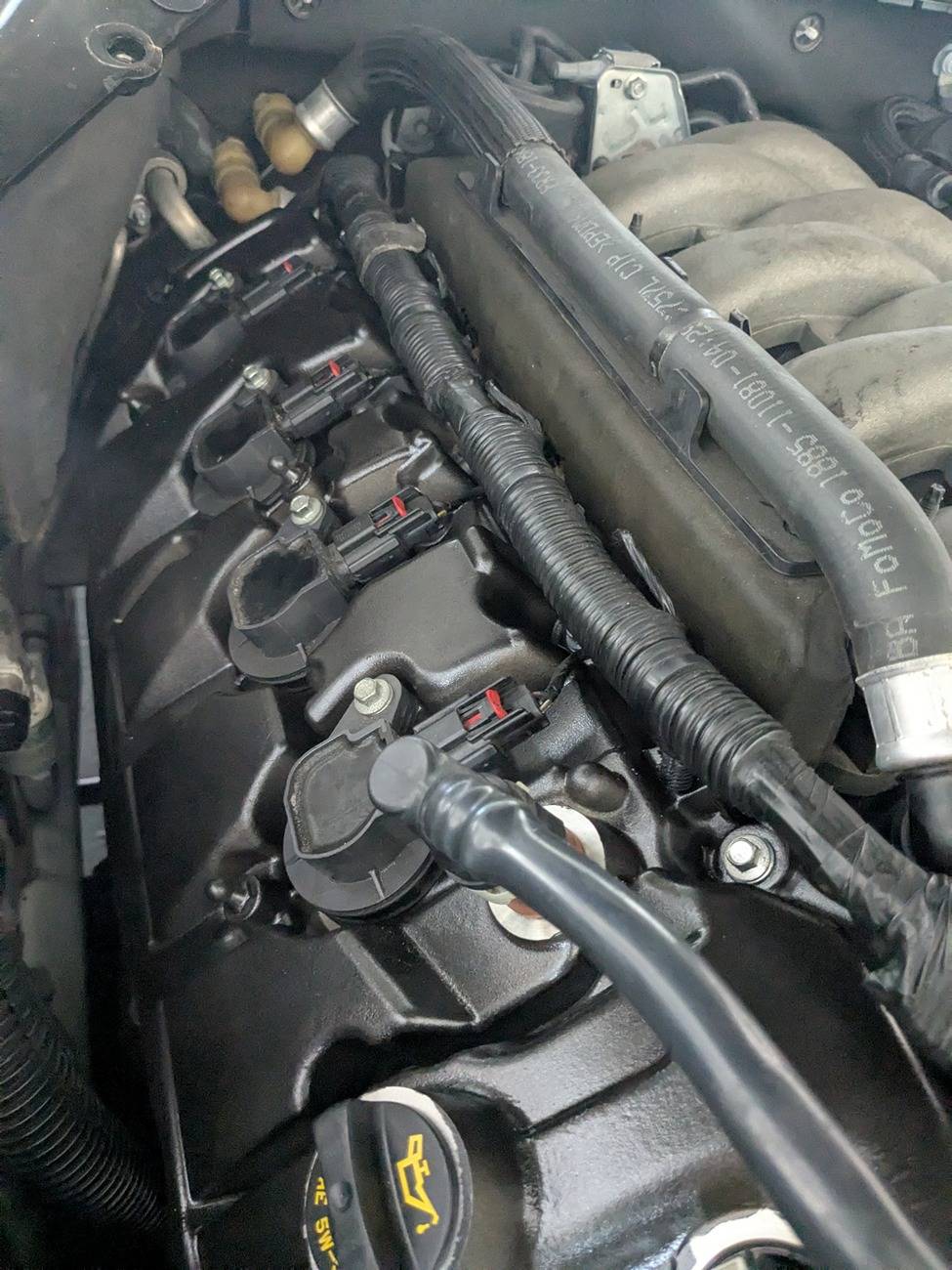

Pretty much done she starts and runs with no errors. I actually said a prayer before starting the engine - no confidence in my work.
Going to scrub the plastic coil covers and engine cover and possibly paint them too. Definitely want to touch up paint around the hoses when I get a chance.
